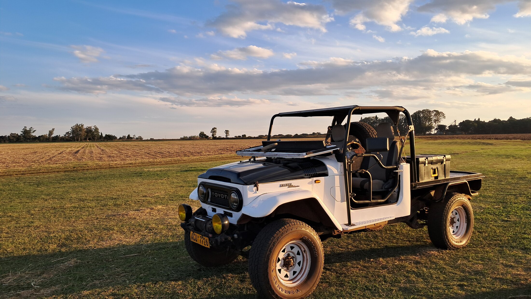

Here's a Pic of my rig, just to get your attention :p

It's how she's sitting now. Winter is just about here, and that means the dry season is upon us. So for now, it's tube doors and bikini top.
But I'm planning a major overhaul on the drive train and suspension later this winter, so it would be a good time to takle the wind noise.
I like to plan ahead.
