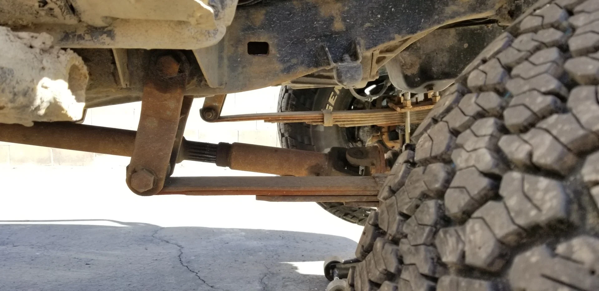

The fronts are well used. Not sure if theyre considered wore out. They do ride nice but kinda look flat and wavy. When hanging free they look like they have nice free arch. Thinking about adding a couple leafs and a half leaf on top. But I wonder if straight up new leafs are in order.
Those fronts are clapped dude. I would also go to a bit shorter shackle.

Yeah they do look pretty borderline on the shackle side of the spring. Im sure bumpstops wouldnt have hurt when the previous owner installed them, lol
What would a shorter shackle do?

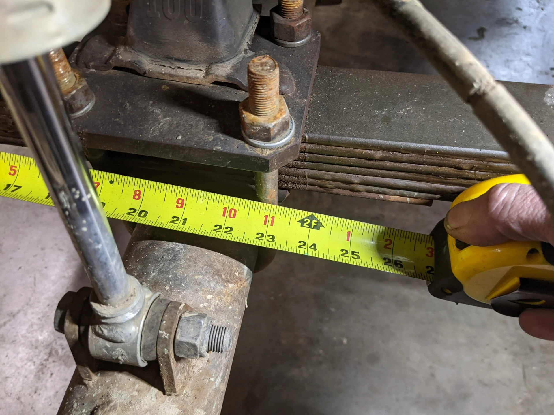

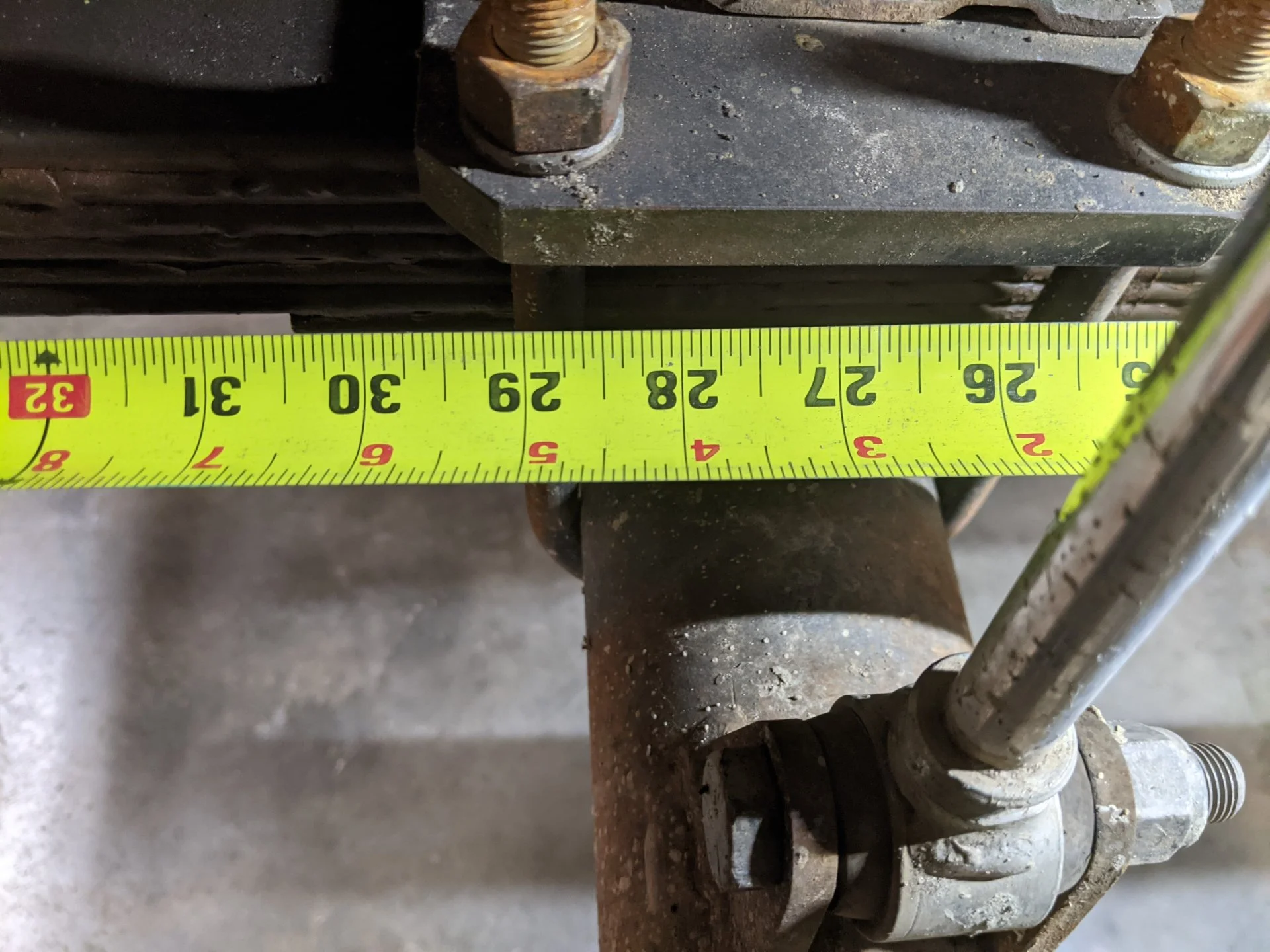

What is the stock distance between frame shackle mount and front hanger mount supposed to be on factory solid axle trucks? Id like to verify if the front hanger is moved forward from stock or not.

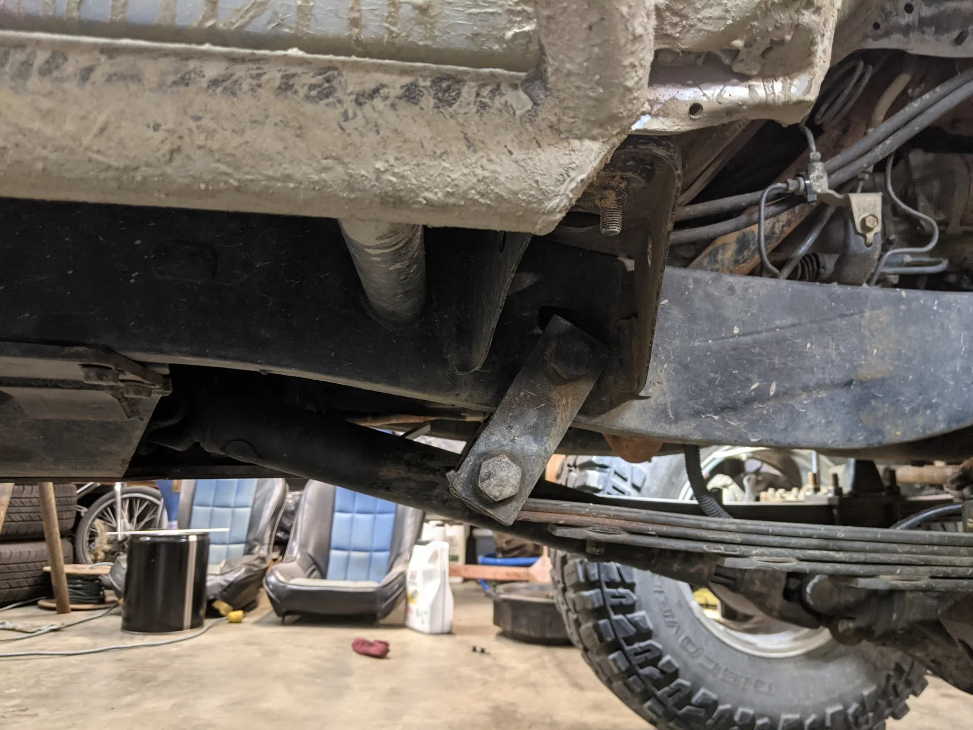

Just pulled a tape, mine is 45" center to center frame shackle point to hanger. Its an '85 frame with an aftermarket front hangar.
Thanks for the specs.

Ill get some real measurements tomorrow but they are very close to RUF. Roughly 20.5-21 and 27-28.
When I mounted these i noticed they are slightly longer.

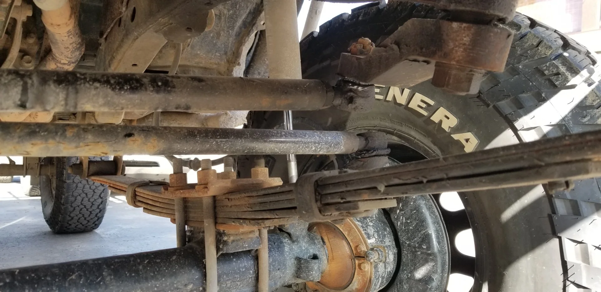

I finally made up a set of 63" Chevy rear springs we talked about in another thread. Great ride and very flexy off road. I got axle wrap so I made the anti wrap bar. It works well and seems to make the rear really hook up. I wasn't willing to give up my ride and flex by adding leaves to try to minimize the axle wrap. I also think the axle wrap/wheel hop was what was tearing out my T-case mounts.

@aztoyman I am trying to correct front and rear...but front is worse for sure. I was reading about potential binding issues with a triangulated anti wrap bar potentially ruining leaf springs. Does the bar stay out of bind at compression and droop?
@gnob thanks for the measurments. I like that shackle angle...how long is the shackle? How much drop on the front hanger? The 3rd leaf in that pack looks like it supports the top 2 leafs quite well. If I was going to add a leaf to mine thats where I would start. I definitely think it should of had that there stock...might have supported the back half of the pack better throughout its life.

I don't have any binding. I have the front of the bar attached to a small shackle with a stout rod end from Ruff Stuff. The shackle allows it to move fore and aft and the rod end allows rotation.
I was considering fabricating a front anti wrap bar. I looked at a bunch of different types on Pirate and just decided there was too many things in the way up front. I really didn't have a noticeable problem up front either.
My shackle is 4" hole to hole. Imo the shorter shackles add to suspension stability. Poly bushings help.
