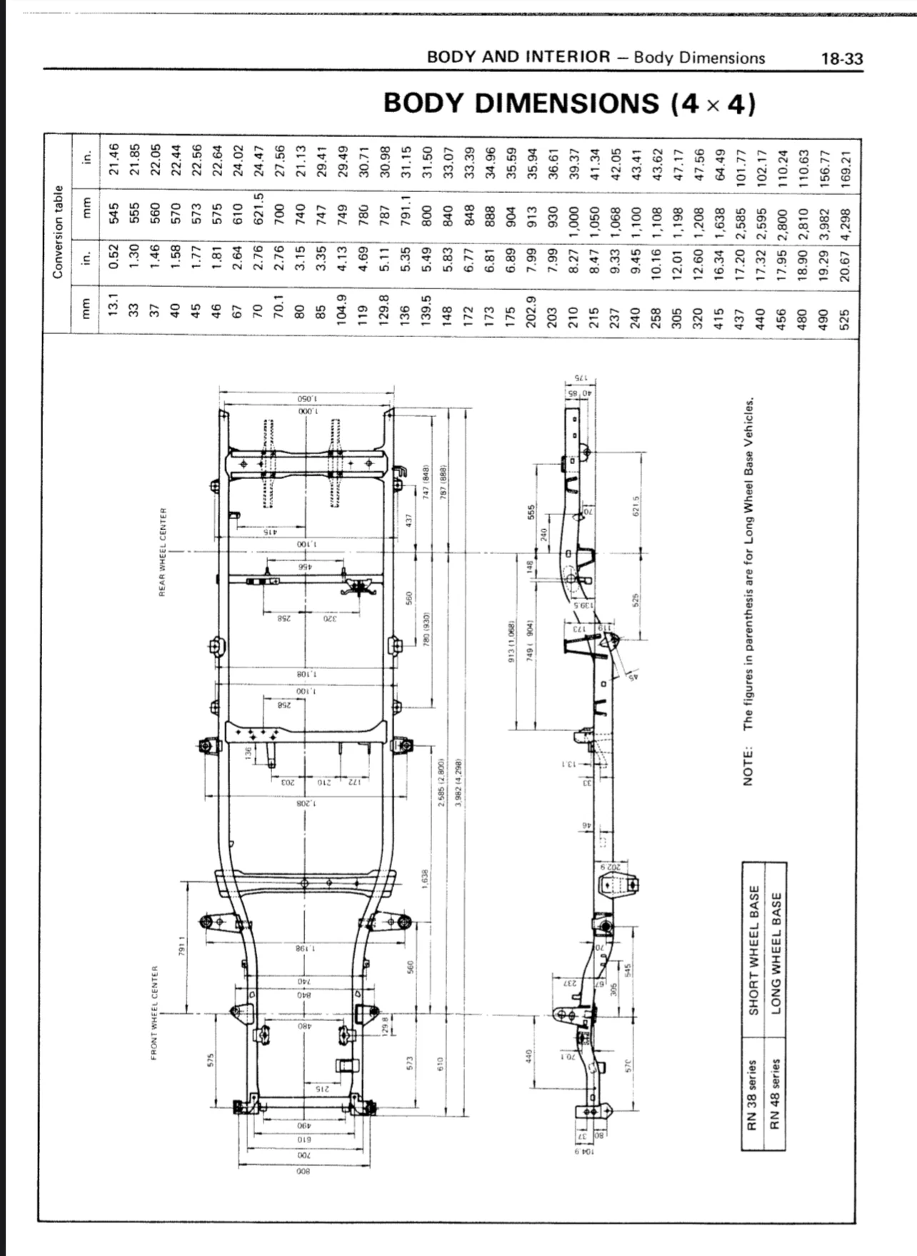

This is for an 1983, but it may be able to help you. 82 and 83 are the same IIRC.
This is the dimension location that I hope to get.

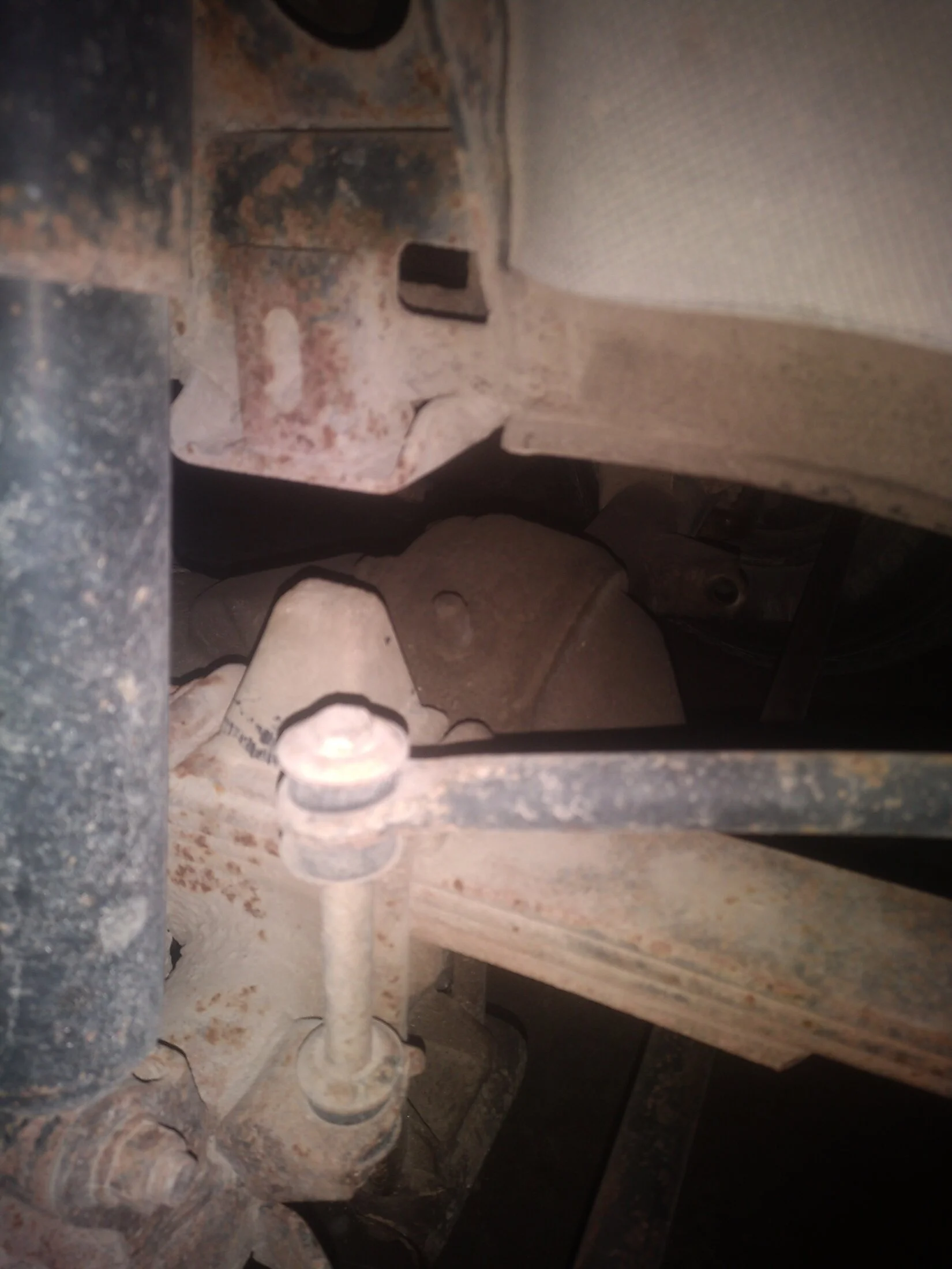

From either top of leaf springs or from top of rubber stopper/limiter up to frame. Front axle.
If someone has recently installed stock springs and would take this measurement this would allow me to calculate height using 3"lift leaf springs but SUA.
