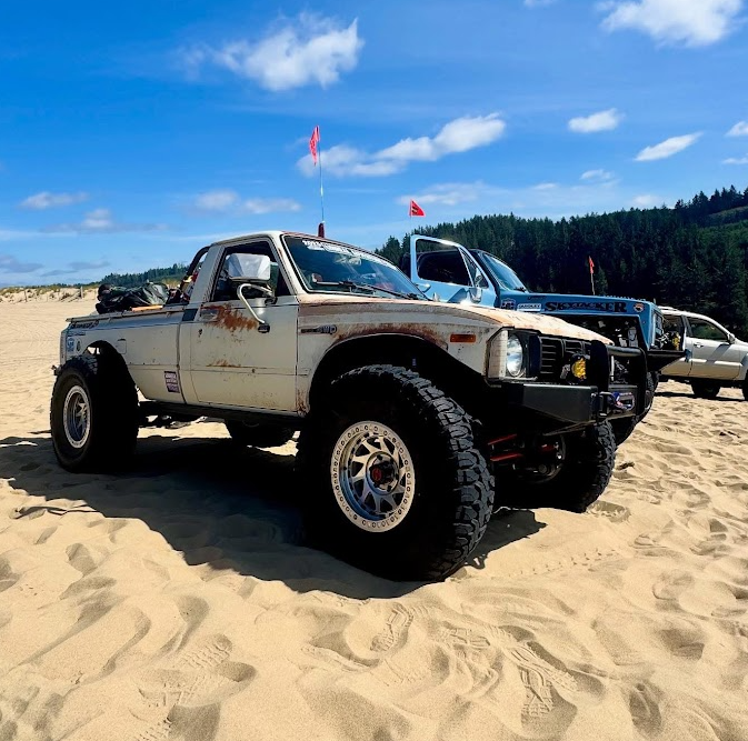

Day 1: Coos Bay, Oregon. Coos Bay is right on the coast of oregon and offers some of the best sand dune riding in the country. We dont have anything close in TX so bombing up and down the dunes was so much fun. 3" or so and leaf springs wasnt the best, but not too bad. I was hitting limiter all day long until the thermostat stuck and blew the head gasket. It was a bummer as i didnt get to see the other dunes in the afternoon of Day 1, but we limped it to the hotel for that night and got to work. At the recommendation of Dirthead Dave Chappelle, i tried a can of Blue Devil head gasket in a can. I followed the instructions to a T and to my surprise it "fixed" it enough to finish the week without any additional overheating. I did buy a head gasket just in case i needed to pull the head.
I got to put my feet in the cold Pacific Ocean.
Drag raced dave in the slowest drag race of all time. I spun hard off the line but pulled around him in the big end. This in no way contributed to my HG issue.

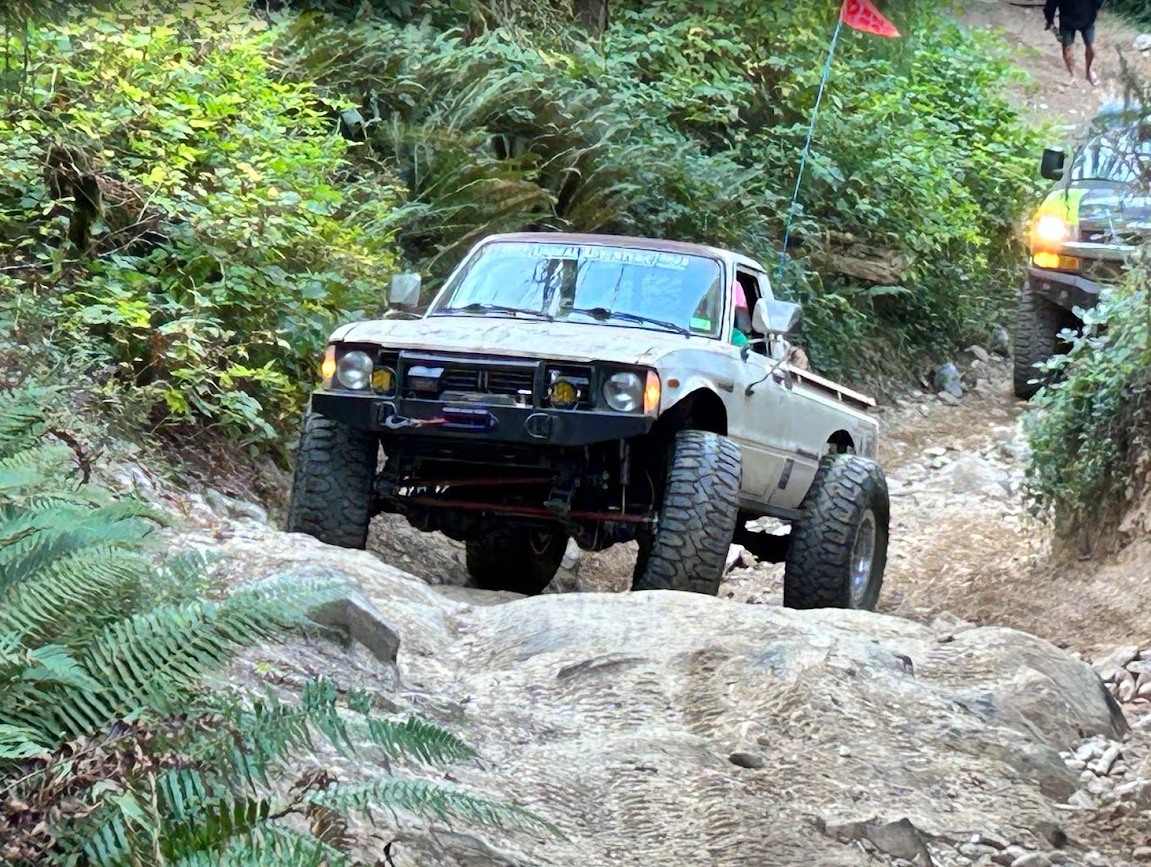

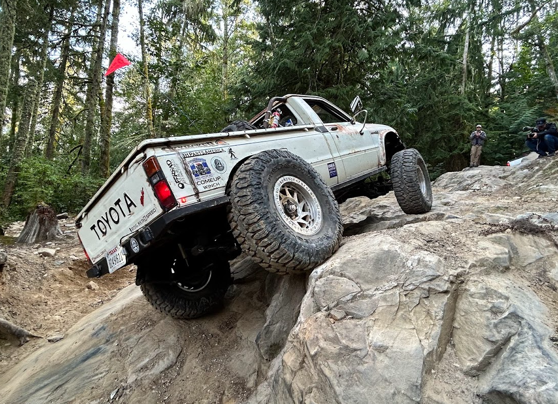

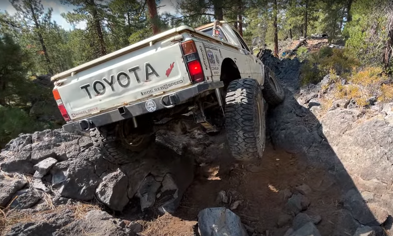

We then made the way up to Browns Camp and hit the Crushers trail. This is where i found a few more issues with the truck. First, the e-locker actuator s*** the bed and wouldnt switch it into 4wd. Brand new Aisin unit. Dead. So I pulled it and engaged 4wd with a large screwdriver. We had locking hubs so i just left it engaged for the rest of the week. Once i got it in 4wd, i noticed my second problem. I could barely steer. The PSC pump (also new) took a s*** and would whine like a banshee when trying to steer under a load. On the road, it was perfectly fine. To help with this, my co-driver would get out and unlock the passenger hub and we 3-wheeled it until we hit some hard stuff. This helped with the turning but the problem would get worse throughout the week.
Once we got to eh crushers trail, the truck did great. Put it in low/low and just putted my way through all the obstacles. The tires actually did pretty good the entire trip. Super happy with them. I did find out i needed more trimming up front, but it self-clearanced.

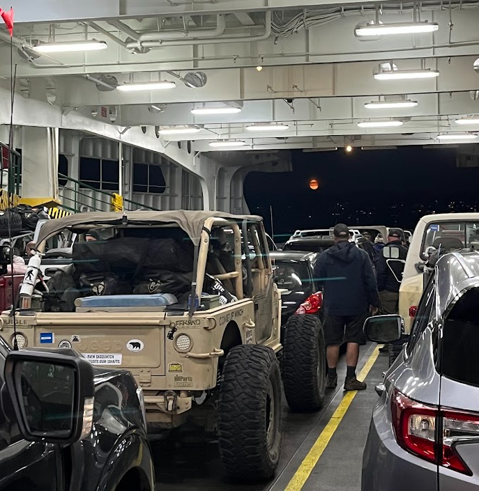

Going over this bridge, i noticed something didnt sound right. The exhaust was super loud and the floor was getting hot. Pulled over and found a broken v-band clamp. Also new. You can see a theme here. I broke so much new s***, it was laughable at this point. Knowing i wouldnt be able to find a 3" V-Band anywhere, i cut up a toyota wire hose clamp and tied the exhaust back together for the rest of the week. Had a slight leak at the v-band, but so much better.
The group took a Ferry ride to end the day before making it to the hotel that night.

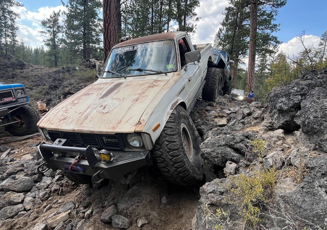

Last and final day of UA 2025. Day 7: Rim Butte back in Oregon. We were guided this day with a fellow irate member and a member of the Sketchy Oregon boys Tydes. Graham showed around the trails up there. This was one of my favorite days of UA. Super technical crawling over some lava rocks with insane traction.
In the parking lot next to James 4-door tacoma. James was a UA participant in 2021 and was our trail leader for Browns Camp on Day 2. He wheeled with the group the final day as well.

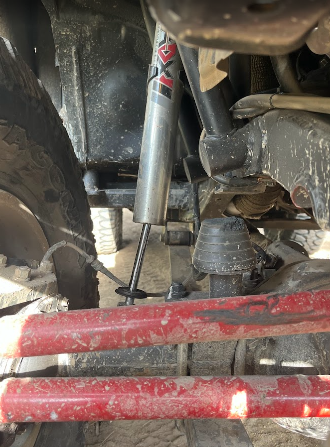

Ended up getting a rock tuck between the tire and shock and bend the shaft. Drove it that way for a couple hundred miles. Skyjacker was awesome enough to send me a replacement.

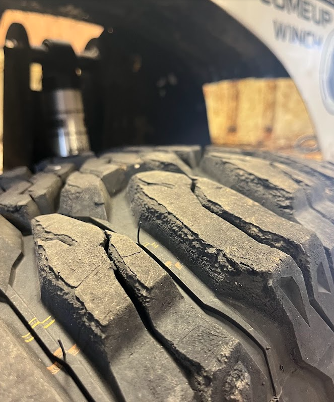

Milestar was the tire sponsor this year and gifted us with a free set of 5 tires. I aired them down to 6psi on the trails and they stuck to everything and by the end really feathered out nicely for stickies. On the road they were smooth and ran true without any balancing and at 83 mph max speed. I would definitely buy a set in the future. Their price is really hard to beat.

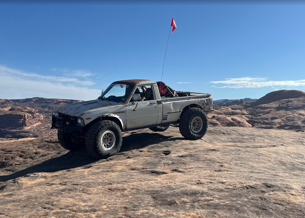

Bonus wheeling. We stopped in Moab for the first night on our return trip and figured when in rome, do some more wheeling. We hit Hells Revenge in the morning and knocked off another bucket list trail.
Hells Gate
Escalator
