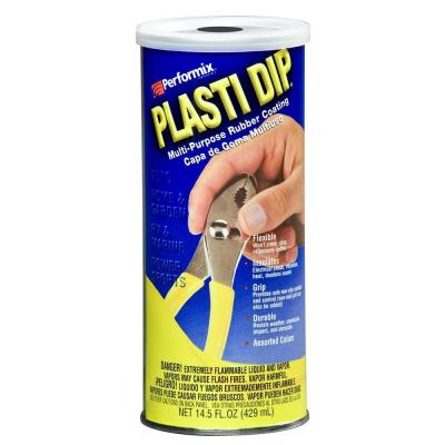

This is great! I've looked into doing the same thing on my FJ40 dizzy advance. I've read a couple people dipping the diaphragm in plasti dip to reuse the old one with good results. I think one of the write ups was in the 40's forum. Haven't done it myself, but considering it unless a find a working one/better solution.
Sweet guys, thank you! The guy above in the video did speak about coating the diaphram w/ silicone so the plasti dip is probably the same idea. Thanks for the link!

A guy in the 40 section did it w/ plasti dip. Other than that I don't know about its ability to withstand all those conditions. New after market vac adv is $140. Rebuild w/ diz via rockauto who sends it to A1-Carbone is over $170 now.

And Plastidip is supposed to be very durable - many youtube vids on how durable. People spray their truck hoods with it to prevent rock chips.
I just read that plasti dip can go to 200 degrees. What's the thoughts on how warm that area of the distributor might get?

Yeah, the ambient temp in the engine compartment is going to be around 200*F but probably less when moving. Anyone's guess on the long-term durability of the dip when exposed to heat... There may be a better product for the application and maybe the NJ fellow will share his secrets....
