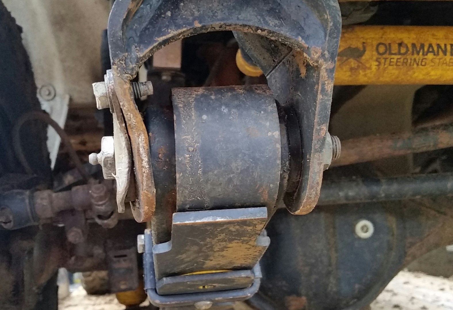

I hit the pass. side shackle reversal bracket at some point Had no idea until I rinsed some of the mud off last night:
