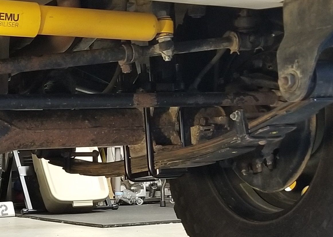

I forgot to post my last couple pics after finishing the install...
Here's what the front looks like, done:
And a comparison ------>
Before: (pic stolen from the SOR website, I forgot to take one)
After:
So while it's "only 3/4 of an inch" more ground clearance...the overall increase in clearance is HUGE.
The stock plates stick out from the sides of the leaf springs over an inch, on top of the shock hanging way down. The new plates are no wider than the leafspring!
I'm really pleased, and I hope I'll get hung up on less rocks in the future...
- Brian
