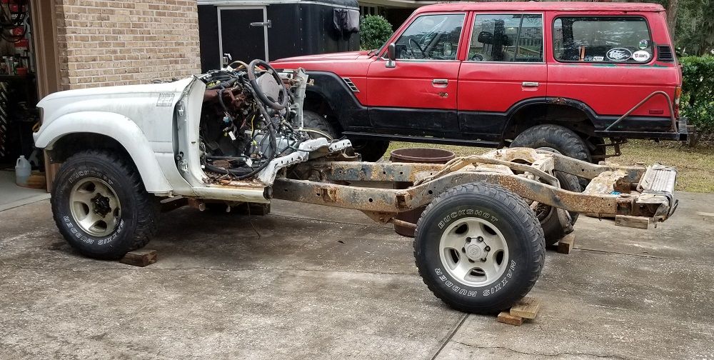

I also bought an 80-series roller, cut most the body off...and I'm thinking I'll put this 60 body on it. Maybe.
I'm honestly 50/50 on swapping the chassis (or welding all the 80-series suspension onto my 60 frame and retianing the front 9.5" axle)...but I like wheeling it on leafs. However, links and coils are cool, too.

Oh yeah...almost forgot...

That frame rust looks pretty buggered to my sensitive California eyes.
That’s fine for east coast beach rig.. it’ll
Sandblast fine
It's a little muddy, so it looks worse in pictures than it is...but it's rusty, too. Surface rust from salt air and beach cruisin'. No "rot", nothing too crusty.
Like Matt said...nothing a little scuffing or sandblasting won't take care of!

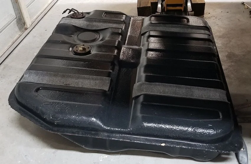

So, got the tank out on Saturday afternoon and washed the exterior (lots of mud and dirt collects up there!) -->

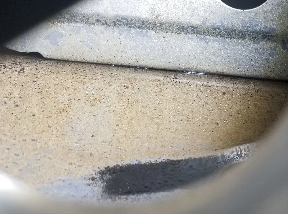

Looking in through the fill hole, expecting to find a rusty mess...and all I can see is clean metal and a pile of that black crap that's clogging everything:
So, now my line of thought is "let's just clean it all out", rather than "3 gal of Evaporust is gonna be like $100"...hehe.

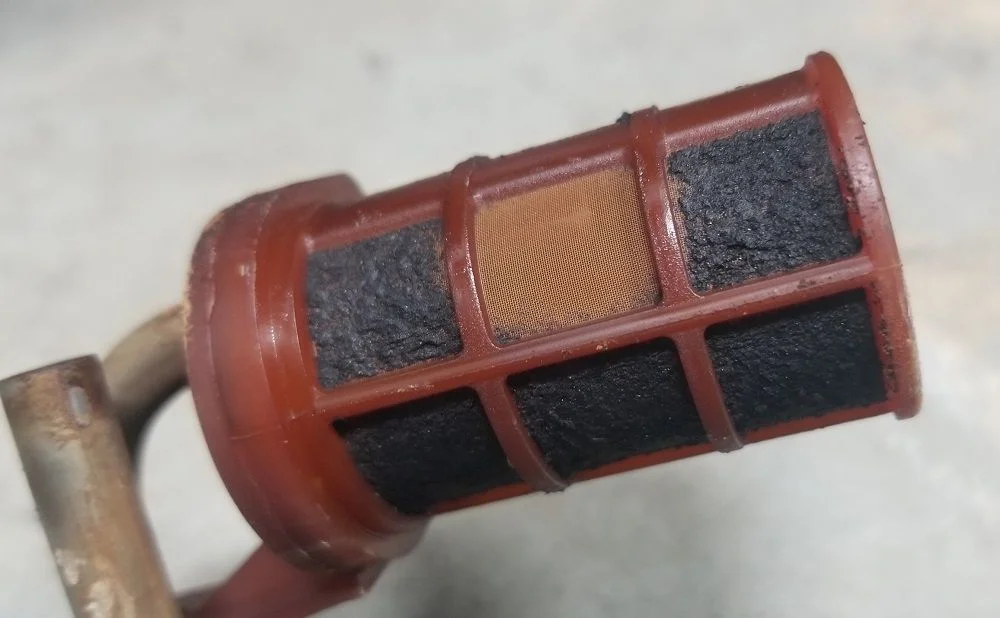

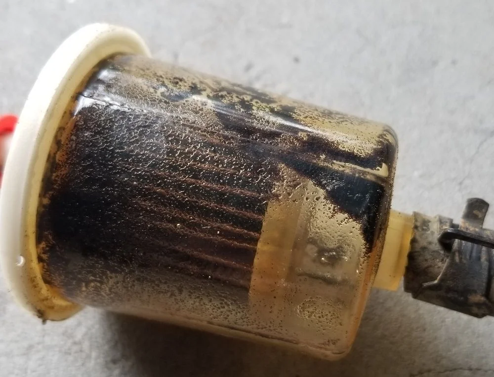

BUT, the filter or "strainer" on the end of the feed line was real clogged:
^^^ The clean section there was just brushed off with an old toothbrush.
You can see why maybe I was having a lean condition under heavy load!

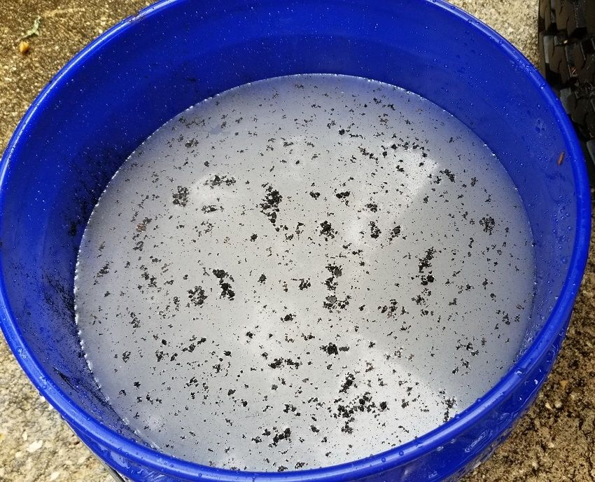

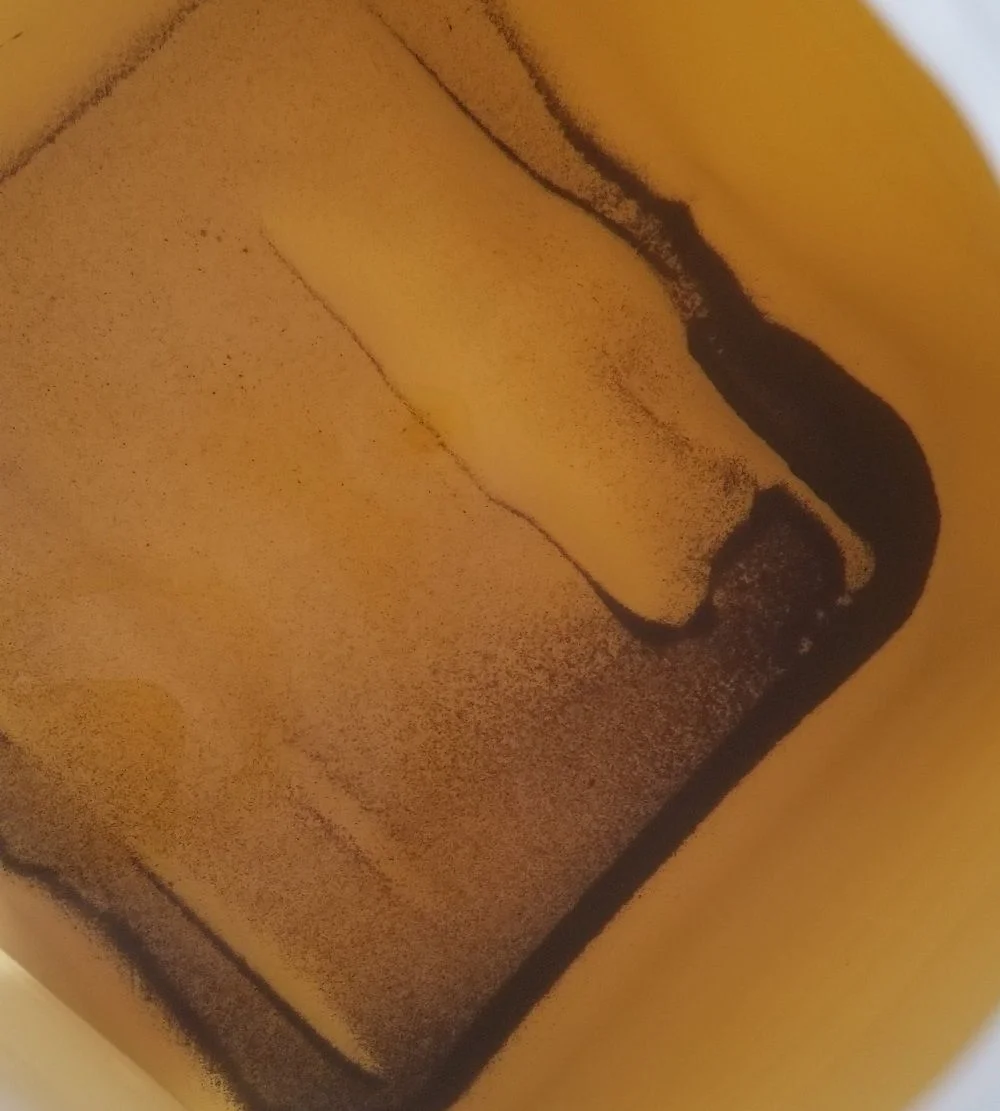

I caught some of what came out in a bucket, to see if I could figure anything out. Here's what I got:
Strangely, that black stuff from the bottom of the tank floats on water (???). Sinks in fuel, but floats on water. Weird.
Think it has to be rubber or plastic - I figure a fuel line dissolved internally a few years back, OR, more likely...I filled up with gas somewhere that had an old s***ty rubber line leading to the gas pump / handle.

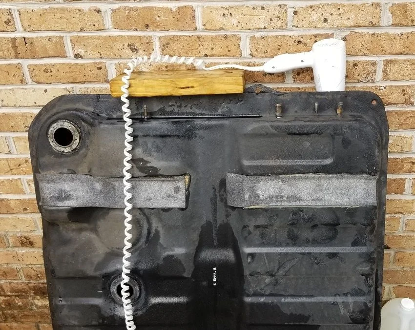

Then I rinsed one last time, and used to old hair dryer to start drying out the inside of the tank -->
Set it on there (blowing into the fill hole), turned it on, let it run for 20minutes. Seemed to work really well, there was a nice flow of hot air coming out the sender and fuel pickup holes.
That's where I am today. Tank is sitting out back in the sun, drying out completely.

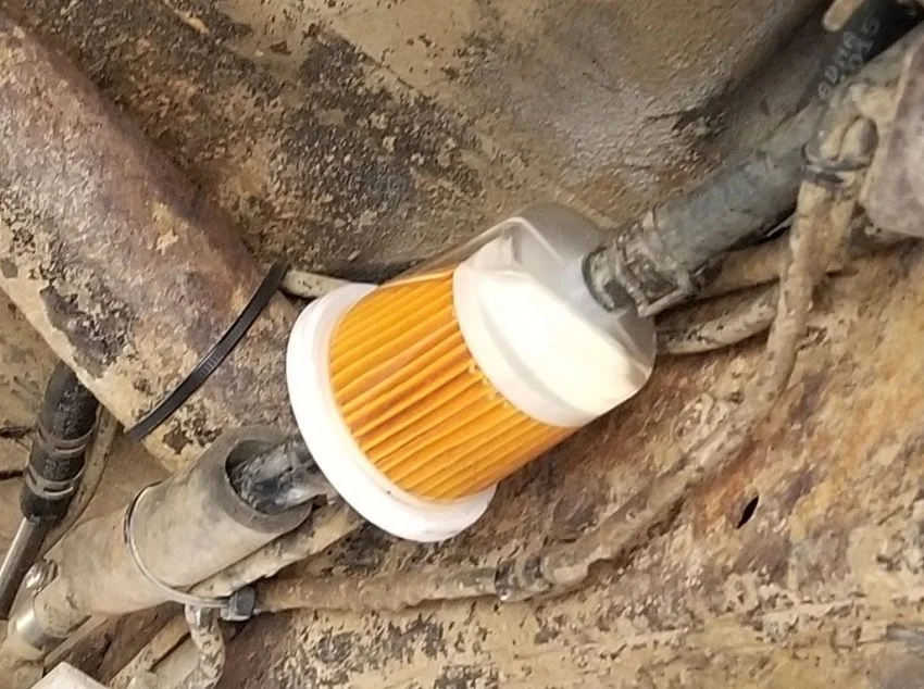

Got the tank back in earlier this week, added 15gal of non-ethanol gas, and then put a good 40 miles on the truck yesterday...
...and the fuel pump pre-filter still looks new -->
(sorry for the sh!tty pic, had to zoom and crop)
Previously, the filter media would already be turning a darker color, and there would be visible debris in there.
I think this particular problem is solved.

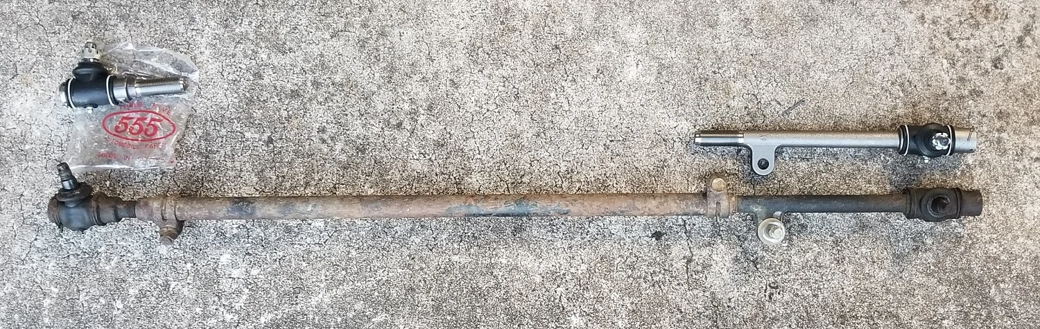

I had a hint of "death wobble" when driving it a few weeks ago, and recalled that I bought a set of 'Three Five' replacement ends a few years ago, but only installed the TRE. Can't recall why.
So I grabbed the other 2 ends off the shelf and swapped them on -->
That should help.

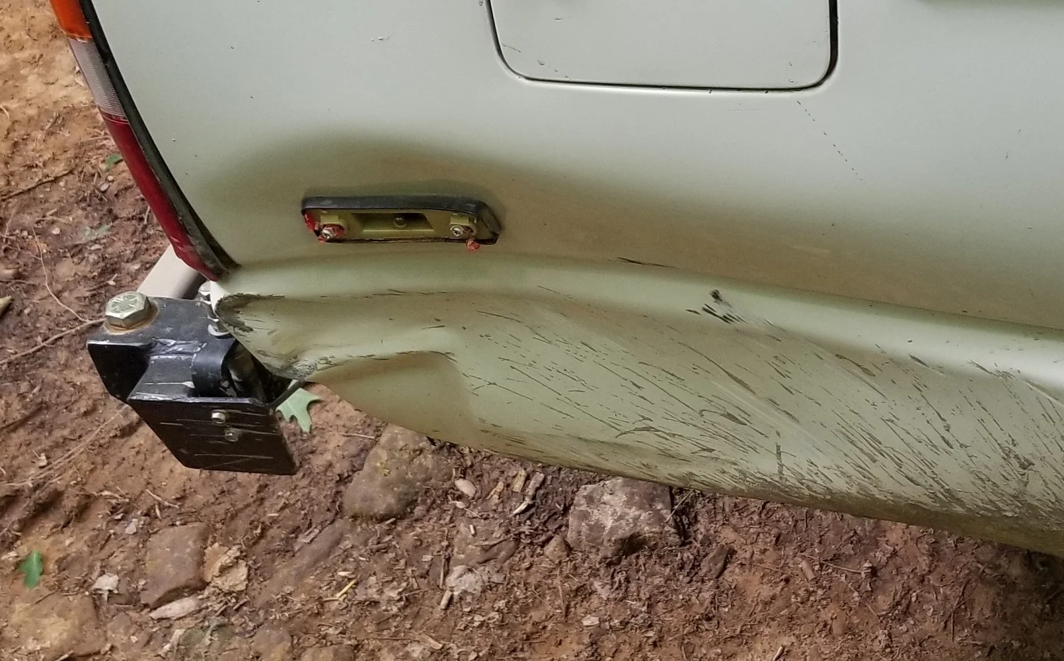

However, the black trails at Windrock demand a toll, and it was my turn to pay. I've tried real hard to wheel this truck without sheetmetal damage, but my time was up.
Twice. The bottom, larger dent was early in the day...and the higher up hit got the tail light lens (admittedly because I wasn't being cautious - I figured "it's dented already").
Sigh.

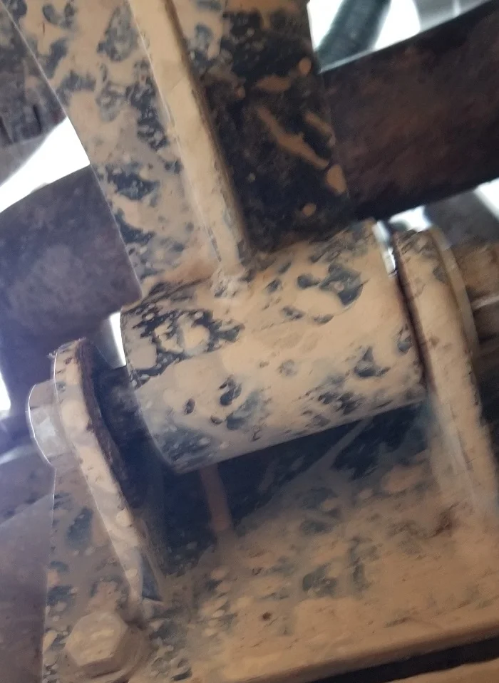

I started to hear a clunk, and noticed my shifter was moving a LOT more than it should. So I took it easy until the Panther Rock overlook area, and checked my motor mounts.
The poly bushings were *gone*, on both sides. I guess exhaust heat + a rough trail earlier in the day just turned them into dust, and I was now riding metal on metal -->
(hard to tell here, but you can see it's not "right")
^^^ Pic is sideways...but you can see there's no bushing left.
