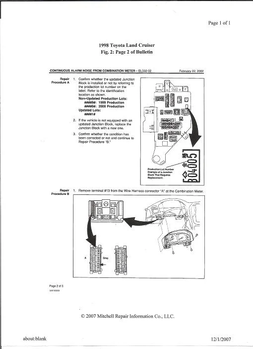

Here is info from the Euro version of the TSB, valid for model code UZJ100 and HDJ100:
VIN:
− JTEHT05J902008688
− JTEHC05J604003341
Production Date:
January, 1998 to January, 2001
Repair Procedure:
Repair Procedure A & B
VIN:
JTEHT05J002008689 − JTEHT05J802025271
JTEHC05J804003342 − JTEHC05J604011308
Production Date:
February, 2001 to April, 2002
Repair Procedure:
Repair Procedure B
Proc.A is to change the LH cowl side junction block to an updated version. This might have been done earlier, e.g. by dealer/importer.
Proc.B is to remove & insulate terminal #13 from the wire harness connector C15 at the combination meter, and,
to remove & insulate terminal #11 from the wire harness connector 2P at the junction block LH cowl side.
To find out if the cowl side junction block is in need of changing, look at the 6 digit lot #, digit 2 from the right (2nd last). This indicates production year. 8, 9 or 0 means replace, 1 is OK. (This is for vehicles produced up to April 2002, so higher ## (years) are not mentioned).

Based on the TSB if I had the problem I'd start with procedure B (clip two wires) and see if it worked before paying for procedure A.

I thought I would update this with some scanned pics of the TSB for you Do it Yourselfers.
Time to go play, great to have the photo. Mine did this a year ago and never again, today it did it while I was driving - BIG HEADACHE BUMMER
Does anyone have any photos or description of how difficult these wires are to get to? Any help would be appreciated.
