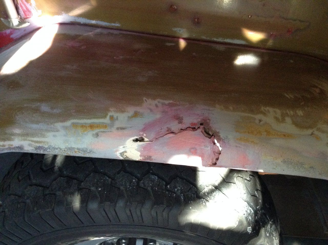

Got antsy on my day off and decided to continue to tidy up the drivers side of my FJ40. I have about three visable areas to continue to address on the DS, the rear sill(yikes), a couple little spots on the rocker panel sandwiched behind the step(want to avoid broken bolts), and finally the middle spot on fender(metal shaping required).

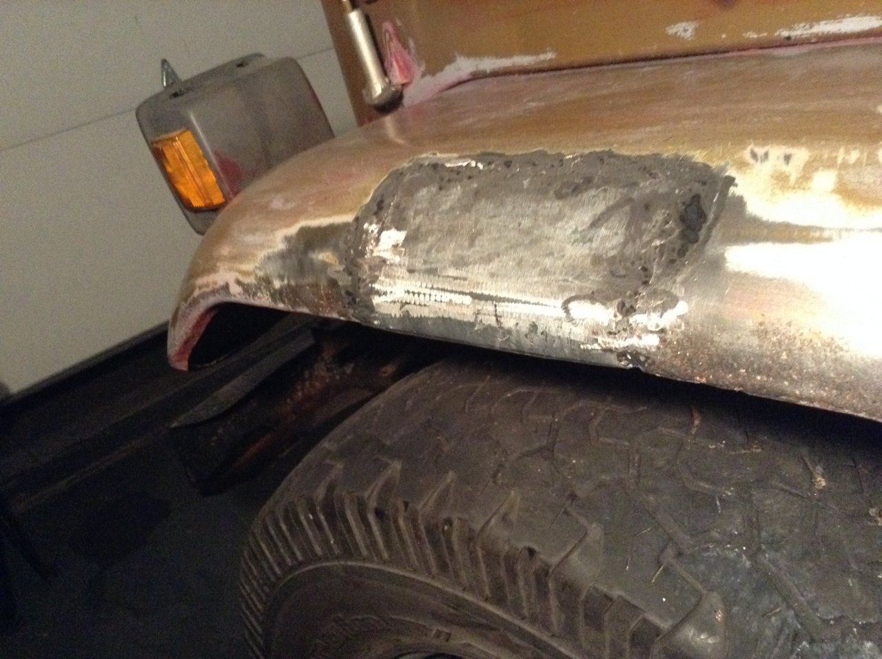

I decided to dive in and address the fender, even though I was not sure how to shape the metal to the tricky body curves.... "It didn't look that bad initially..."
Here's the "before"... Trust me it was way worse once I started digging... Like usual the PO thought of bondo more of an adhesive than a filler... Chunks of stuff hidden and not much metal
Here's the "after" shot of current state (not finished but good for now)... The contour isn't perfect but I'm hoping some bondo and sanding will do the trick

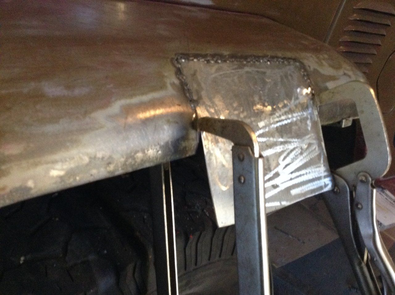

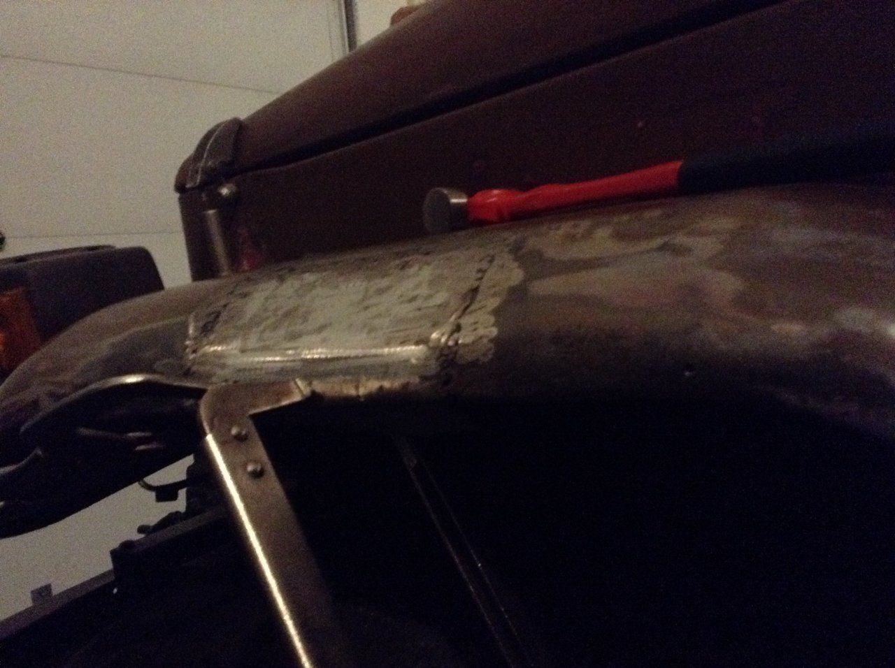

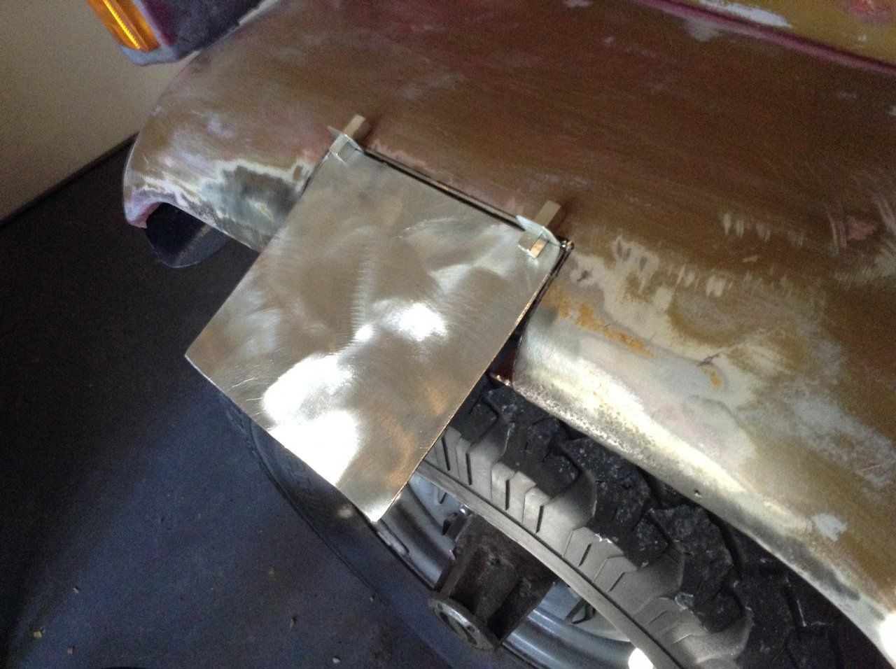

Here's some "in process" shots... Basically secured the top with some tacks. Then little by little bent the metal and did series of tacks every 1/4 inch after resecuring/bending.
The hardest part was bending in the lip... Poor planning on my part... When in doubt just bust out a hammer...
Secured it with some clamps for leverage, then put a dolly on the backside and just went to town getting my monthly stress relief...
