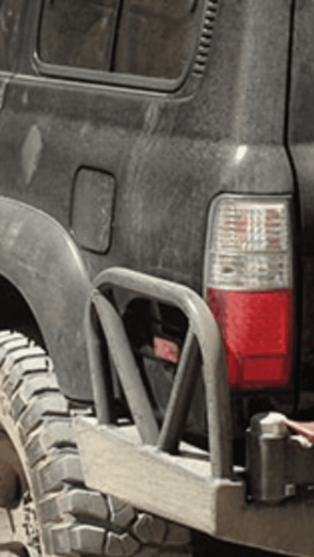

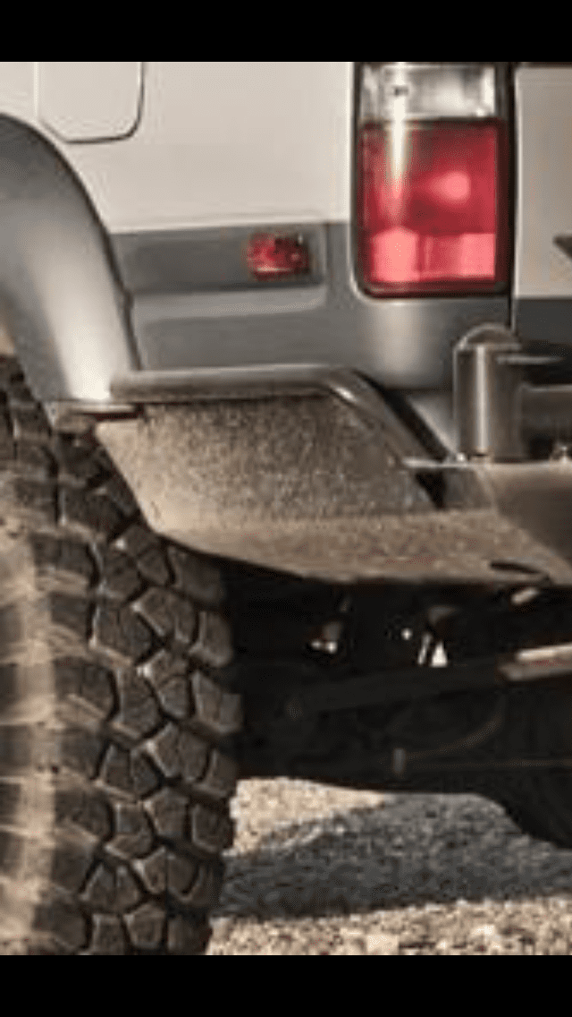

Some advise. Please look at the pictures above. I have the 4x4 labs rear bumper (top picture) which has what I believe is a 1 inch tube that protects the rear quarter panel. I would like to add more protection like (bottom picture).
So when adding more protection should I go with the same diameter tubing? Or larger diameter?
I figure that anything I add at this point would only be an added bonus to protect the quarter panels a little better.
From what I have read, the rubicon trail tends to bend 80series quarter panels. This is my effort to prevent that.
Anybody in the club own a bender that could help me out with the bends? Or know of a shop that could do the bends for me if I brought them the material and the measurements?
View attachment 1620306 View attachment 1620307

I'd use the same diameter for aesthetics, nothing else. Remember that as you extend those bars up, they will flex more into the quarter panel. The 4x4 labs wings aren't boxed like that other example, so they won't be as rigid either.
I have a bender you're free to use if you buy the die for the tubing you want. I only have 1.75 and 1.5" dies.
Agree. Going up is tough. Ive considered it. If i did I would follow user member scrowley lead and go forward over wheel well and tie into slider. Steel a lil idea here and there and you may tie into bolts inside tailight housing to tailgate gap.
Before all that mad maxness id probably just do a bump out on the side extending parallel to ground. 10% of the tubing cost/weight/fab needs. Pushes you out and away instead so not a garuntee but worth the trade off to ME and it serves as a step when needed.

I found this one online. But honestly it is a little too much for my taste. I like your idea though. A bump out would be a lot less “jungle gym” looking.

I thought about doing the same thing. I actually reinforced the wing before installation with two vertical ribs. I thought it was overkill at the time but if I were to install additional bracing, the wing wouldn't flex as much.
