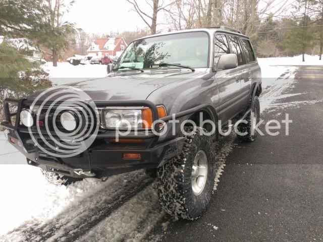

Here is an updated pic. I picked up some 37x12.5x17 BFG Krawler blues on TrailRated Beadlock aluminum. 5.29 gears and Longfield superset is in the mail on its way. But I have to say it's still not that bad on the backroads if you drive it right with the manual shift.
