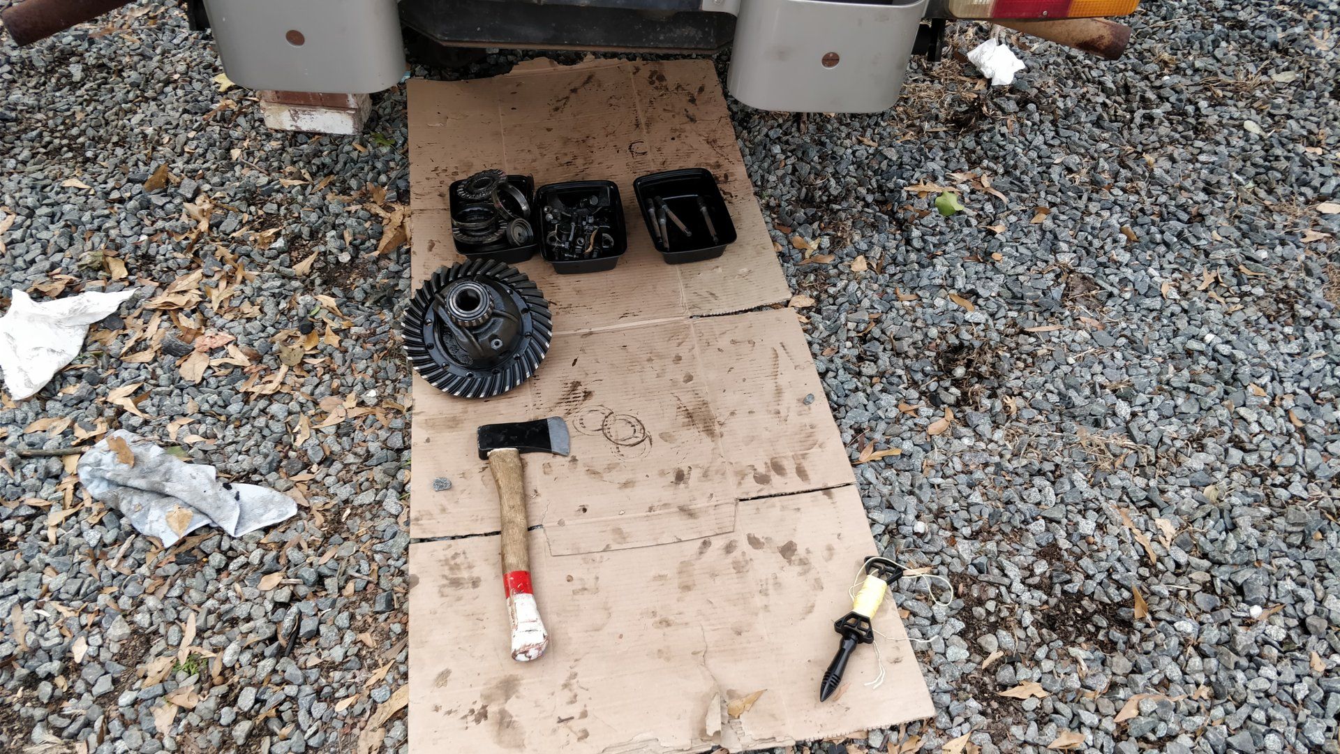

Freaking Aussie locker is a pain in the ass to disassemble.
Yes...it's a freaking pita. If you were able to remove it without screwing the super small springs then next time you'll just already have a spare set of springs ready to replace the ones you plan to rip out. Ask me how I know.

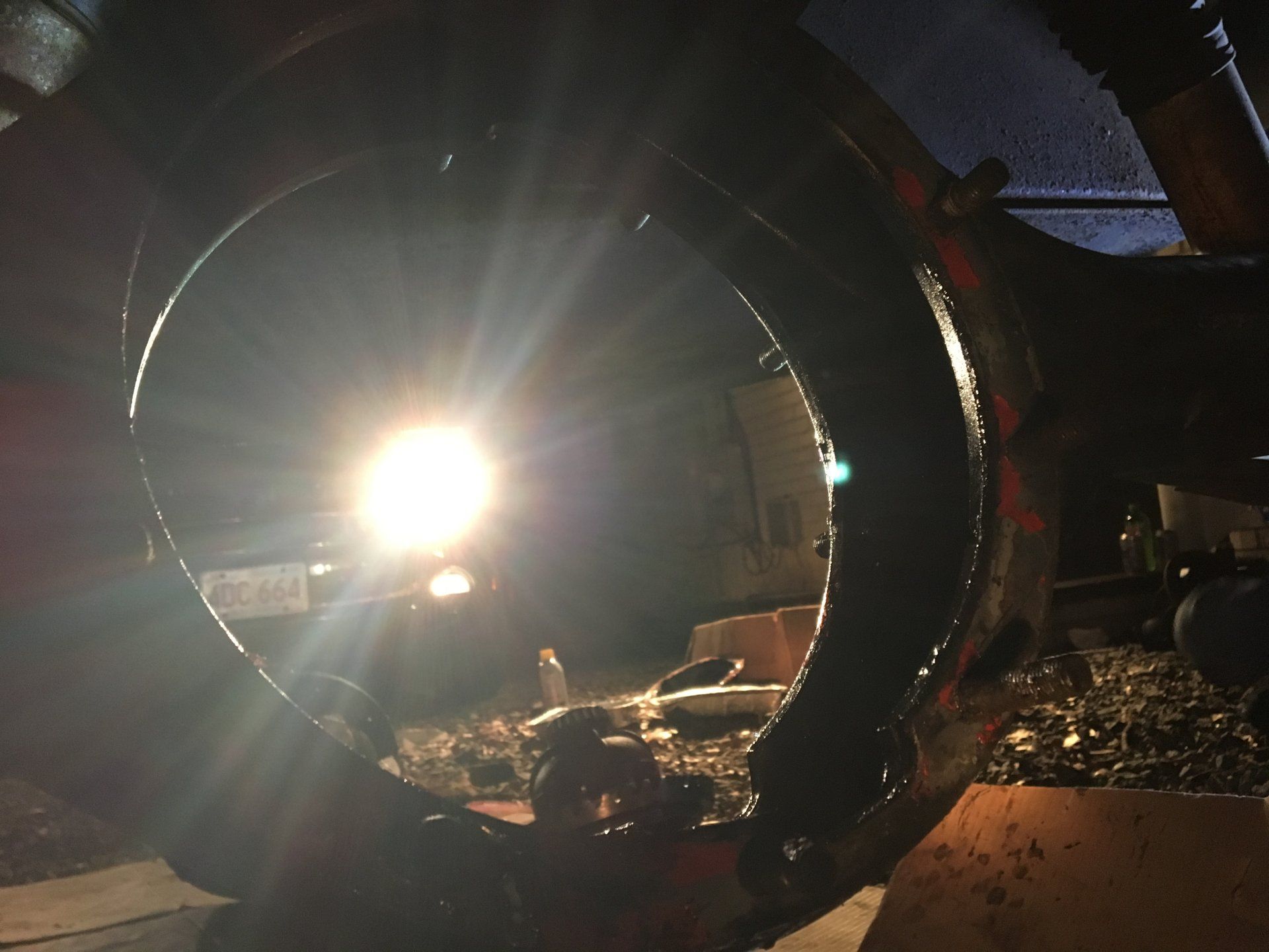

Snapped a picture of the light at the end of the tunnel. Luckily, we managed to squeeze back in the guts before it got too late.

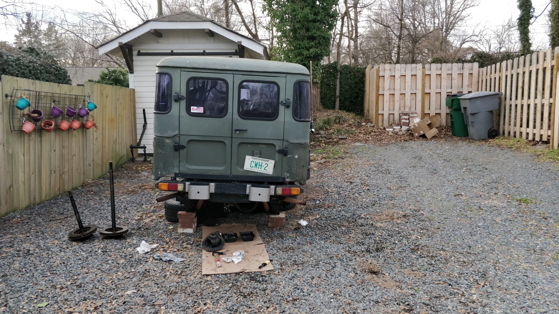

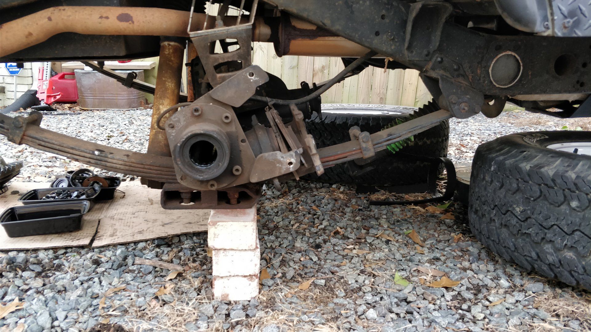

In Scott's defense, the PO installed a locker but didn't tighten the ring bolts. Crazy but some kind of miss during install. All of them were finger tight vs having the needed Loctite and torq. At some point, one of the bolts backed out / sheared, got banged around, and then was punched out the bottom of the inspection cover. Without it punching through the cover, the whole issue would have gone undiagnosed until one day when (likely at high speed) it would have a catastrophic failure and vomit rear end parts everywhere. As others suggested, we pulled it all out- no way to properly tighten, align, torq, etc. The struggle was getting the locker out so we could get to the C clips on the axles. Unlike a stock set up, there is far less room to work with and the locker is held together with 4 pins. Those pins can be moved if you remove these tiny brass pins. Took us forever to figure out the sequence of disassembly. Like playing with a metal, oily Jenga. What took us 2 hours will be about 15 minutes now that we know how that locker goes in & out @Roxx had a bead on a stock rear third member. We pulled it (much easier since stock), it was good and 4:11 gears, so we plugged it into @tgadd truck in the dark. About 7 total hours of running around chasing tools & parts, head scratching, swearing, prayer to all the gods, and getting lucky. Next time can be much quicker since we aren't total noobs anymore. Hoping there isn't a next time.
