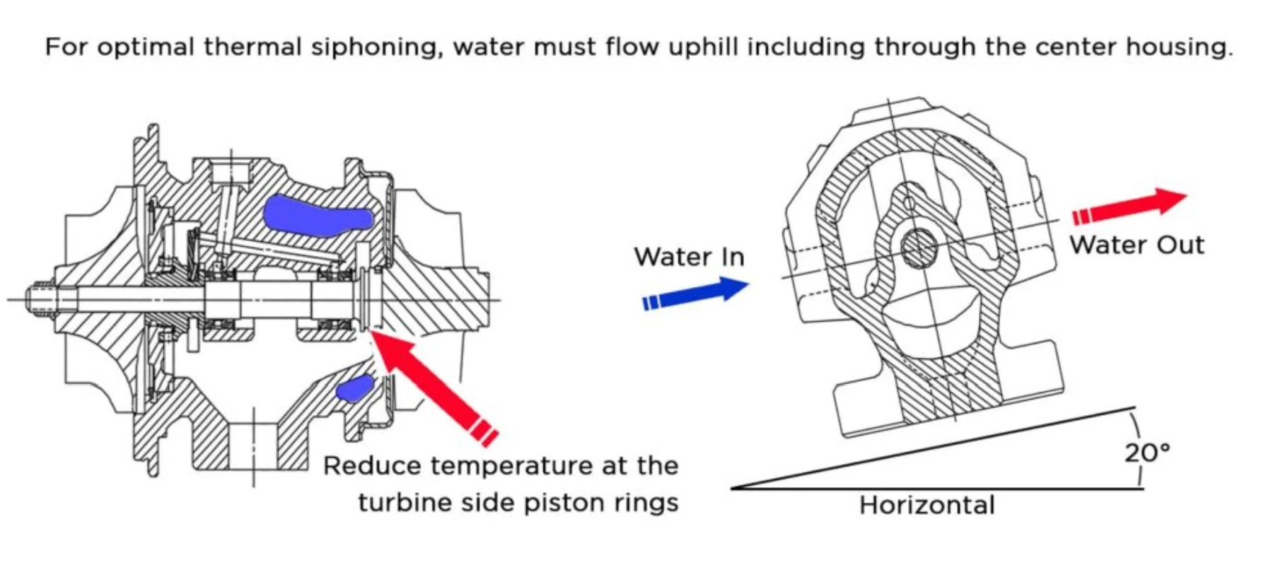

I know garrett advices to run coolant lines like this within 20 degreese for syphoning

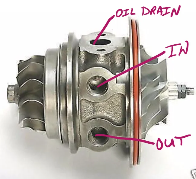

Is it ok on MHI turbos TD05 TD06 with 4 water cooling ports (2 ports on each side) coming off one side? I've seen some setups like this due to space limitations. I'm asuming its ok because the outport is higher
The important part was having the out line higher than the in line.
