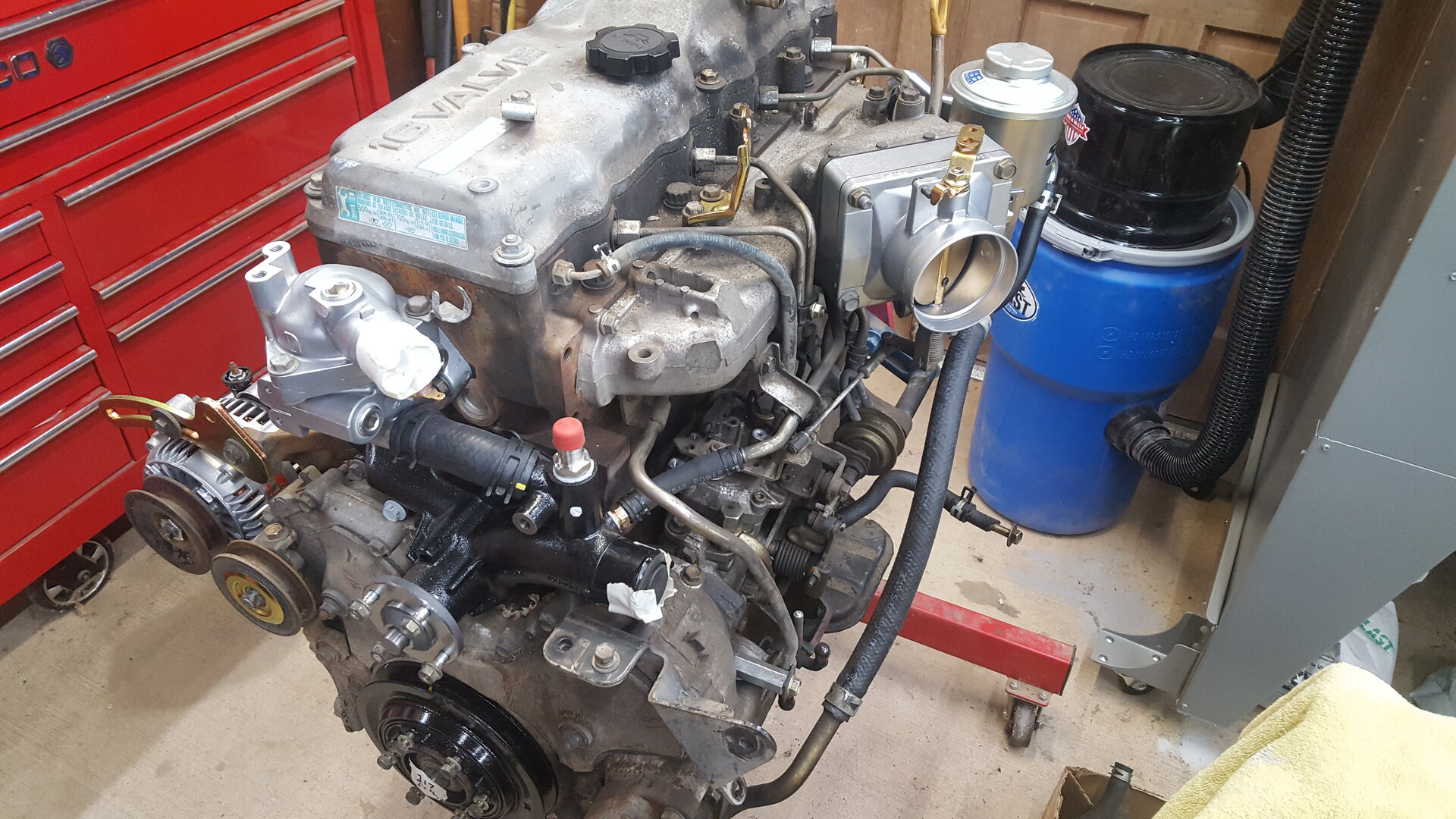

Throttle body...diesel engine. My 3b has a throttle body as well.
That throttle body is for soft shut-down and fast warm up (emissions). Your diesel engine does not run at stoich.
That throttle body is NOT for shut down on either of the engines I mentioned. Please tell me how the turbo differentiates whether it's on a gas vs. a diesel engine.
