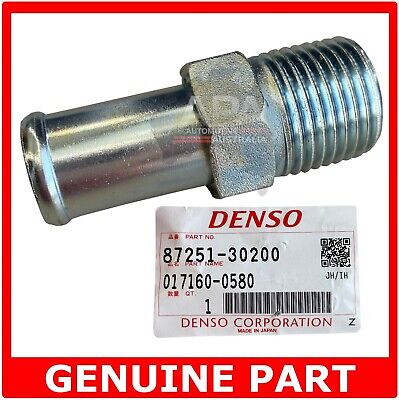

I bought a replacement water pump for my 2B engine, which has been installed with no problems. At the top discharge that I circled on the picture, the fitting was rusted, and the threads are cracked. Does anyone have an idea where I can find a replacement part? I've called a couple of normal sources and looked at the schematics and cannot find this part identified. The previous owner had cut this off as shown in the picture and run a hose which seems to be working just fine.
Any help would be greatly appreciated.
Same on the 2H.. I just used a 5/8 brass fitting from my local parts shop. If you're after genuine they are readily available.. the part number is 87251-30200
eg:
