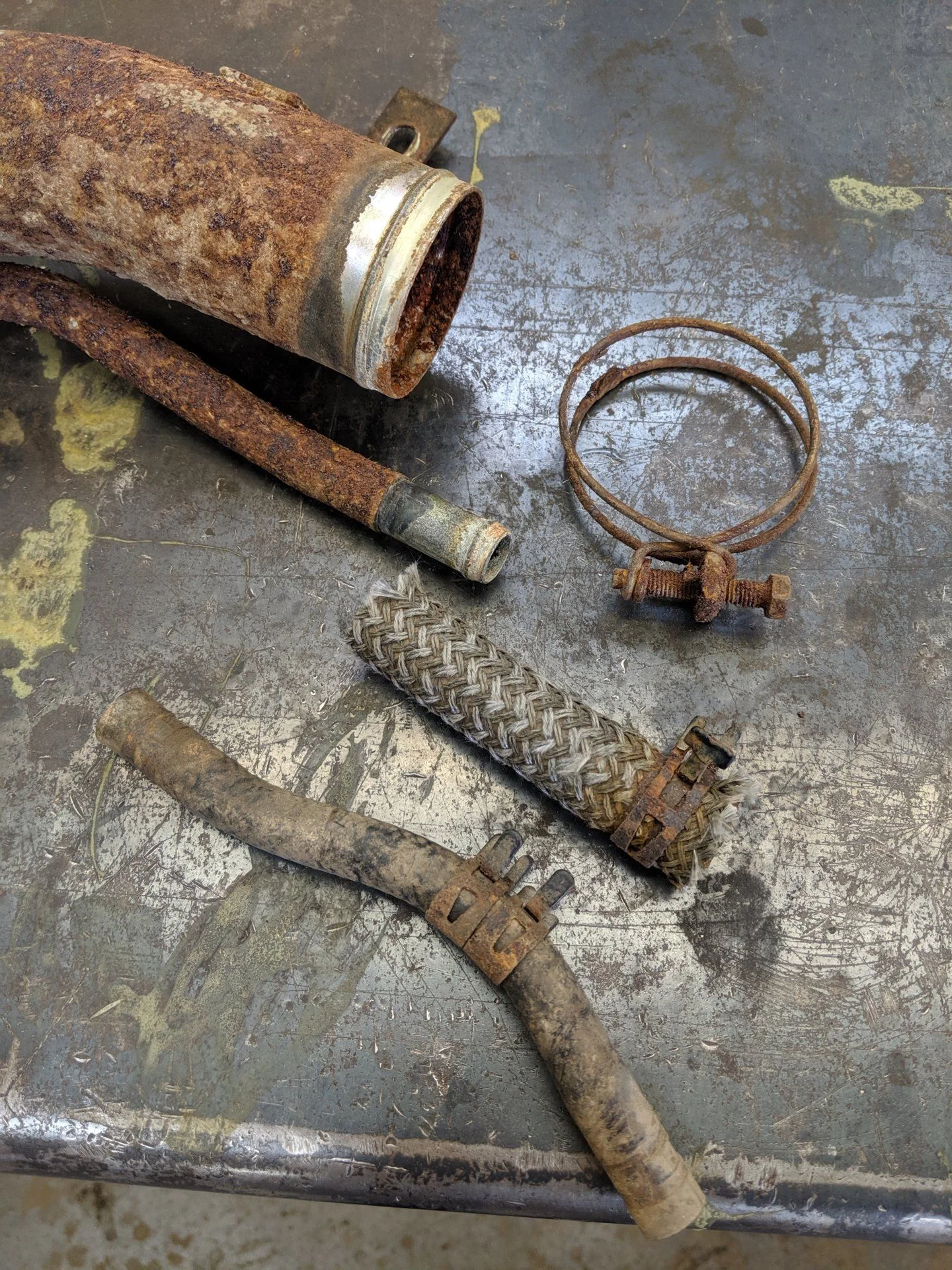

My 1980 is getting a new fuel tank installed and I would like to replace all the original rubber fuel lines and a few of the rusty line clamps with factory. The two sizes of fuel line that Napa had seem to be slightly off in terms of size. The small black line from Napa I can probably make work but I could not find a match for the larger fuel line that has a braided exterior (see picture). Also I would need to get clamps for both sides of the fuel line and the two band clamps for the filler neck. Can anybody help steer me in the right direction to get these lines and clamps?

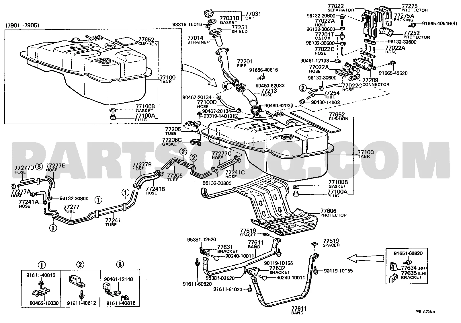

Inlet hose band clamps 96111-10630 (replaces 90460-62033), retail $4.60 each.
Which hoses and clamps?
One of the smaller clamps is 90467-20134, still the same part number, retail $2.27 each.
One of the smaller hoses (Part ID 77100D) is 90445-22024 (replaces 90445-22016), retail $18.59.
Back when Cdan was still at American Toyota in Albuquerque, before he retired to the Land Cruiser Heritage Museum, he told me about Part IDs vs. Part Numbers. Your local dealership should be able to pull the correct, current Part Numbers for your production date using the Part IDs in the diagram above. Sometimes your VIN is needed to get the correct Part Number.
Toyota has been replacing many of the pre-cut hoses with generic OEM hoses of longer lengths, and in some cases replacing molded hoses with straight hoses where the bends aren't too extreme. Good examples are the FJ60/FJ62 oil cooler hoses.

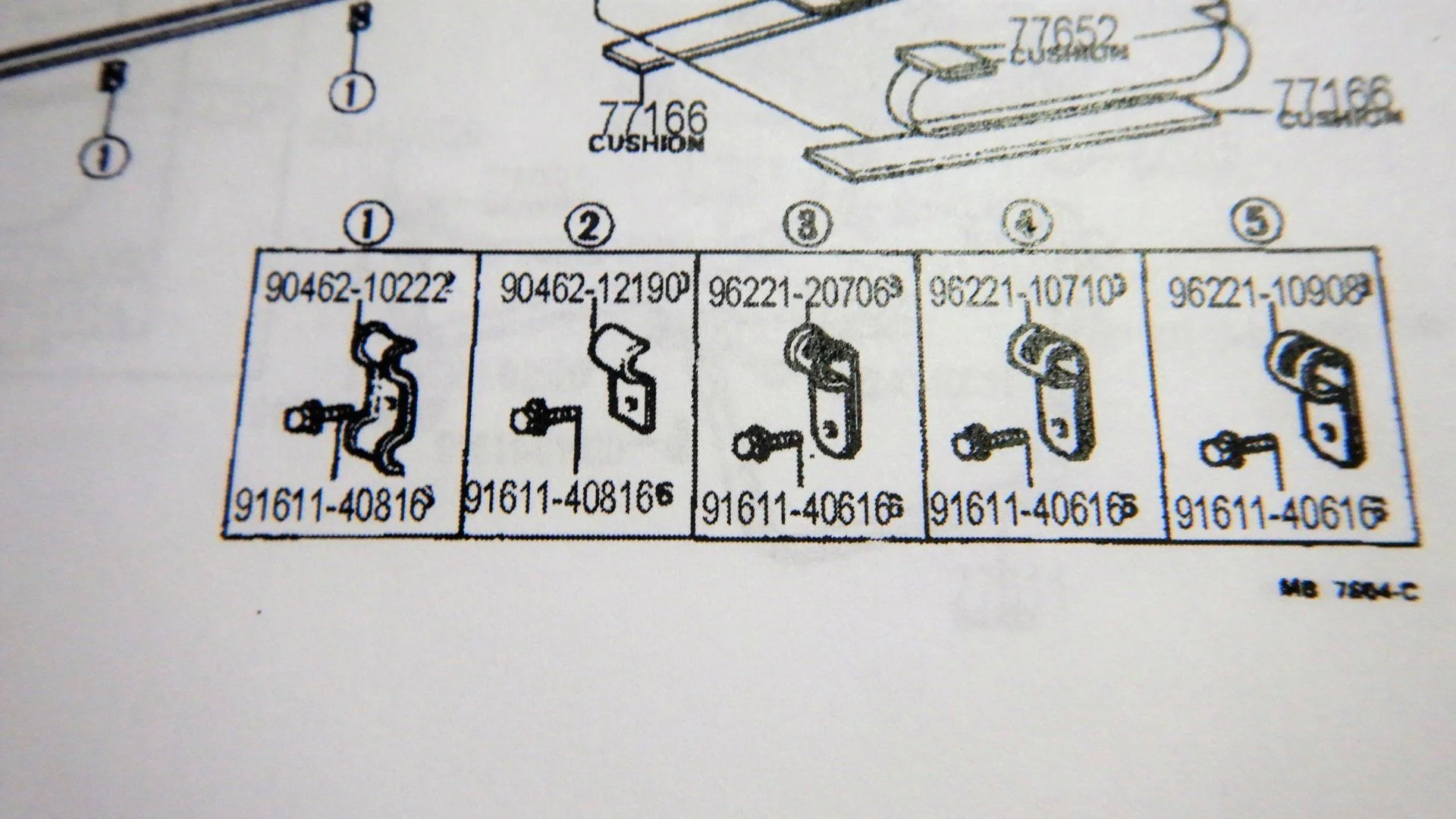

@73FJ40 while you were rebuilding your fuel system and frame lines, did you come across any brackets and clamps for the hard lines that attach to frame rail? What appears to be a simple part is challenging to locate. Specifically looking for #90462-10222 or anything in zinc, stainless steel, yellow zinc or painted that will work.

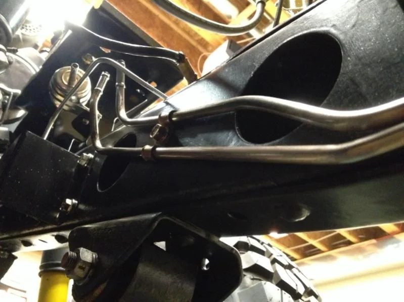

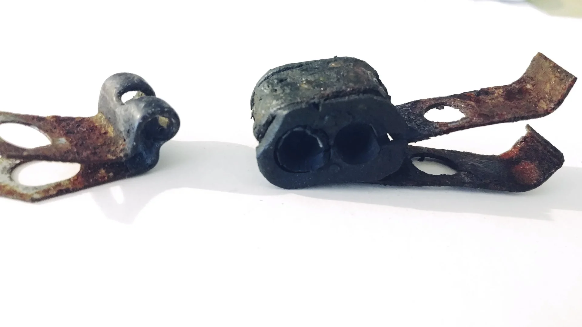

Wondering if anyone has a good solution/resource for the double fuel line holders with rubber insulator that run back along frame rail? Also those brake line holders are nice cause of the little step in them, I know generic ones are available at Stop Shop and other places.....

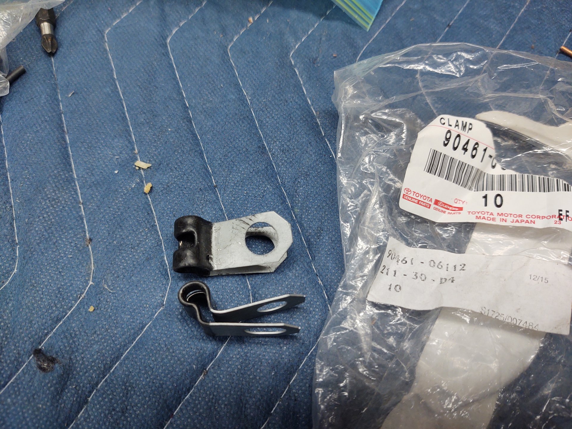

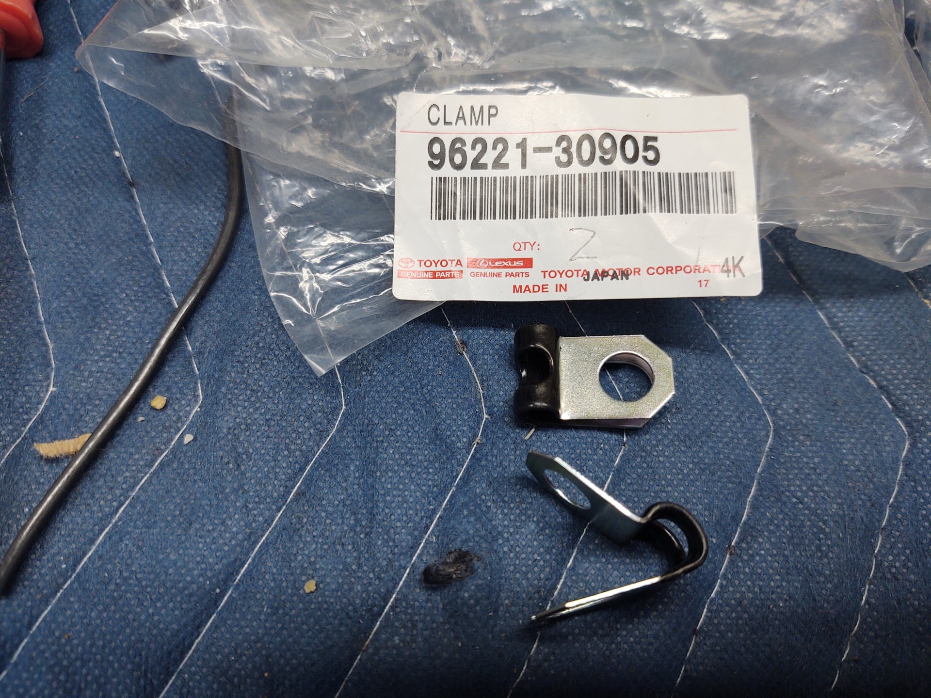

Here are two different brake line clamps that I've used. Both appear to be still available.
Clamp - Toyota (90461-06112) OEM list $2.07​
This looks like it matches your example.
Clamp - Toyota (96221-30905) OEM List: $3.45​
thanks, will order those up... Now I just have to hunt or fabricate the double fuel line clamps! They are discontinued unfortunately
Wondering if anyone has a good solution/resource for the double fuel line holders with rubber insulator that run back along frame rail? Also those brake line holders are nice cause of the little step in them, I know generic ones are available at Stop Shop and other places.....View attachment 3164090
double clamp I found is 47372-60020
Nice!, for '91-'97 double brake line.....but quite possible that could be modified.....
Sorry, I saw the picture and didn't connect what I read to fuel line. Yes, they are double brake lines.
