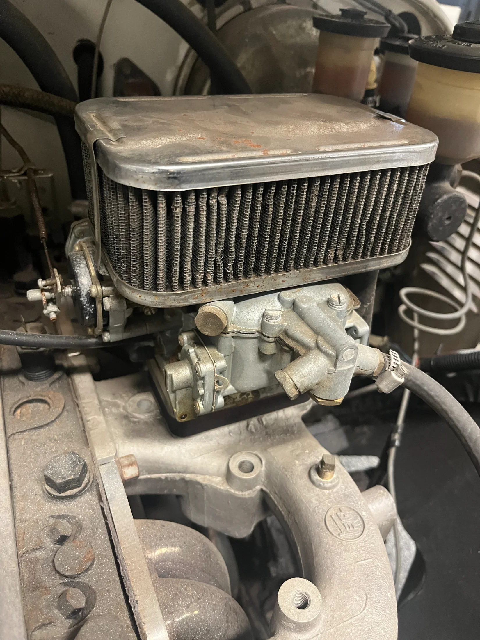

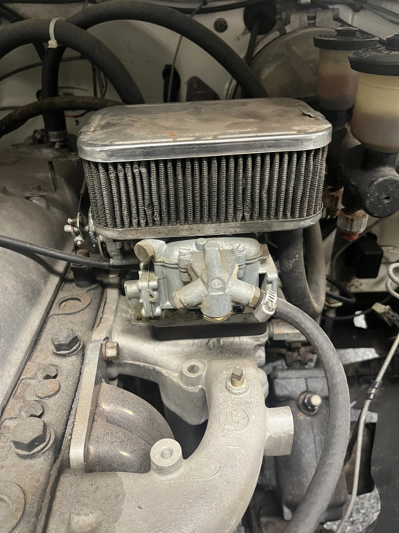

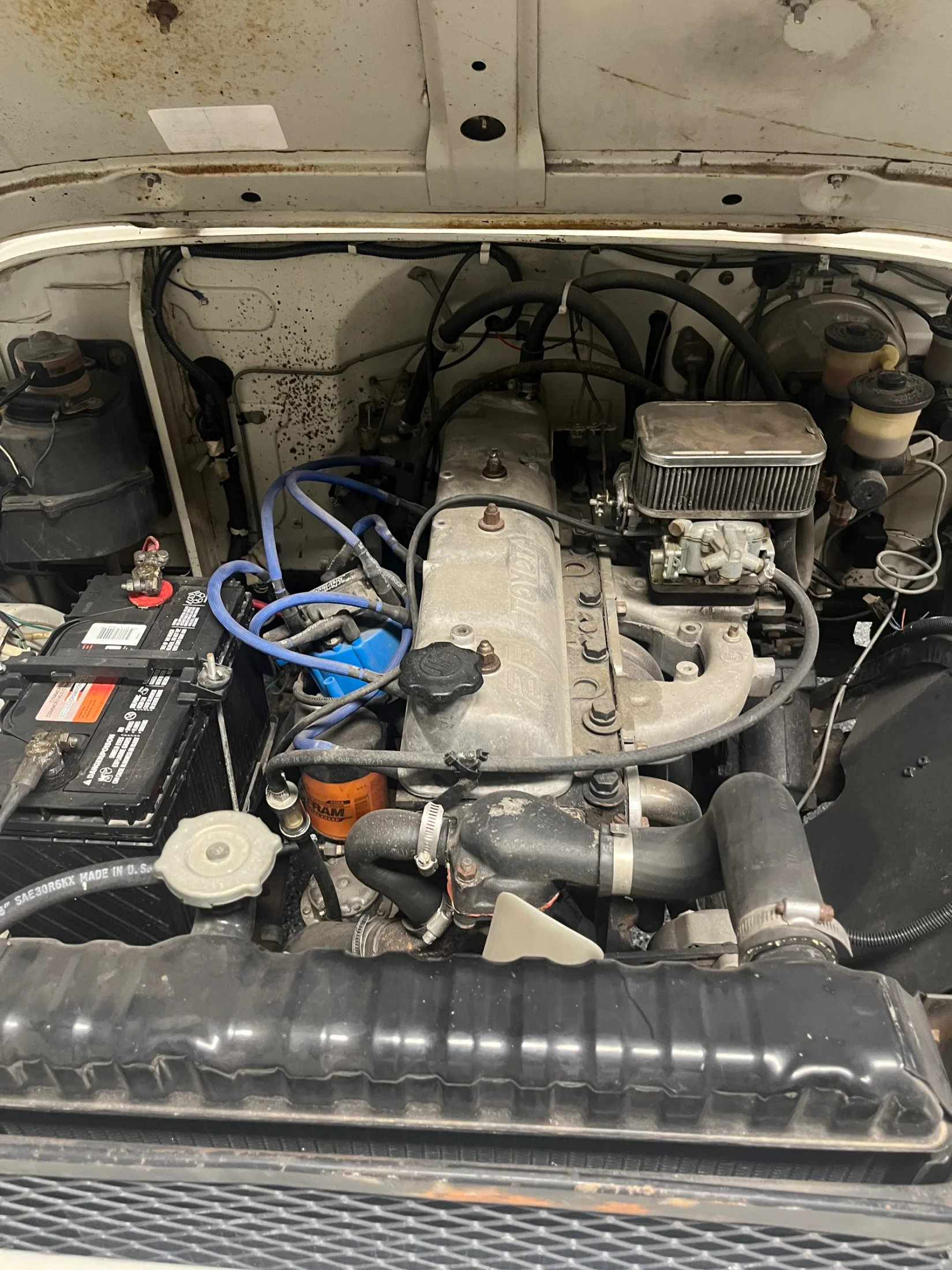

Just picked up this 74 FJ40 and the previous owner de-smogged it and added a weber carb. It appears the previous owner was in the process of replacing the old fuel tank when he passed away. I hooked up the fuel tank and now I’m a bit confused when I see the carb and no obvious port to connect the fuel line return from the gas tank. Also which port on the carb does the line from the charcoal canister go to?

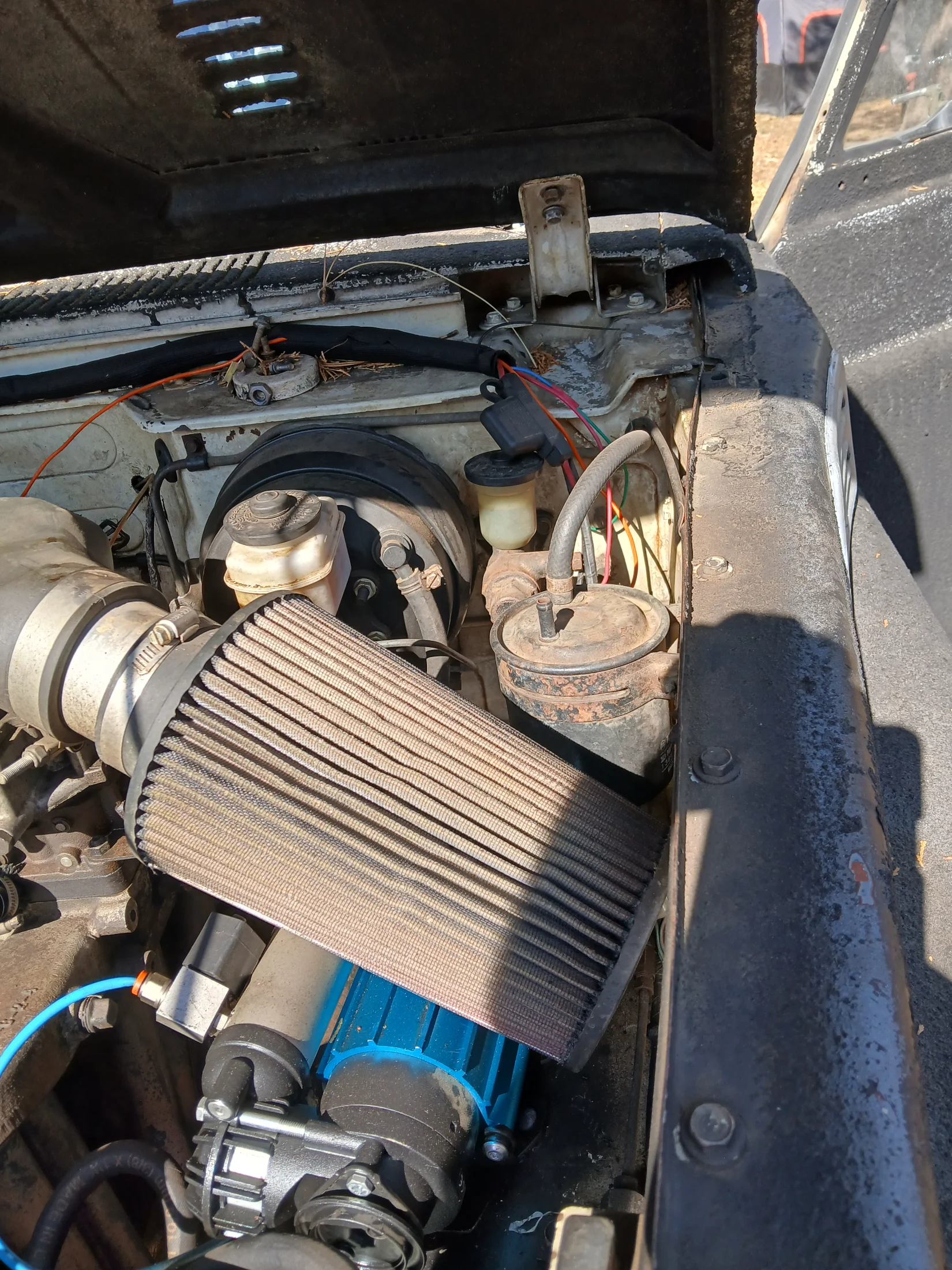

I think that a good de-smog keeps the charcoal canister. Charcoal canister does not need to vent to the carb, mine vents to atmosphere.

Agreed. I think this tank side one is also the vapor separator? And it's gonna a stink unless @SoCal74 routes or plugs the ports.
Edit: @Pighead wait your's is open?

Yes coming out of the fuel tank one one side are three fuel vapor lines that go into a three port fuel vapor separator that converts it to one line coming out of the fuel vapor separator and that line goes to the charcoal canister in the engine bay which helps manage and divert the fuel vapors, just teying to figure out where to connect the exit line out of the charcoal canister but looks like leaving the exit line unplugged and venting into the air in the engine bay might be the way to go.
