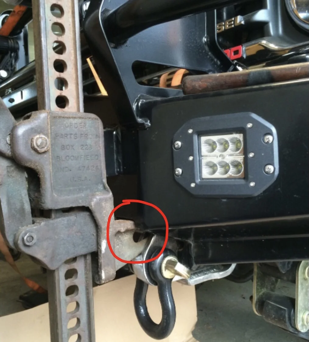

Notched specifically for a high lift jack.
Increases the safety factor a bit.

What are these tow points and shackles? I don't have this on my ARB front bumper and am looking for a way to add front shackles to my troopy!
I no longer own that particular Land Cruiser so I can’t comment with certainty on the shackles (I’ve run Terrain
Tamer suspension on a number of my Cruisers so if I had to guess I’d say it’s one of their products).
The tow point is an Odd Iron Off Road product and is available through their website.
I haven't found a source - anywhere - for tow recovery points for a Troop Carrier. Rob from Odd Iron looked at mine at Wind Rock and he thought that their tow point would fit with alteration but we haven't progressed. Every tow point I've found specifically excludes the troop carrier and I have no idea why this is?? What's different about the frame horns on a Troop Carrier?
Nothing as the frames are the same in the front between all leaf sprung 7x models
Derailing this thread a bit, but here's your recovery point: Rescue Point ARB (8000Kg) Toyota 70 Series (1999+) - https://www.sahara4x4.com/b2c/producto/A-2812030/2/rescue-point-arb-8000kg-toyota-70-series-1999-
