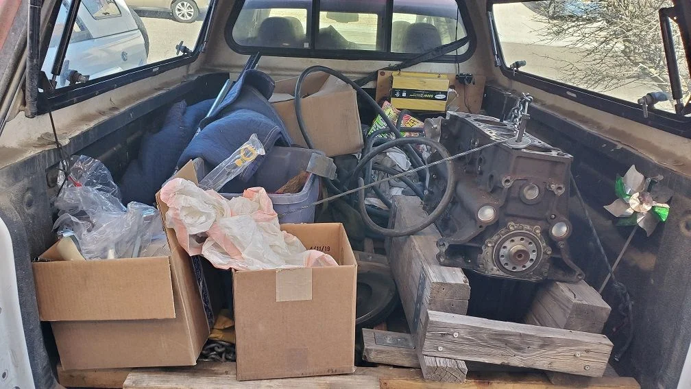

Build a box out of 2x6, on edge. 22re performance has the dimensions on their website,iirc.
Put a couple of 2x4 laid flat underneath to stabilize it.

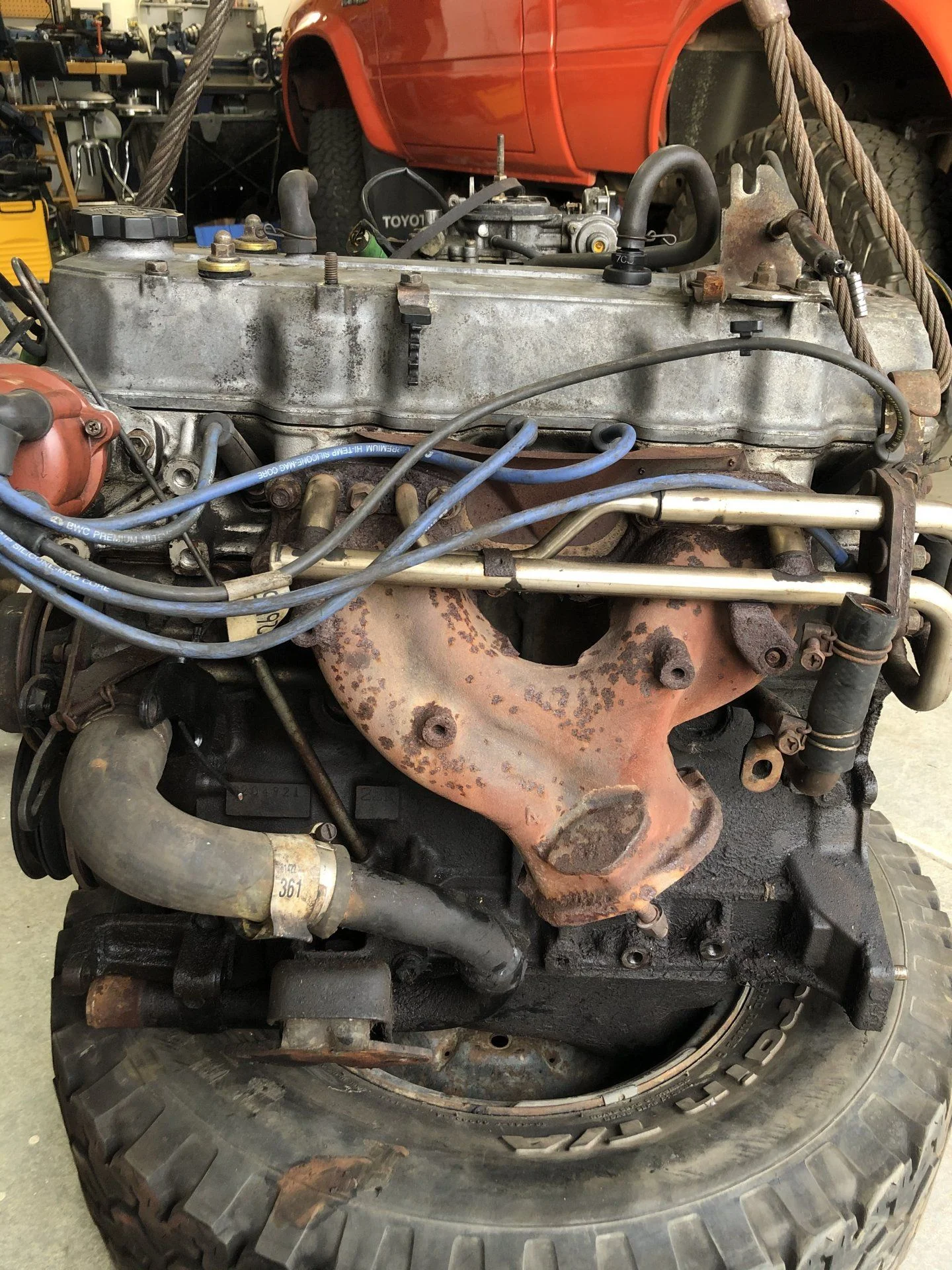

Some folks just plop the engine in the middle of an old tire, letting the oil pan project into the hole in the middle of the tire. Works better for some engines than others, but might be worth a try. You would still need to strap it down to prevent tipping.
Thanks everyone. Much appreciated. Will give it a go with a tire and straps. Let you know how it goes!

The cradle also works if you want to make something. Here is my 3RZ in the back of a truck. This cradle was over kill, but it's what my 2FE came in. I just modified it and reused it.
Thank you @pappy and @SMG for the photos! These make me feel OK about pulling and transporting the motor. This is, as you may have guessed, my first time doing this.
