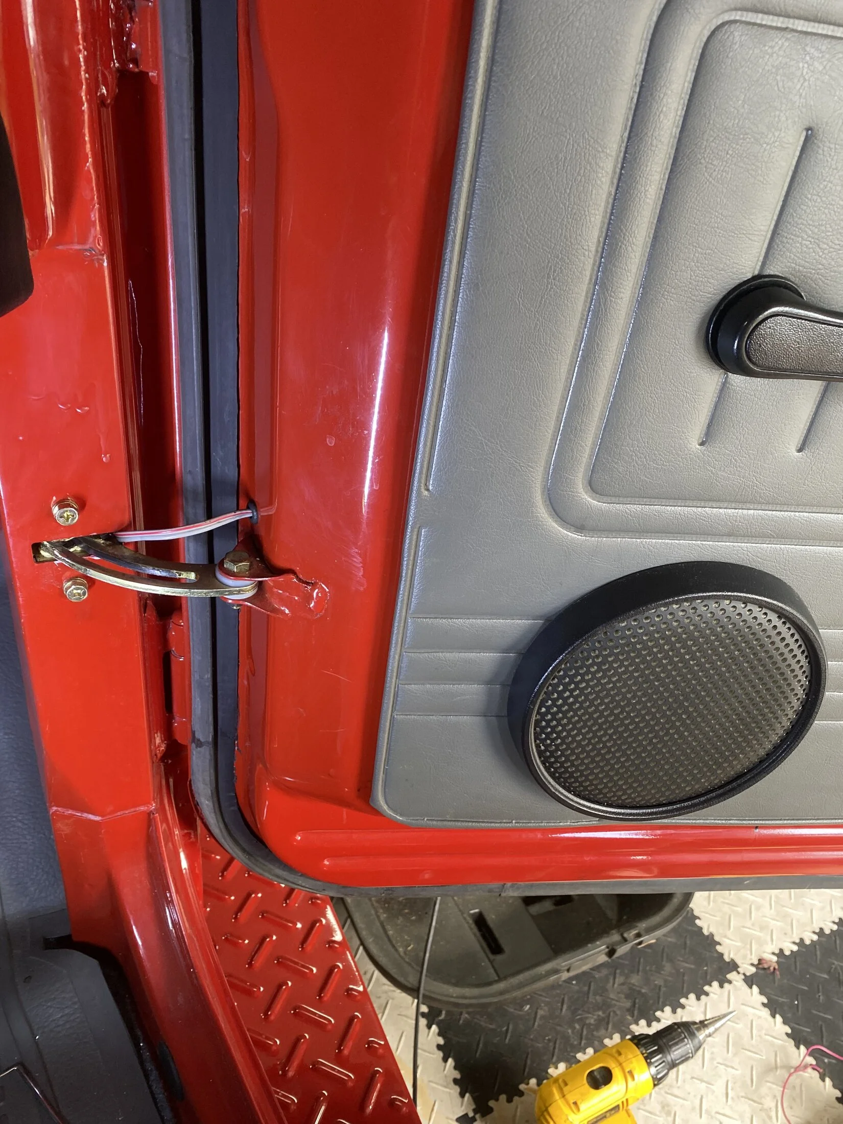

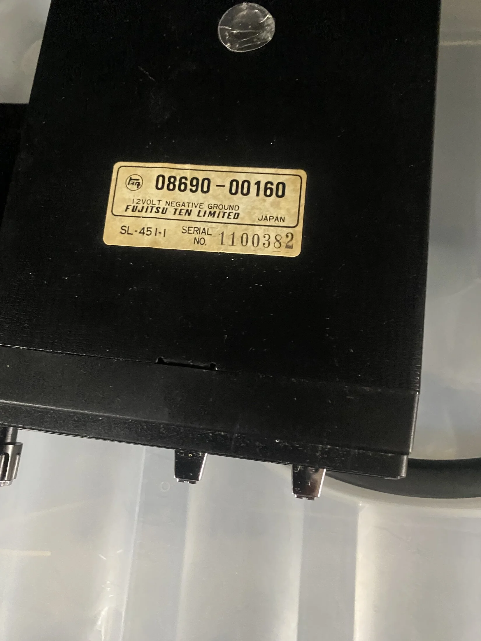

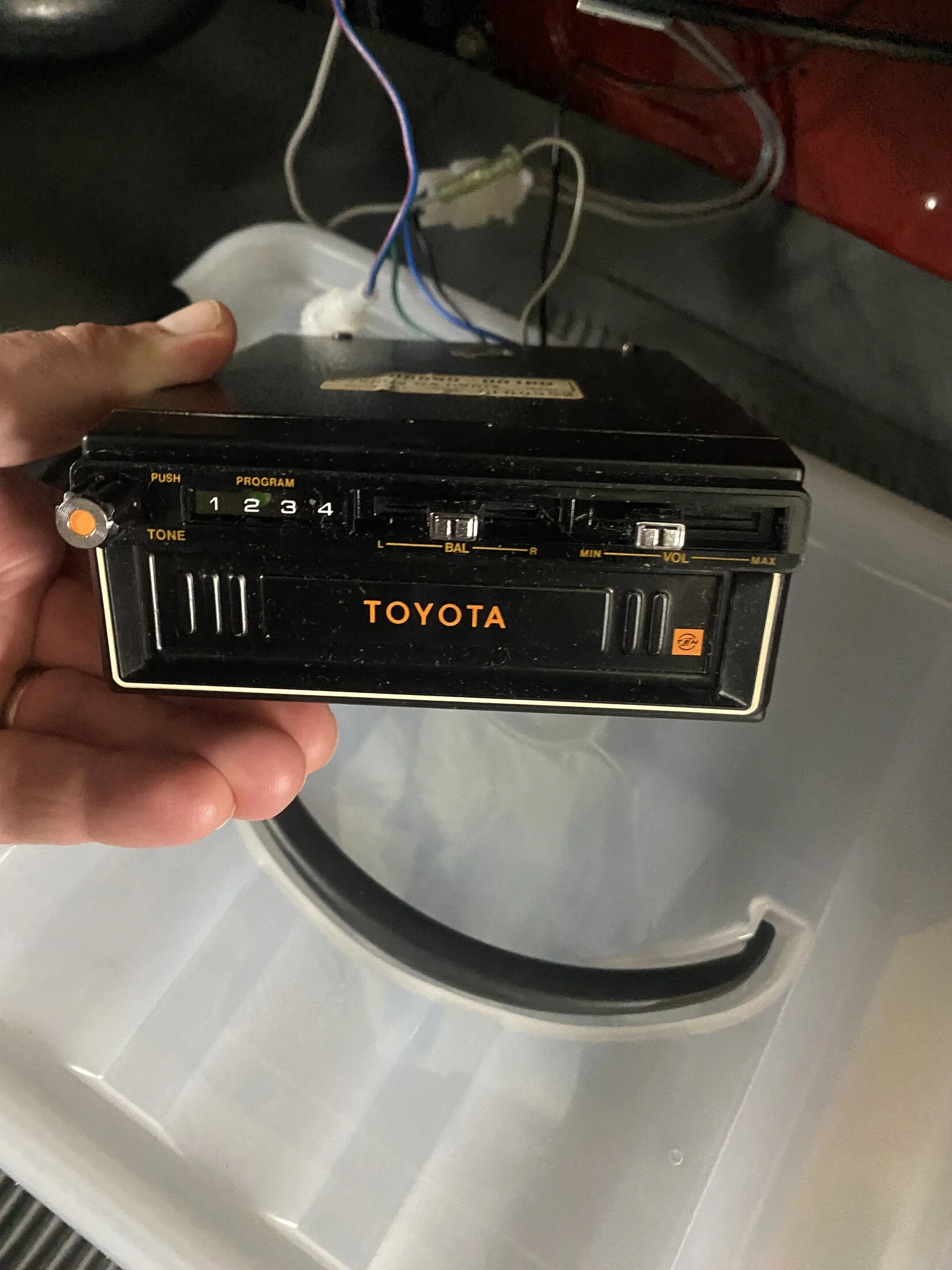

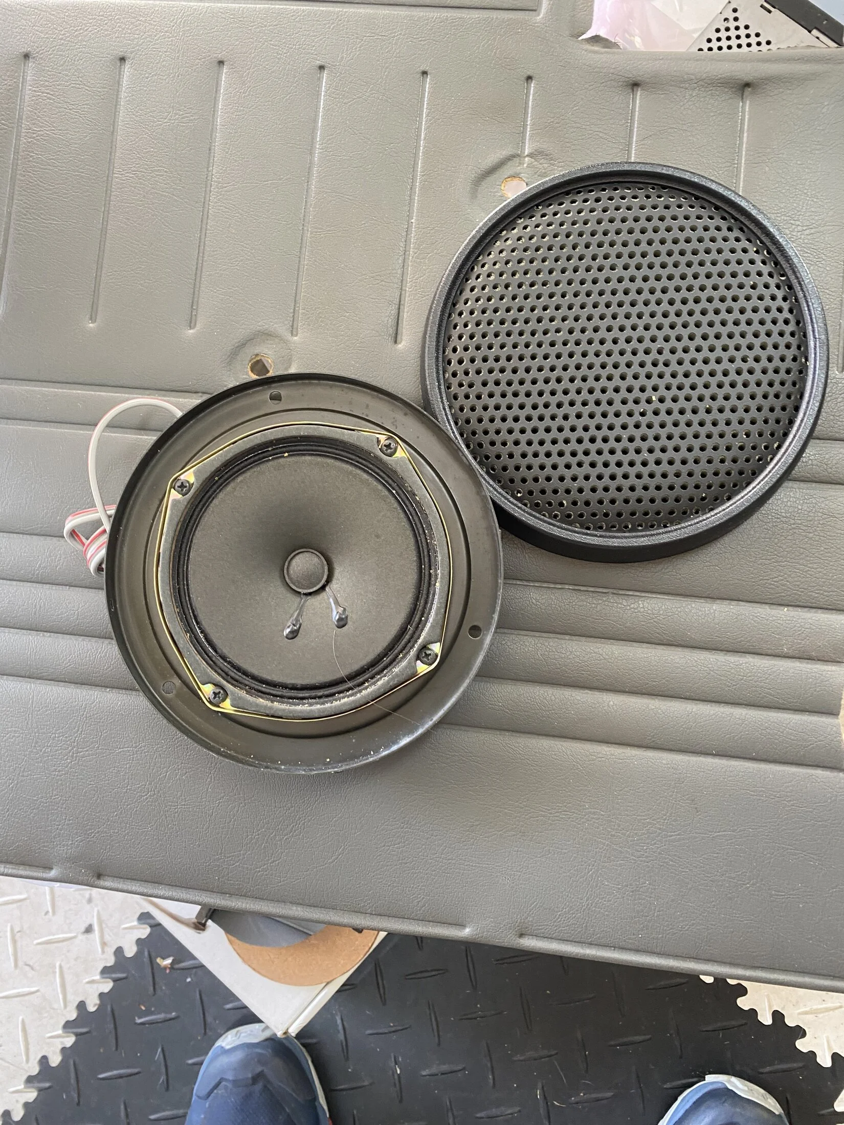

Been working on tracking down an OEM 8 track or cassette player for the 40 for a while. Came across a NOS 8 Track and install kit not too long ago.

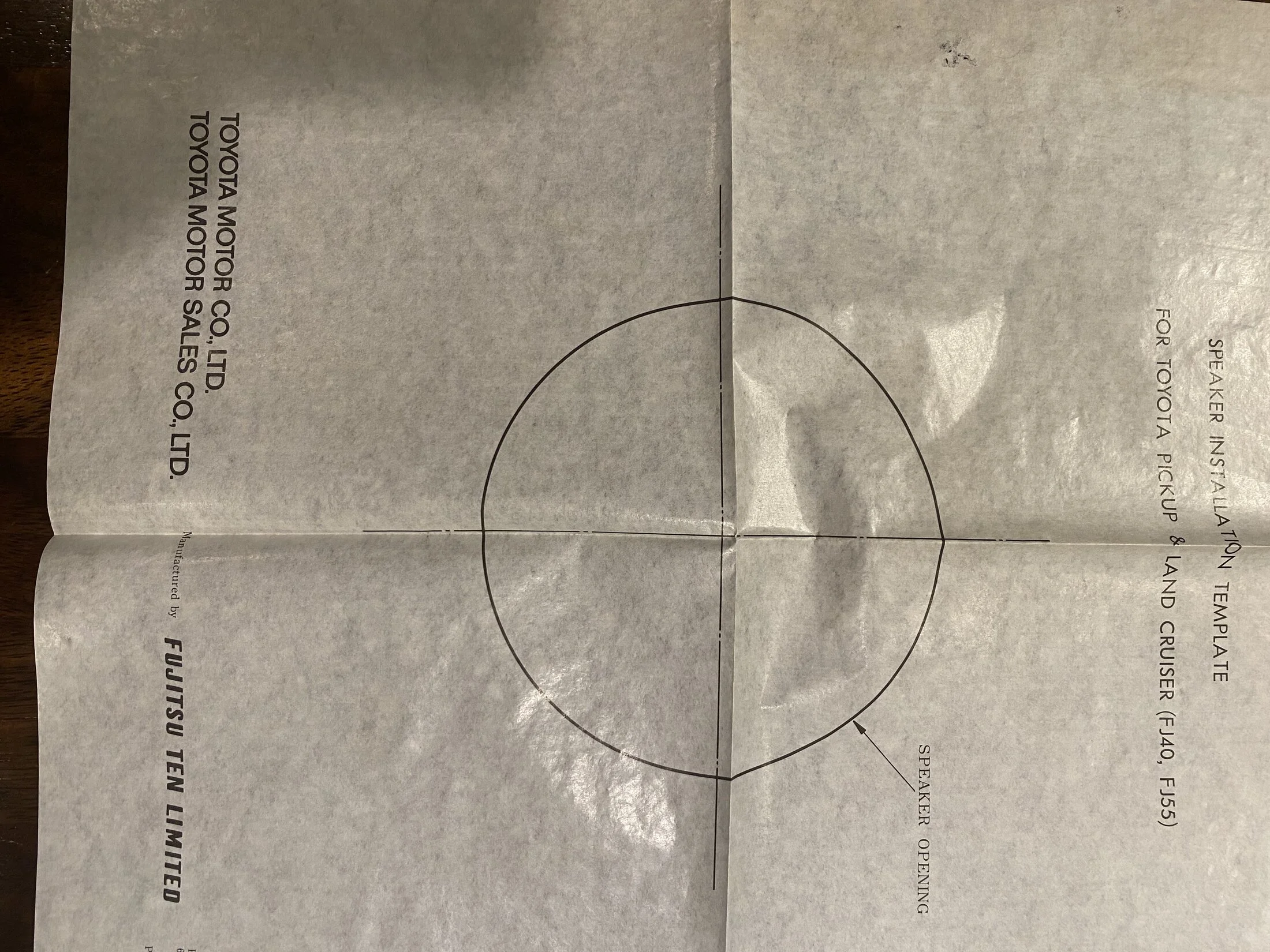

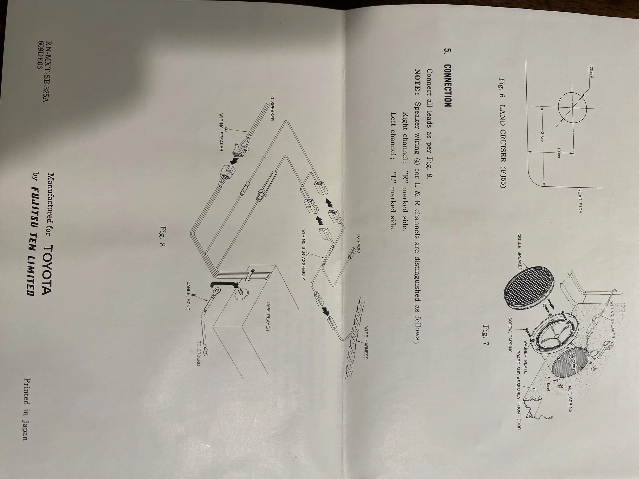

I tracked down the player manual as well Install kit came with a template for installing the speakers but it seems to show installing the speakers in the door next to the seat so I installed based on the openings in the door

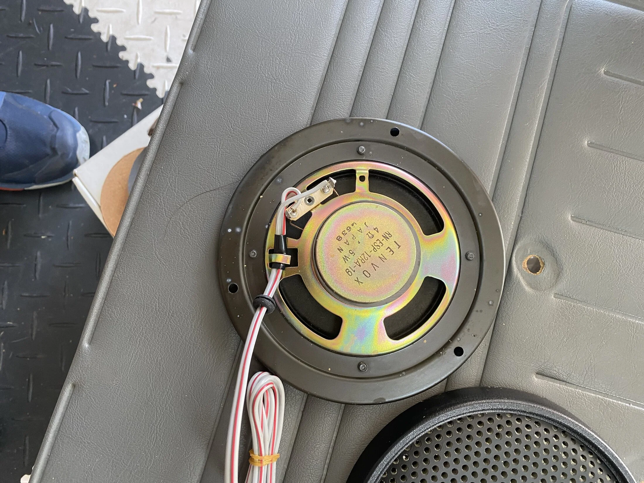

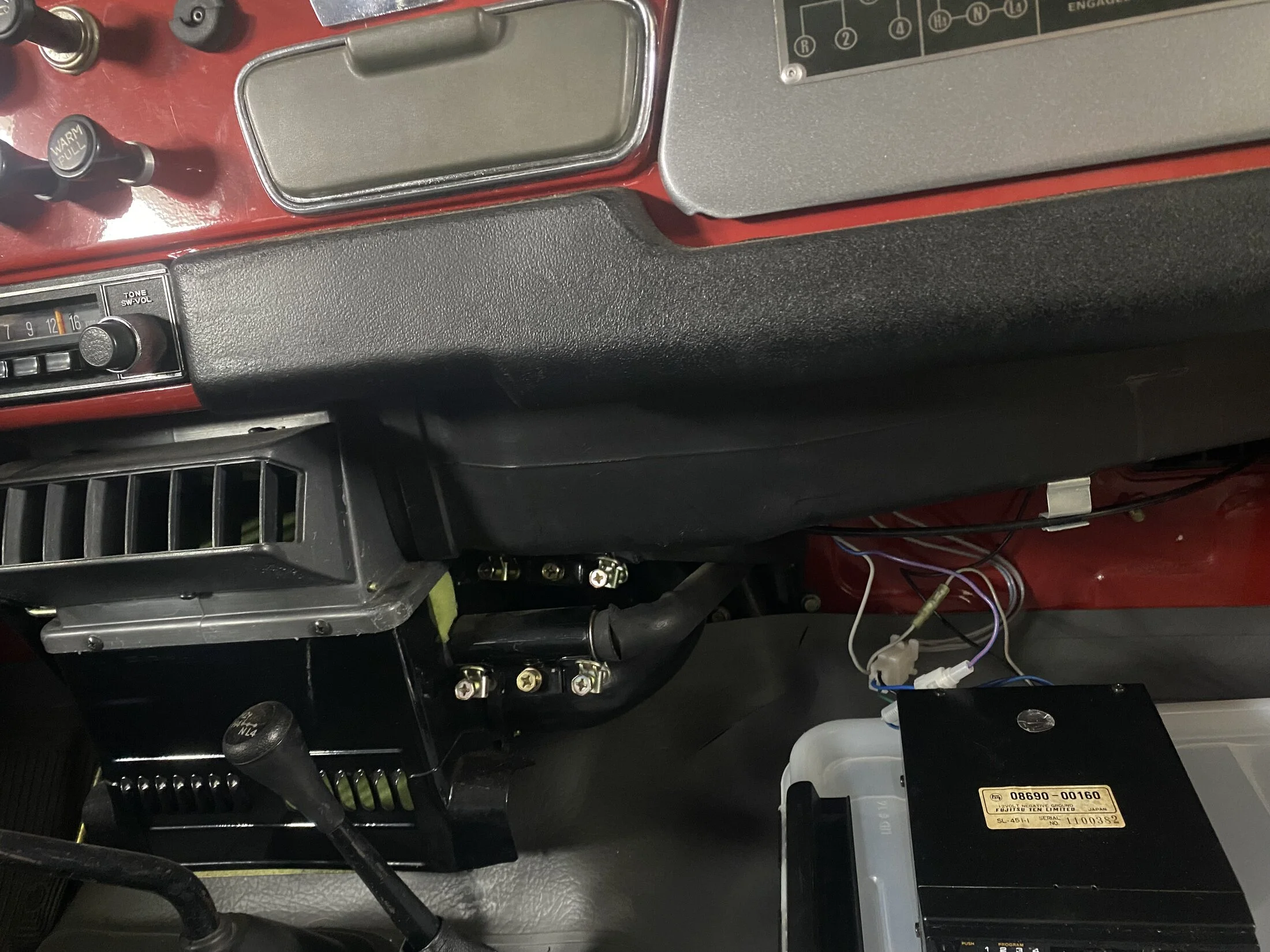

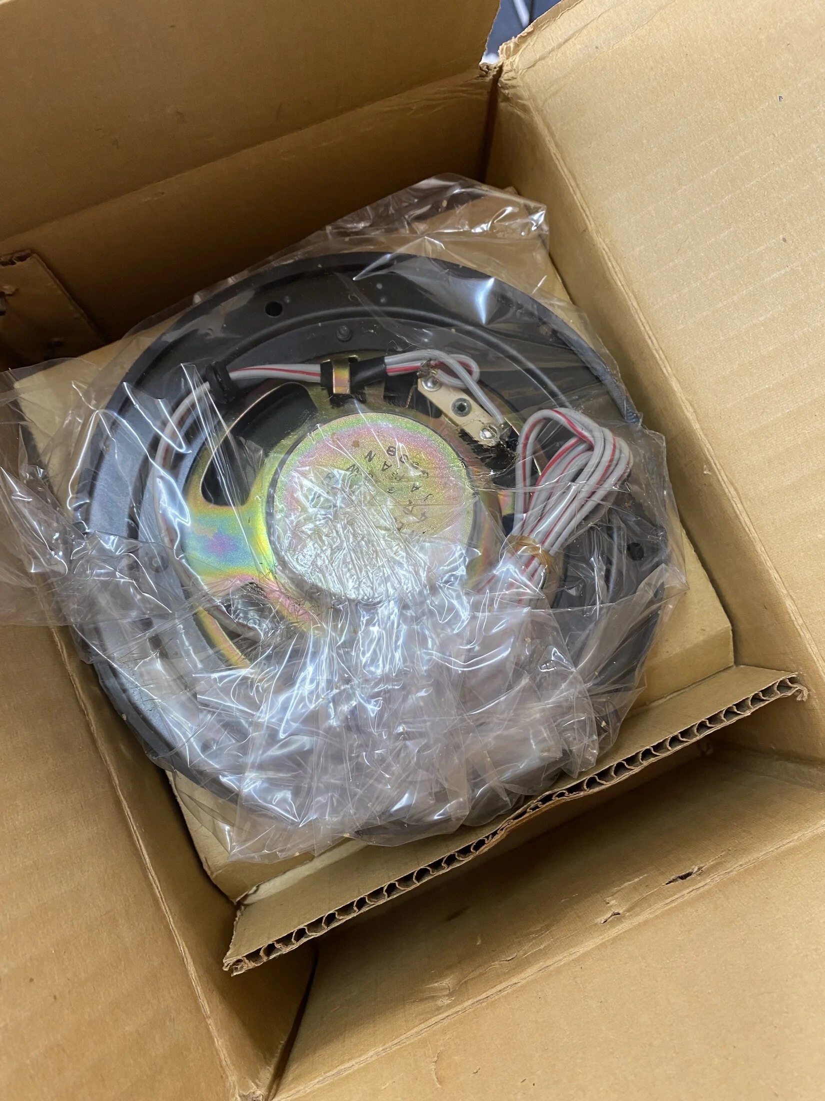

install kit included the speakers and the wiring harness to connect the player to the radio, power and the speakers. There is an existing plug with 12v coming off the harness. The radio has a single spade connector that the harness connects to.
Like the CB40M, the radio turns off when the player is activated/turned on. The player is turned on by inserting a tape.

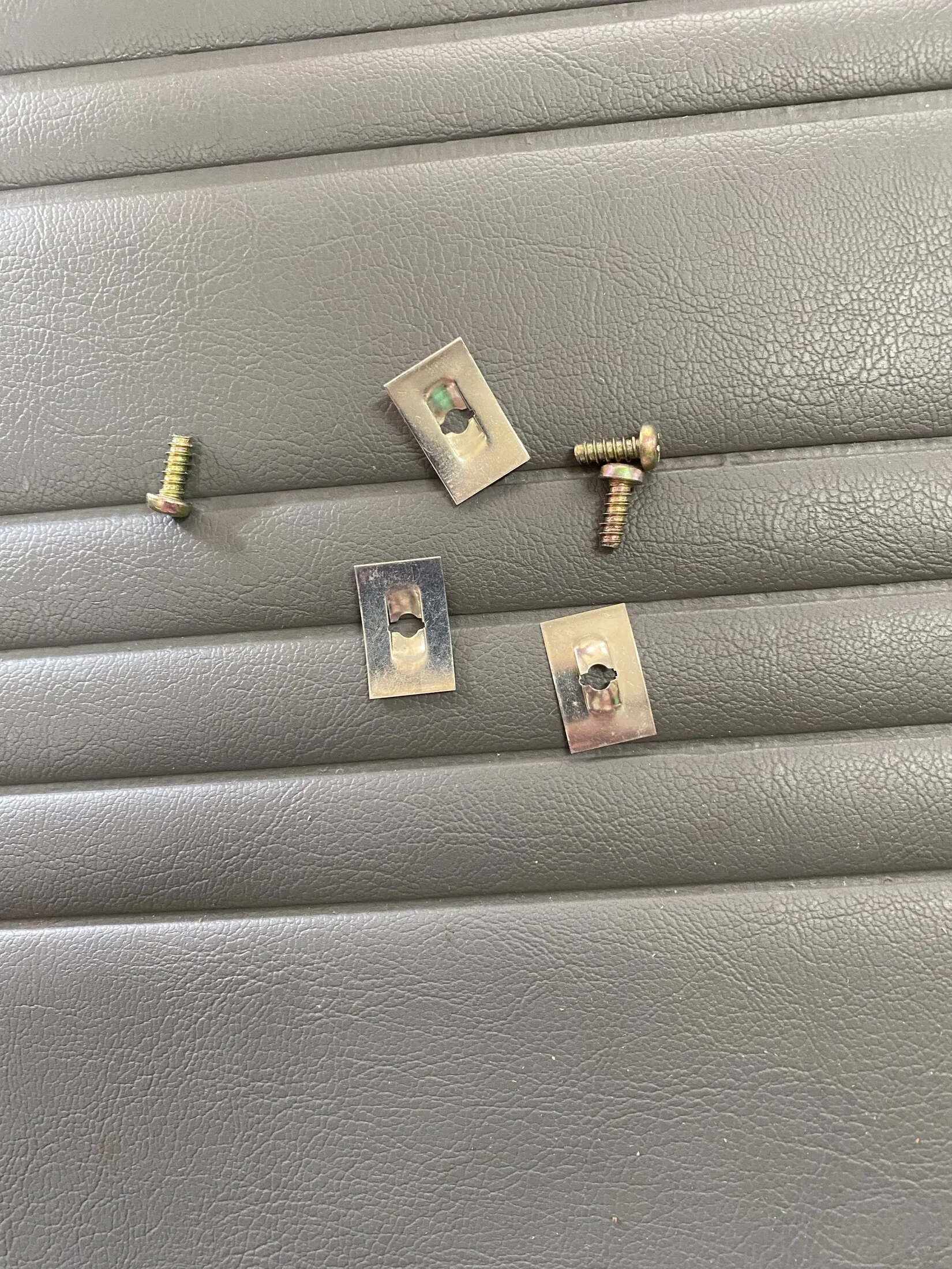

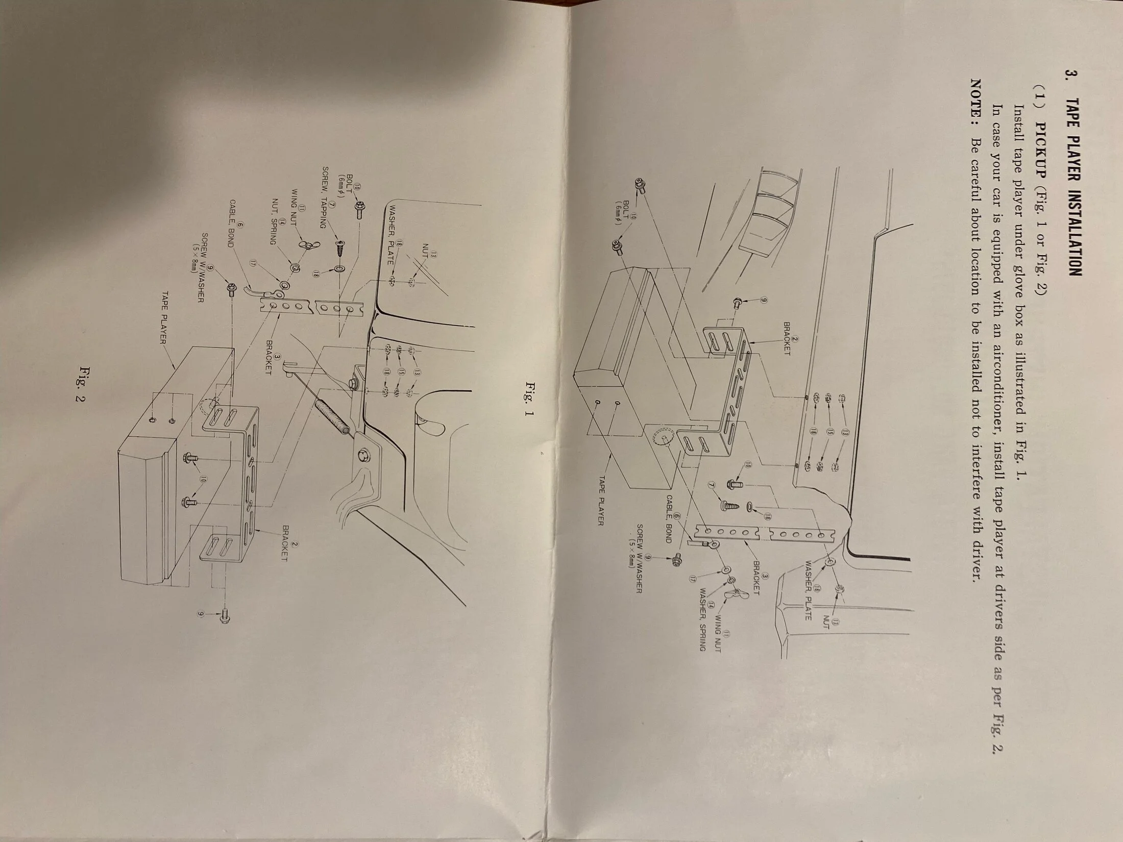

The install kit comes with mounting hard. The installation manual is pretty basic. Not sure exactly how the player is supposed to be mounted under the dash with the fan vent.

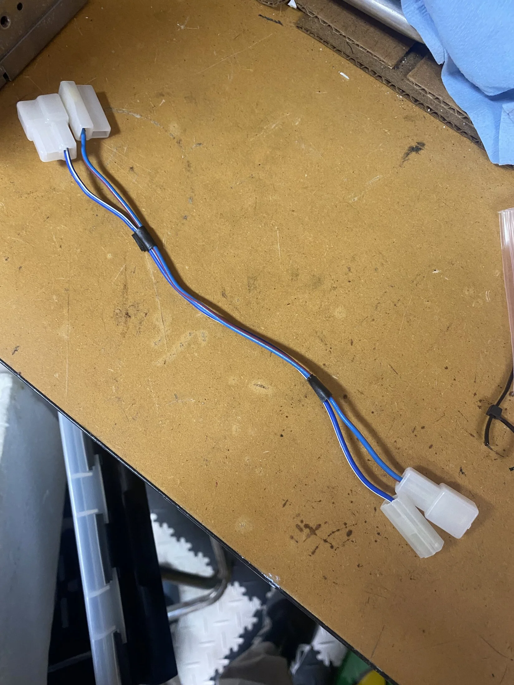

Harness from player to radio and harness power
Been working on tracking OEM 8 track or cassette player for the 40 for a while. Came across a NOS 8 Track and install kit not too long ago.

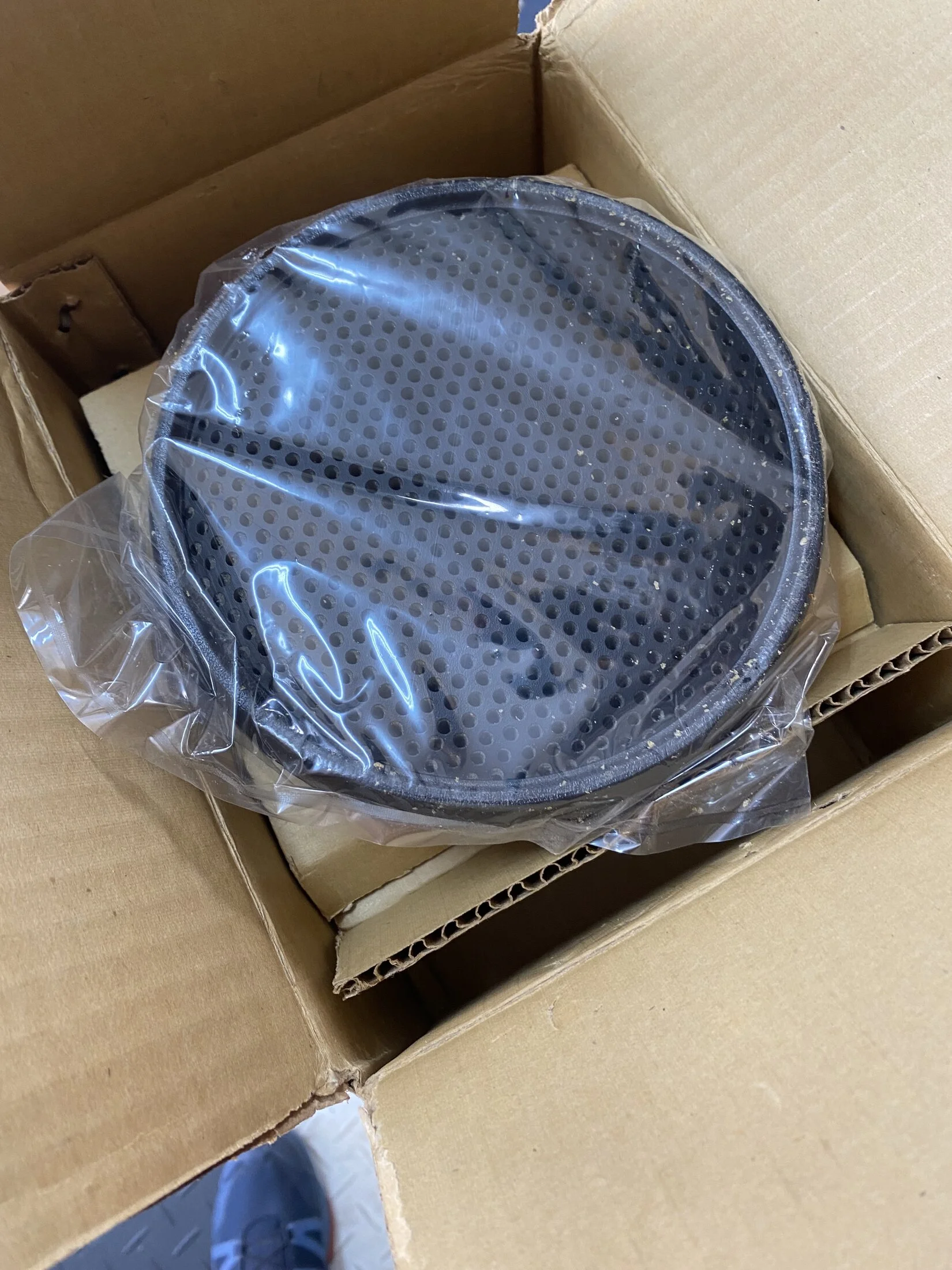

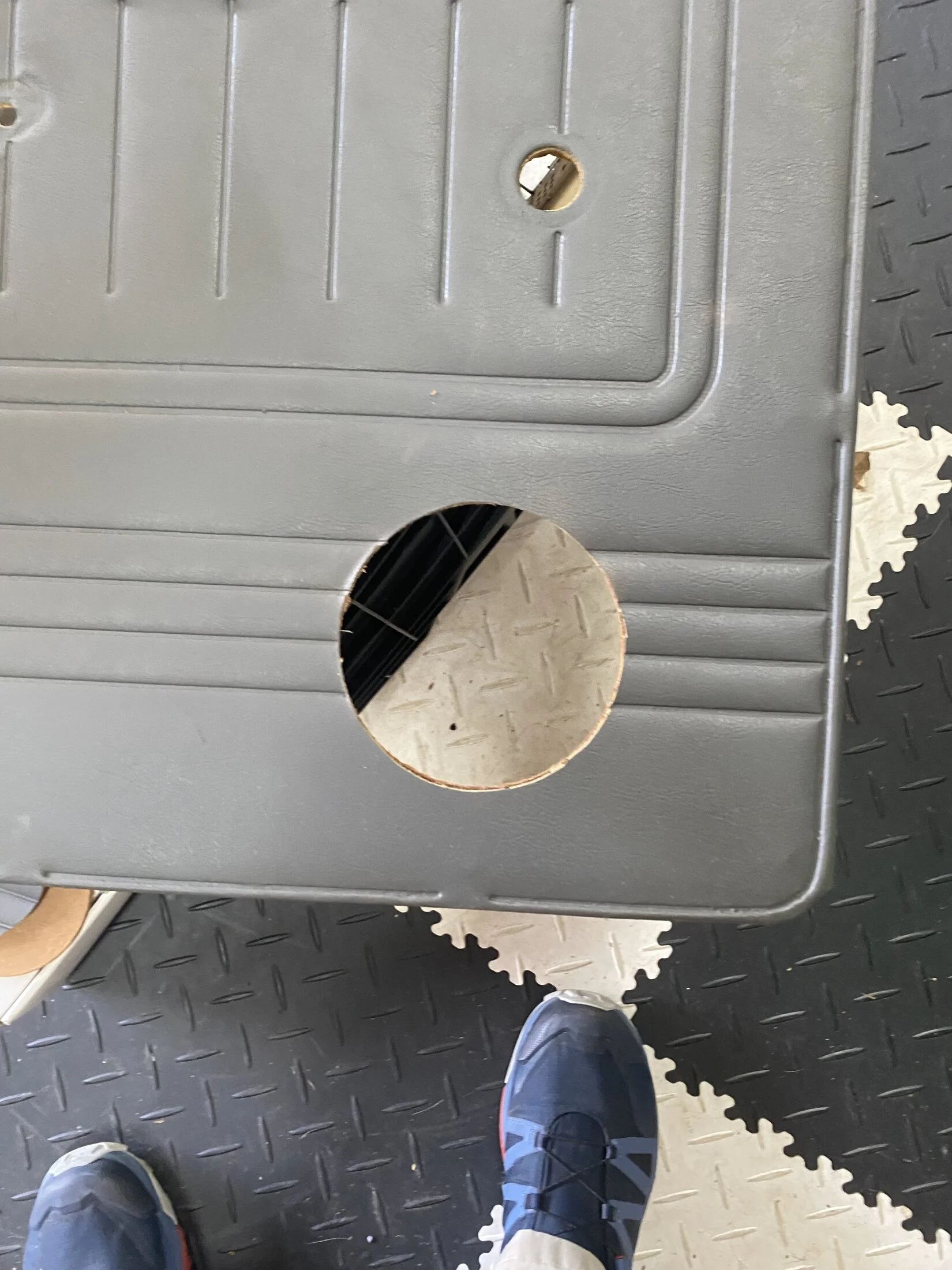

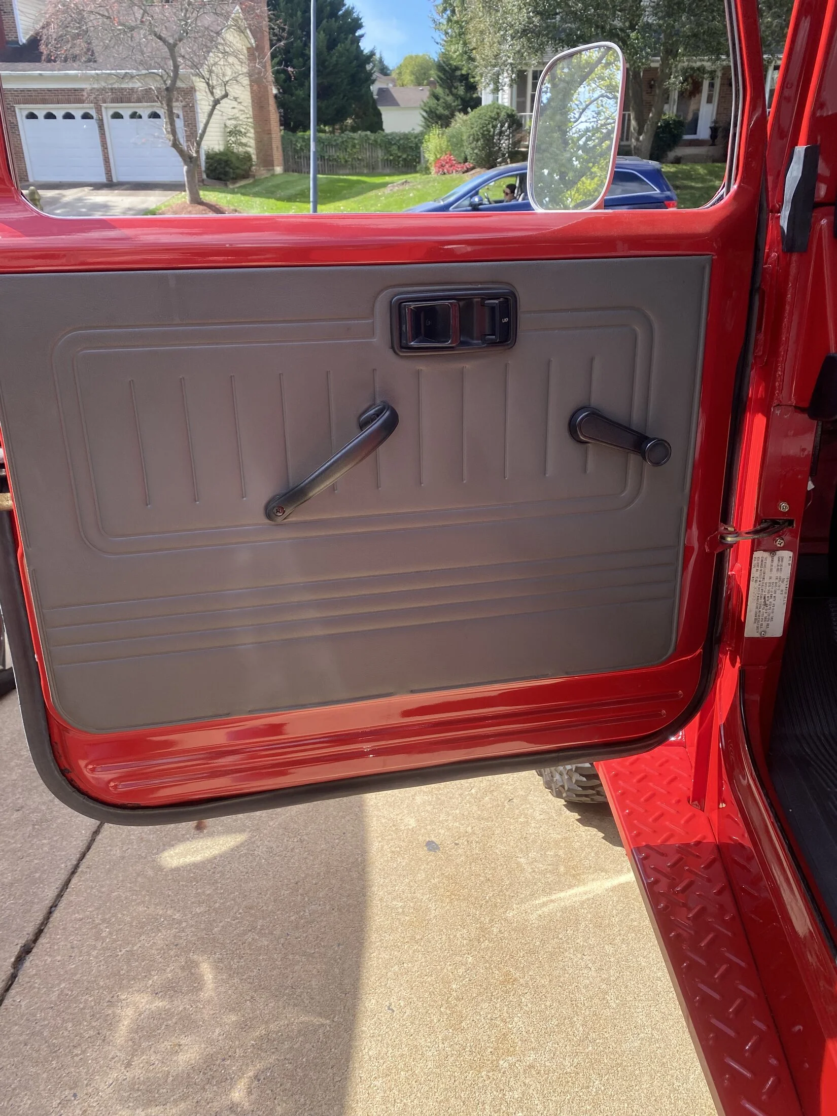

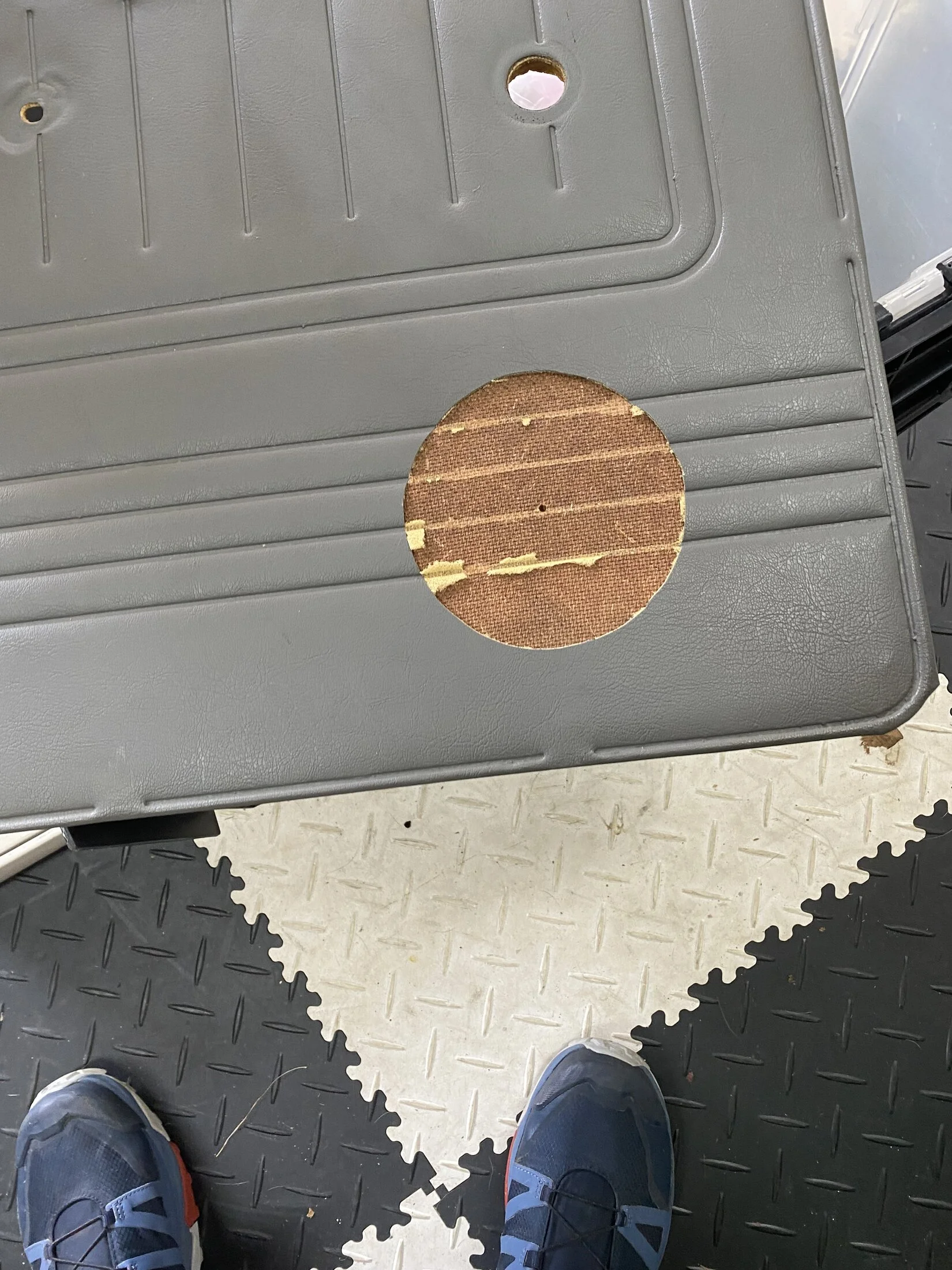

I tracked down the player manual as well Install kit came with a template for installing the speakers but it seems to show installing the speakers in the door next yo the seat so I installed based on the openings in the door View attachment 3751345View attachment 3751346View attachment 3751347install kit included the speakers and the wiring harness to connect the player to the radio, power and the speakers. There is an existing plug with 12v coming off the harness. The radio has a single spade connector that the harness connect to.
The install kit comes with mounting hard. The installation manual is pretty basic. Not sure exactly how the player is supposed to be mounted under the dash with the fan vent. View attachment 3751366Harness from player to radio and harness power

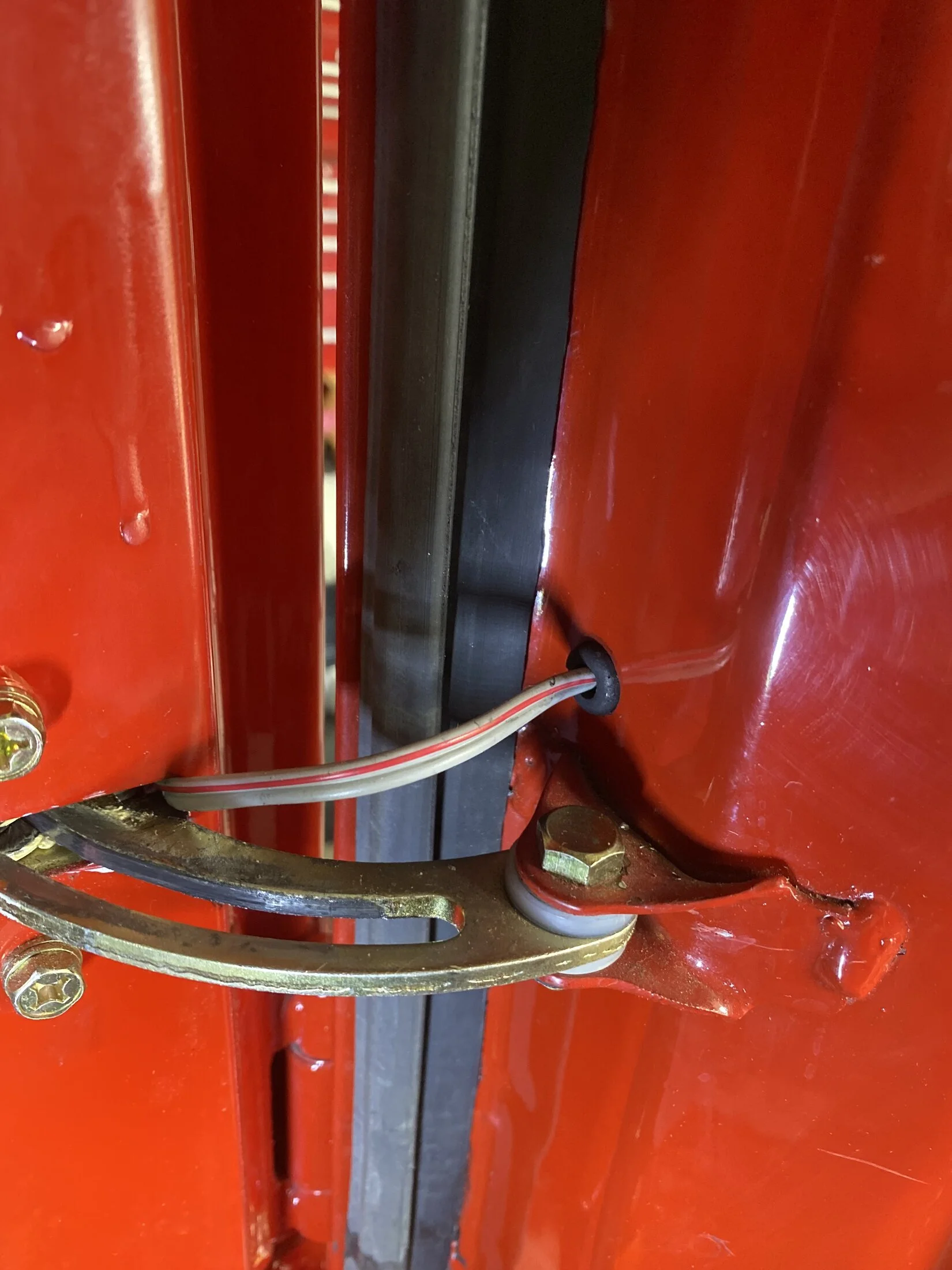

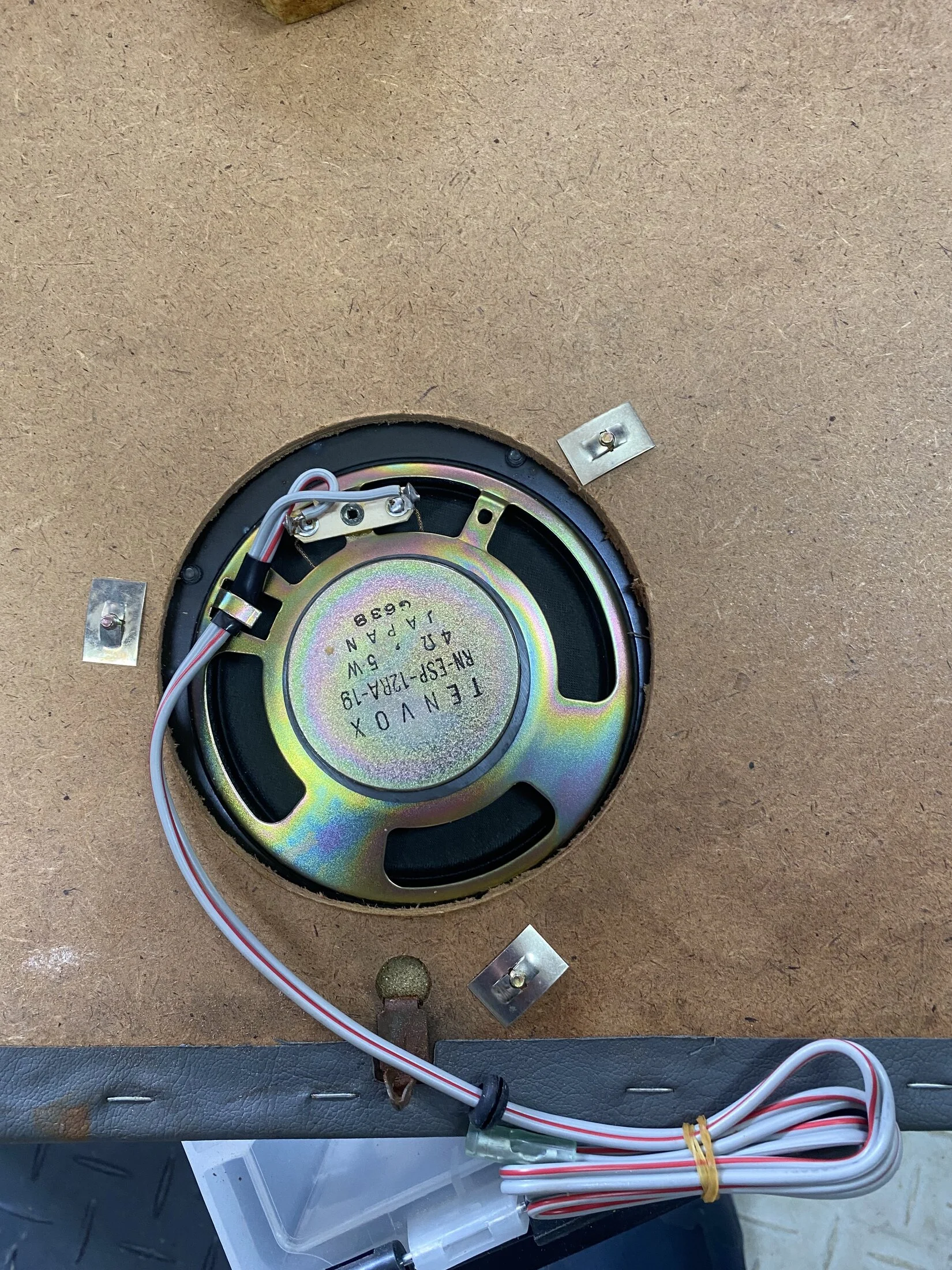

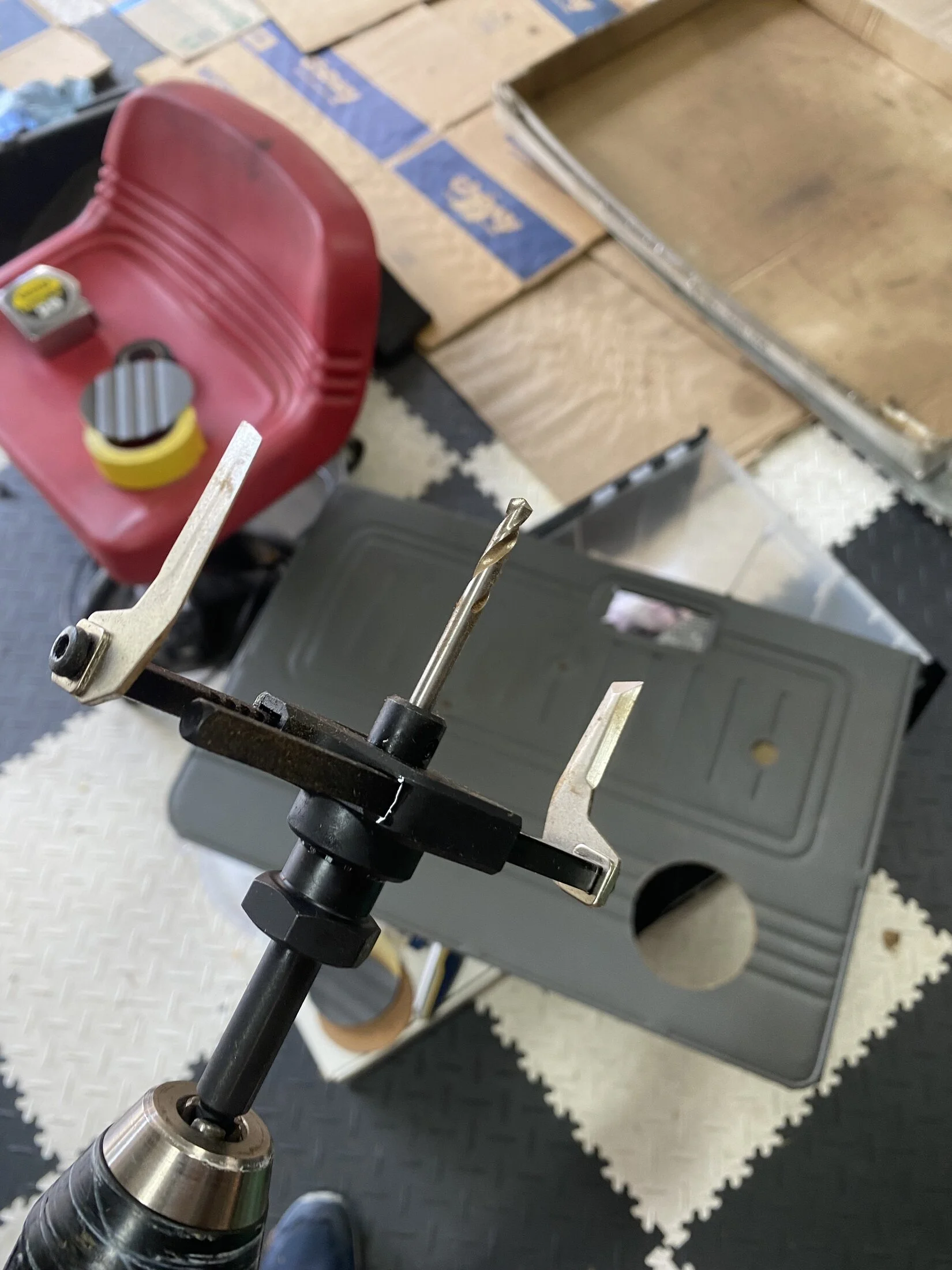

Some pictures of speaker installation
Instructions show it mounting here. Doesn't seem possible.

It's all hooked up and plays. I have a video but don't have social media account to post it. I bought 3 rebuilt tapes, Kiss - Rock and Roll Over, Rush - Farewell to Kings and Cheap Trick - Heaven Tonight. Kiss got the honor.
