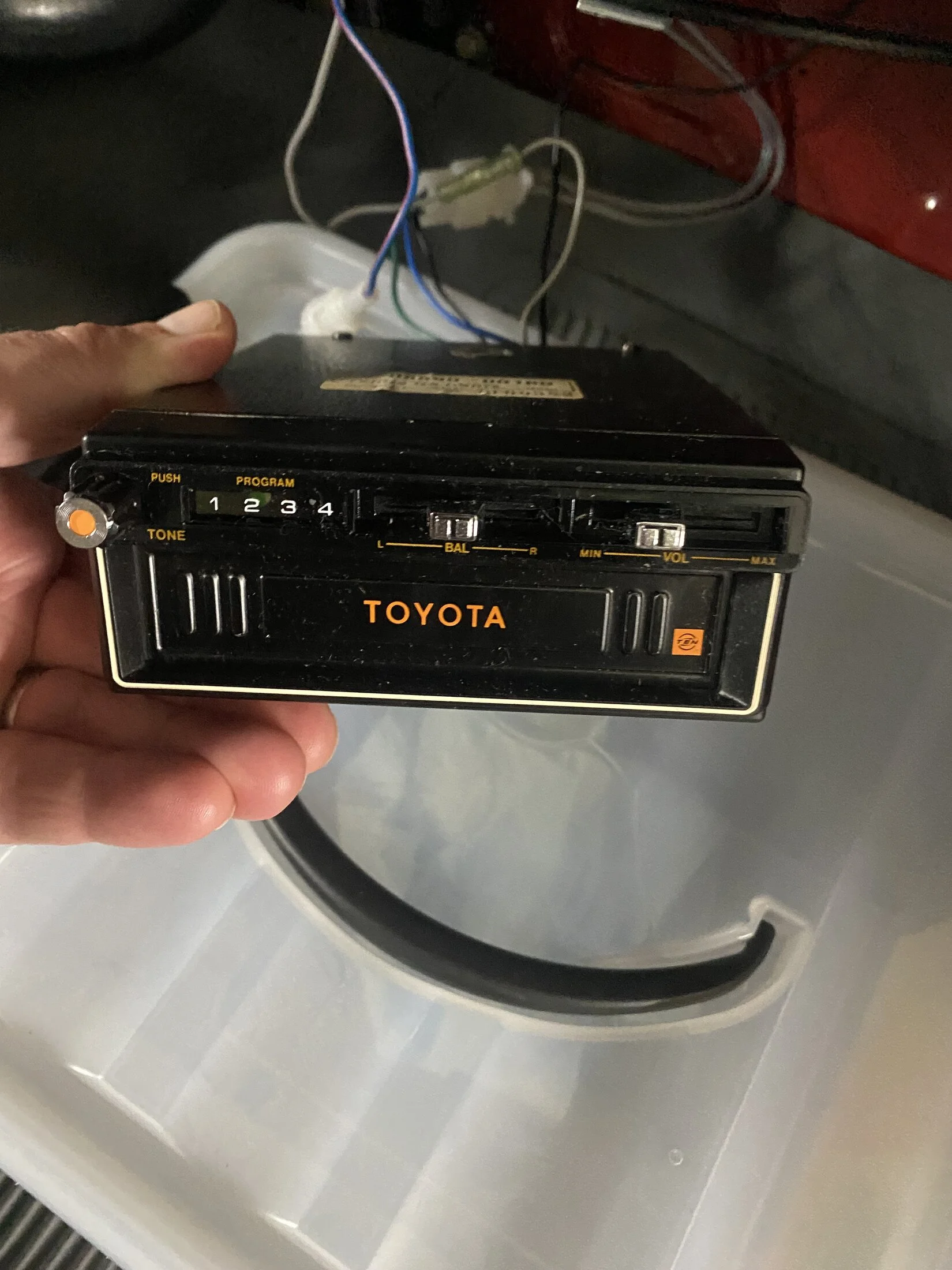

Toyota 8 Track Player

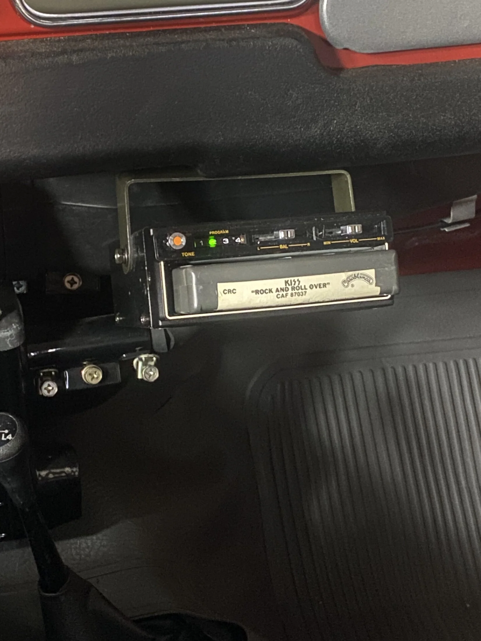

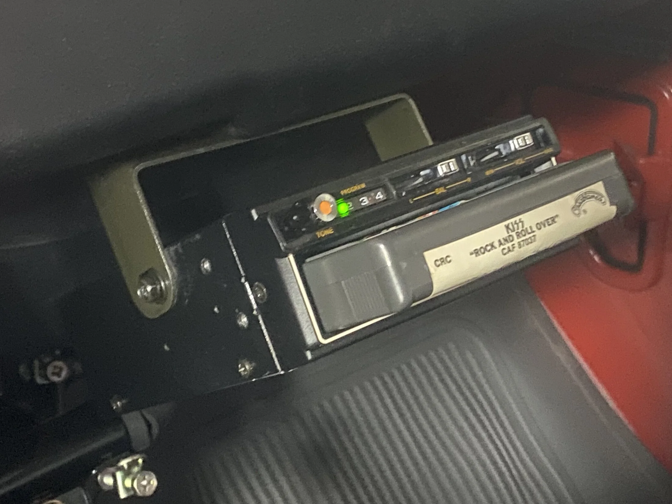

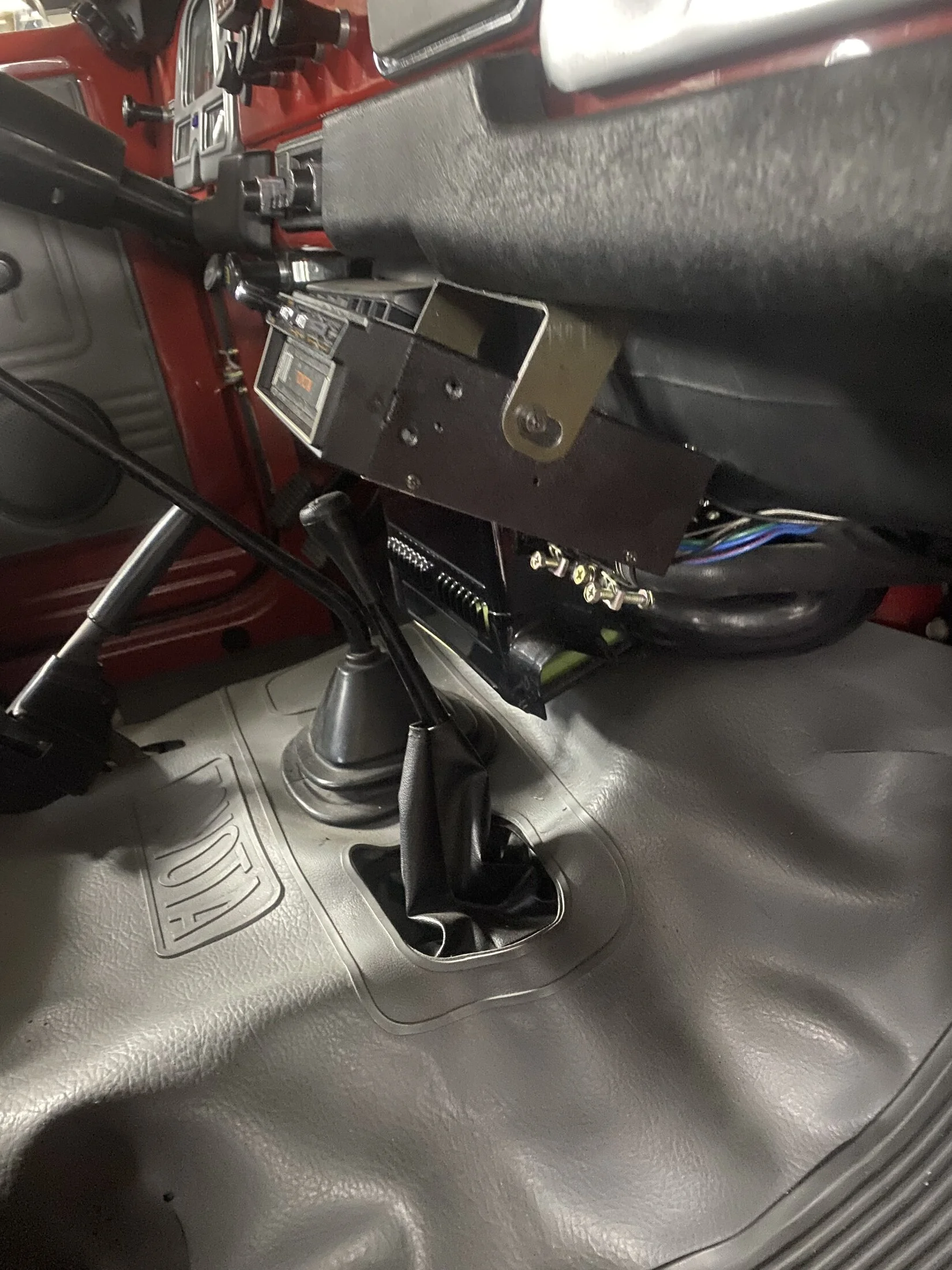

Some pictures of the unit installed. Used one of the screw holes in the bottom of the dash pad. Longer screw and nylon spacer. Also the kit comes with some erector set metal used to attach to the firewall. It uses the threaded post of the back of the unit. Same place the ground wire is attached.
