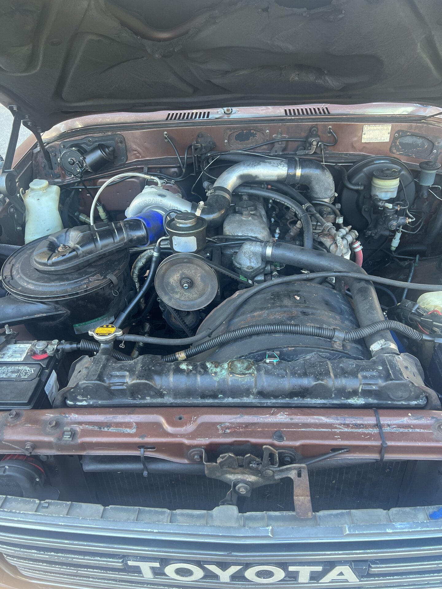

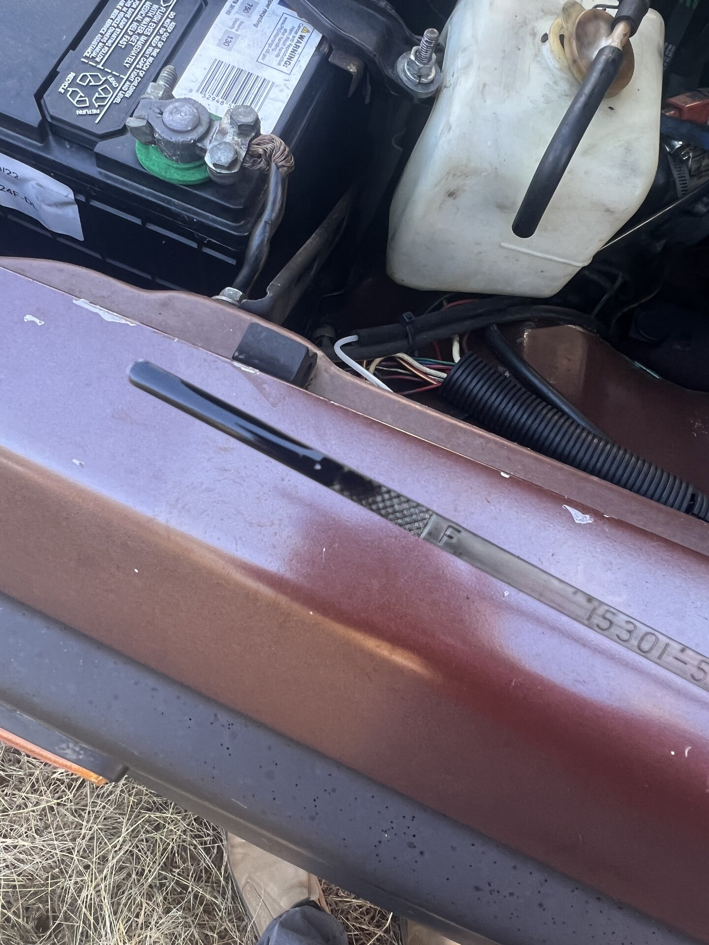

Fairly novice at these kinds of things. Recently got my hands on an 83 BJ land cruiser (Toyotas 3B Diesel engine). Got it for a good price so i new it’d come with baggage. Test drive was uneventful so I said why not and was buying from a mechanic. Been driving it around as my daily for the past month with no serious issue. Well, yesterday I get the ominous engine knocking noise and despaired over what this could mean until about a minute later, complete engine failure. It was not running hot and oil was not low (though looks like it’s been cycled through the engine a few too many times). Also, tried starting it this morning and black exhaust came out. I understand this could mean an issue with the internal combustion components but is there anything I can do diagnostically to rule out “easy” fixes before I jump to getting engine rebuilt/ replaced or scrap the whole thing? Thanks in advanceView attachment 3465312View attachment 3465313
Is it just me or is the silicone coupler from airbox to turbo not connected/sealed properly?
not even clamped.....
so def no
