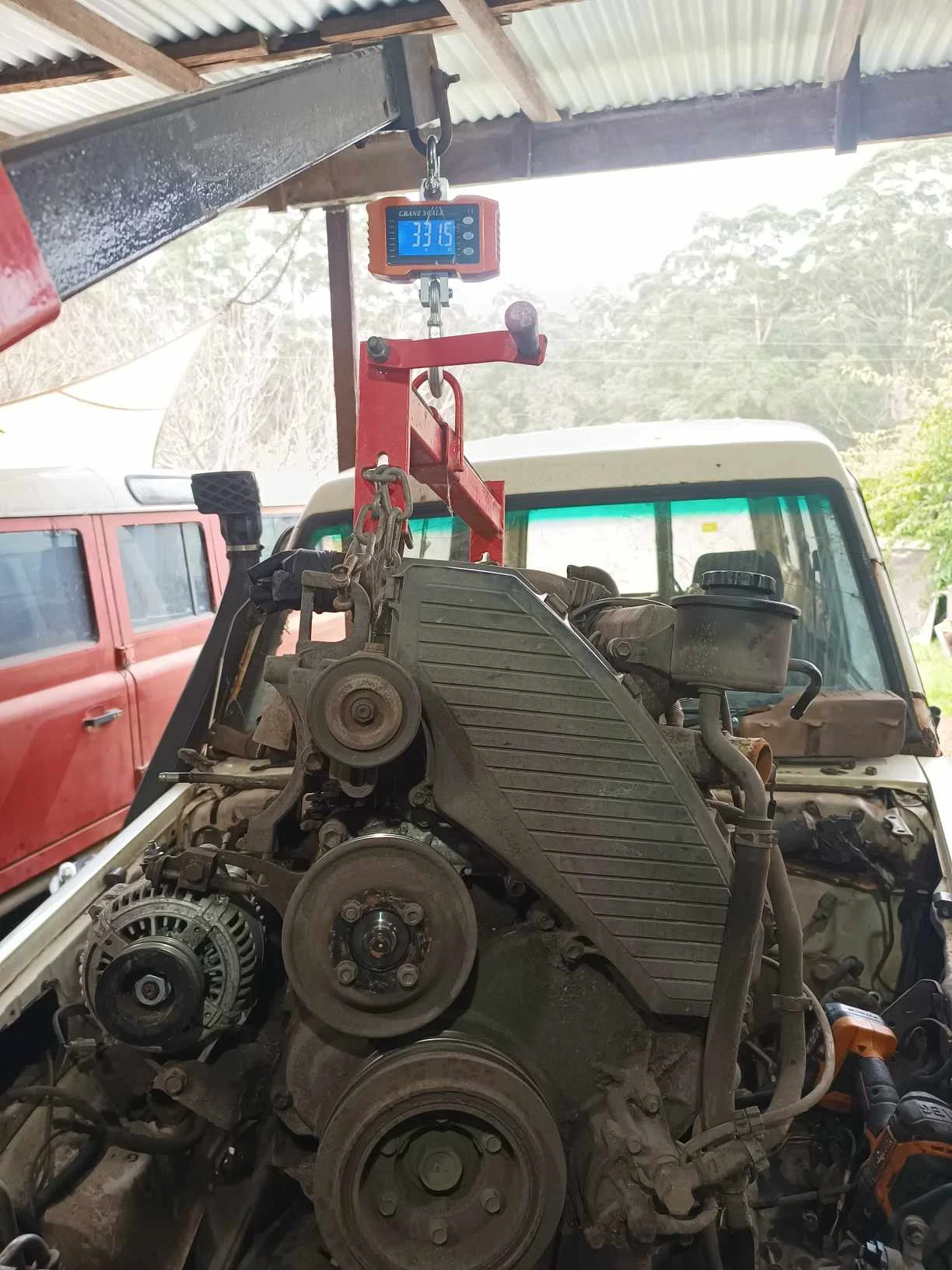

1HZ out of a HZJ75 troopy. Complete with everything as you'd remove it from the vehicle. Flywheel, clutch, alternator, manifolds, oil in the sump ect. Just missing the fan.
331.5kg/730lbs

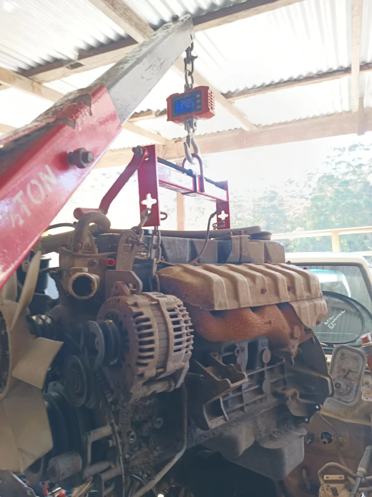

4BD1+T out of a Defender, Perentie bellhousing and sump. Everything on it, as above except with a turbo and fan.
337kg/743lbs
So I'd say they're about the same once the turbo comes off. Both weighed with the same scale, both zerod for the weight of the engine leveler.

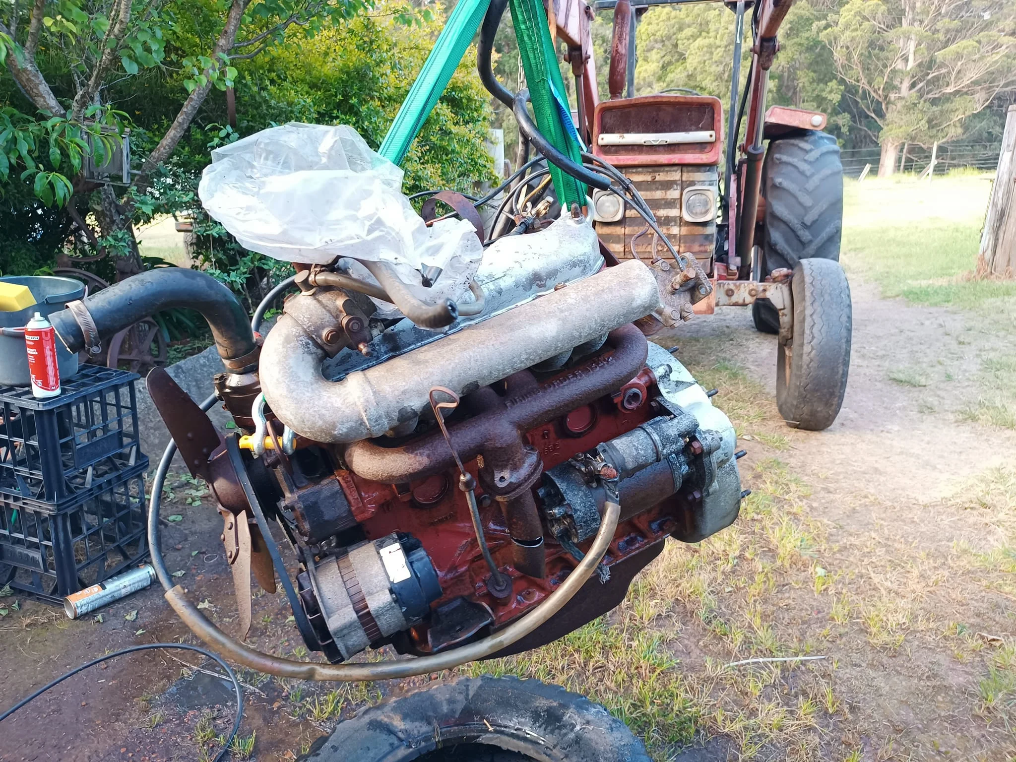

Not as relevant on here but I also weighed a Land Rover 2.25 diesel 5MB. Equipped as above except with the (quite heavy) starter motor. 275kg/606lbs
I might find one to weigh one day but you'd think a 200/300tdi is around the same given they're based on same block but with an alloy head and the addition of a turbo. Again, no one is swapping a Rover TDi into a Toyota but it was one of the competitive engines/models of the time.

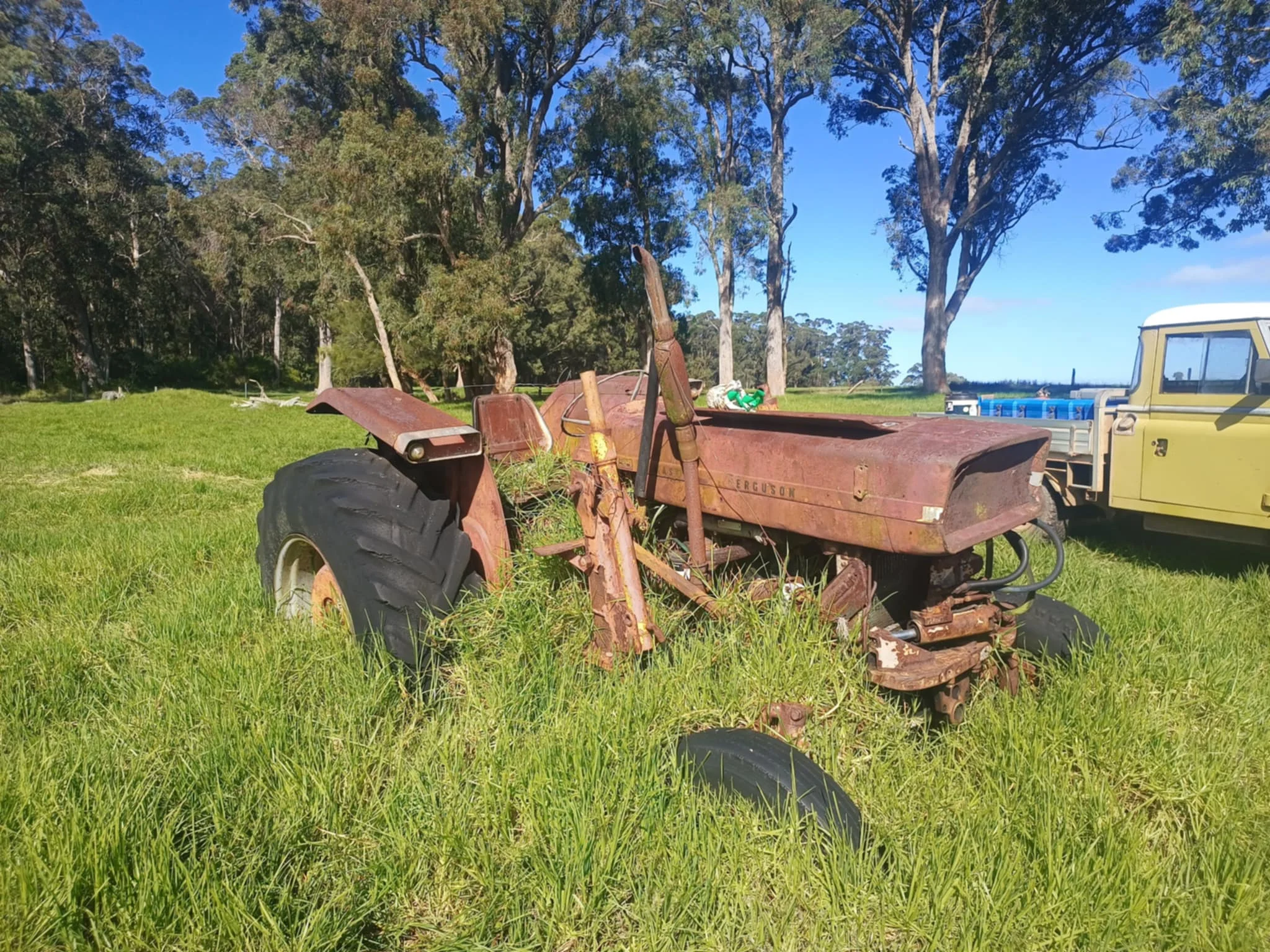

Is that an old 165 still doing the job?
Indeed it's a 178, the 165s big brother. It's quite the handy machine, I don't actually own any land but I don't know how I lived without a tractor! Topically, the South African Land Rovers with the 4.236 perkins would of been a fantastic machine for an industrial fleet in it's time. They're really to heavy and low revving to be a good conversion today.
There's quite a few 100 series masseys still earning their keep down here. Recently I got the job to revive a 165 and 175. I'd like to say these are the roughest vehicles anyone has paid me to work on, but alas.
