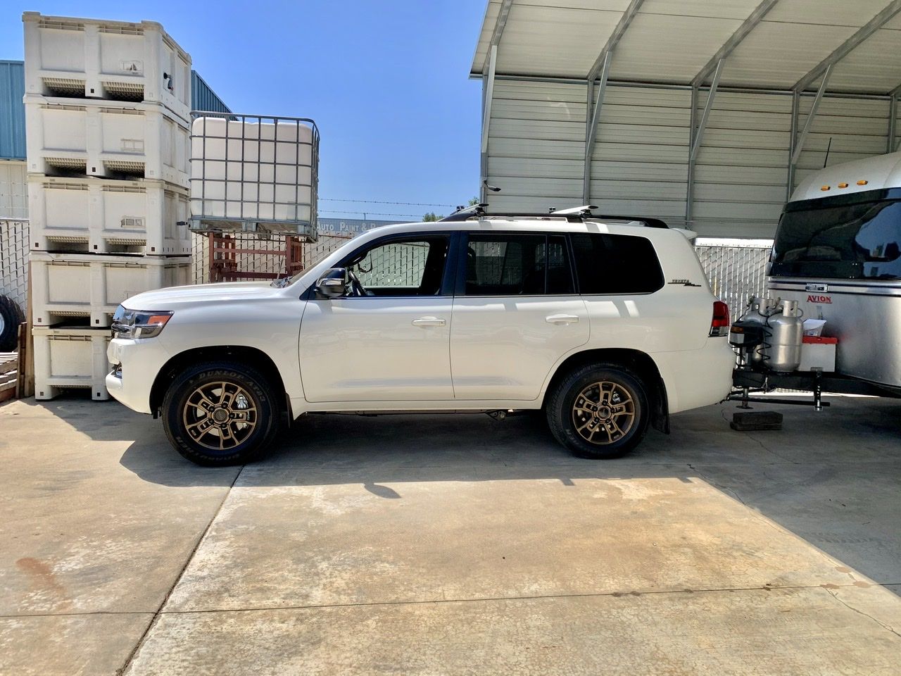

Installed new equalizer brand WDH on the new 2020 Heritage Edition.
Stock suspension. I towed this same trailer with no issues all over the western US with my 2005 100 series. That 100 did have medium OME suspension. I had an old WDH with the 90deg bars and chains. I thought I would upgrade. I considered air bags but might as well try without them before I go down that road and hack my bump stops.
Waiting on suspension till I do bumper & winch. Someday....
Trailer: 1974 25ft Avion LeGrande
GTWR: 7238.. Dry weight: 5363... Payload: 1875
Scaled everything about 10 years ago with normal load.
Trailer: 6440.. Cruiser (100 series): 5780.. Gross: 12220
I know I have sufficient tongue weight due to towing this tin can for a decade but don’t know the actual tongue weight. Water tank is centered on axles. Black tank is at ass end and it will not feel as stable if full. Otherwise tows real nice and uneventful. Even at 75+mph. Trailer suspension is a Mor-Ryde rubber block and bushing pivoting heavy duty thing. I rebuilt the rubber last year. That trailer is built like a tank. Everything is still straight and the wood cabinets close with a finger. Wind gusts.... semi trucks don’t affect the trailer much. I think it helps to have all those round corners.
No road test yet but all the numbers look good. After setting up hitch the rear dropped (at fender well) 1-1/4” and the front returned to same measurement (without trailer hooked up). Guess I guessed right on the number of washers for bar angle. This may just work! The trailer is slightly up at the tongue and that’s OK. A longer drop hitch and 1-1/4 lower would be too low I think. May need that drop hitch later whenever I do suspension and/or tires.
The numbers.. cruiser from ground to fender.. with normal load in back.
No trailer. Front: 34-5/8. Rear: 36-1/8
Trailer.. no WDH. Front: 35-1/2. Rear: 32-7/8
Trailer WDH. Front: 34-5/8. Rear: 34-7/8
