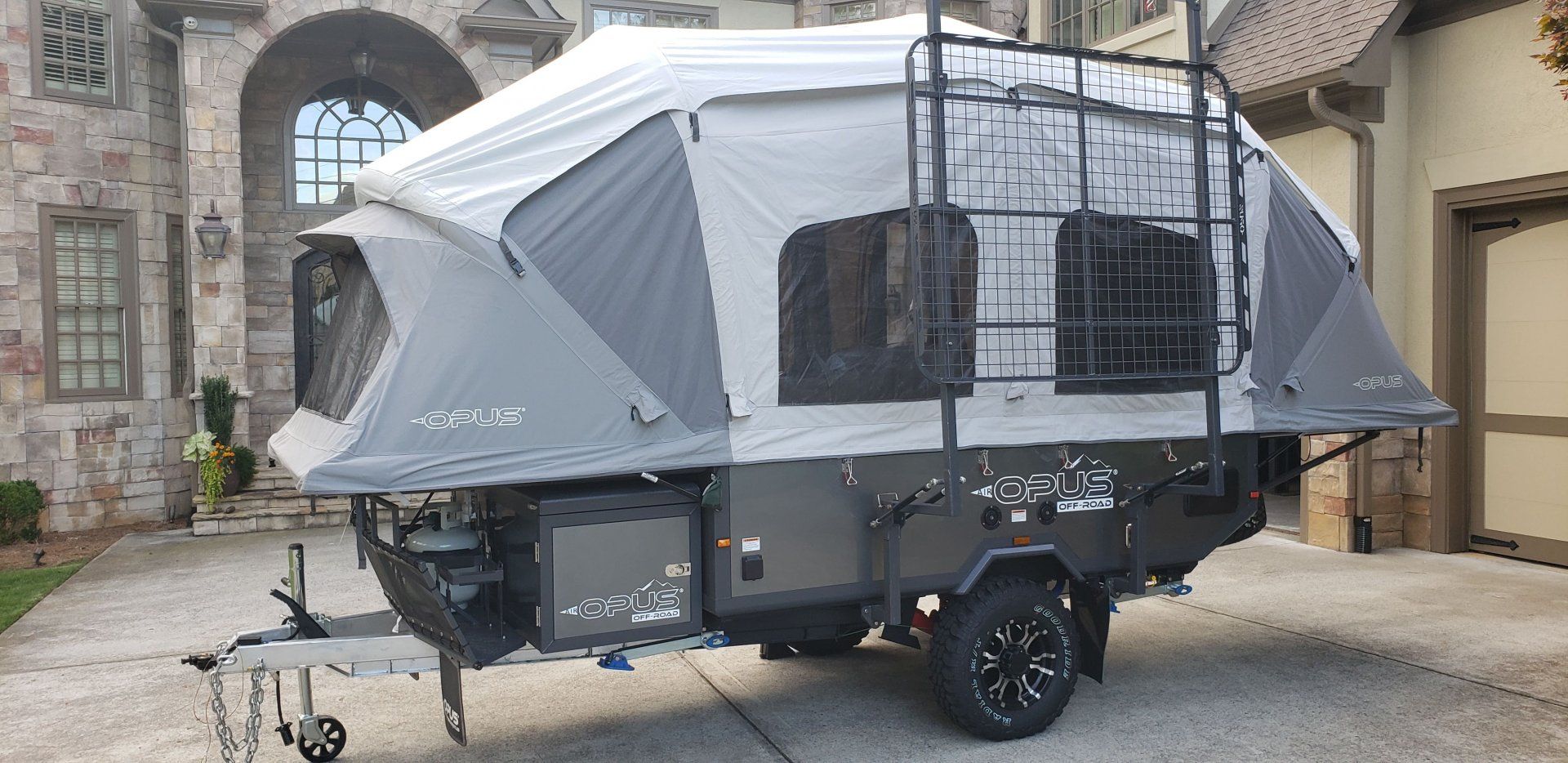

Here is my 2016 with OPUS 4. Great set up and trailer can go anywhere the rig can.
