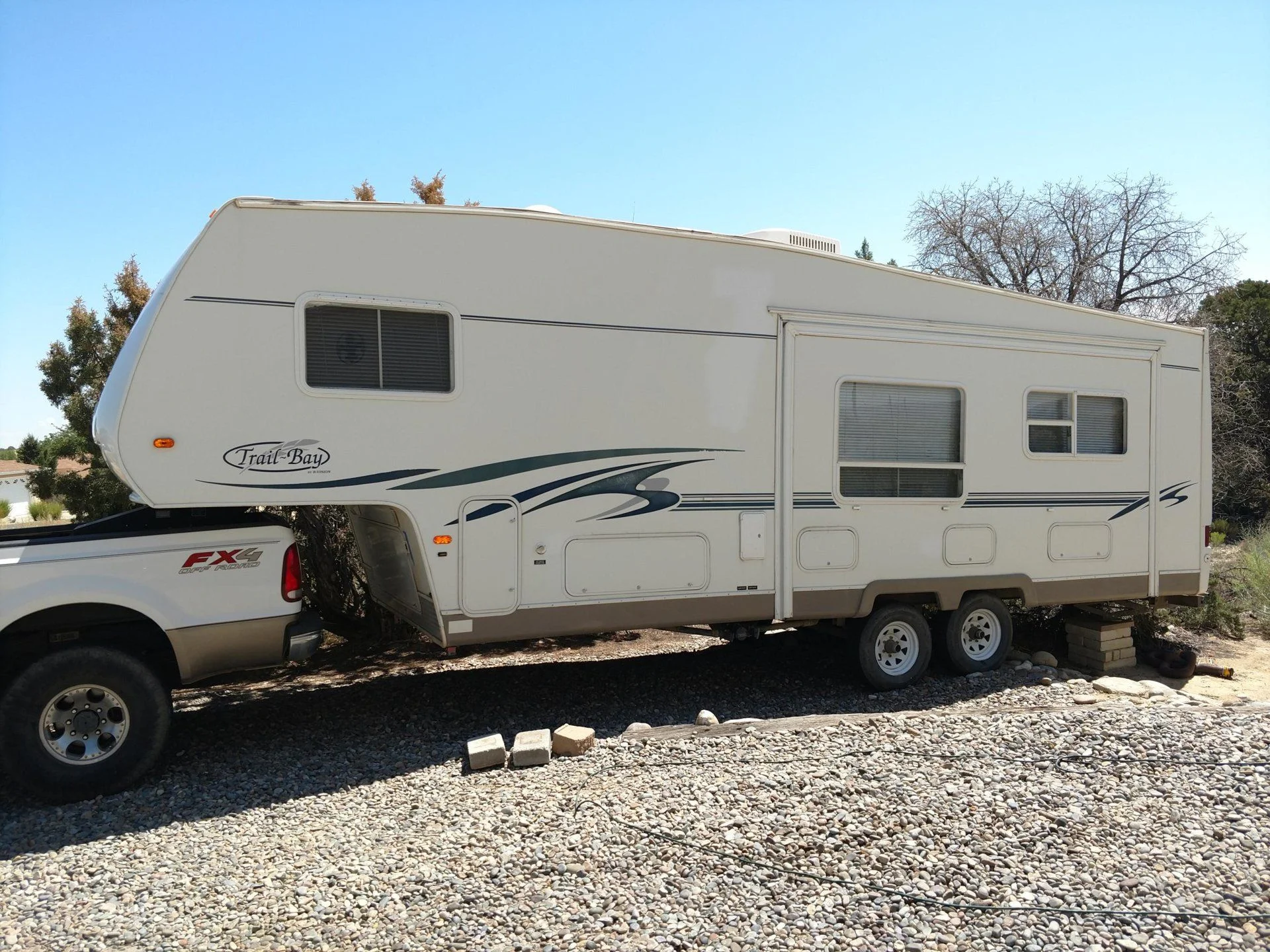

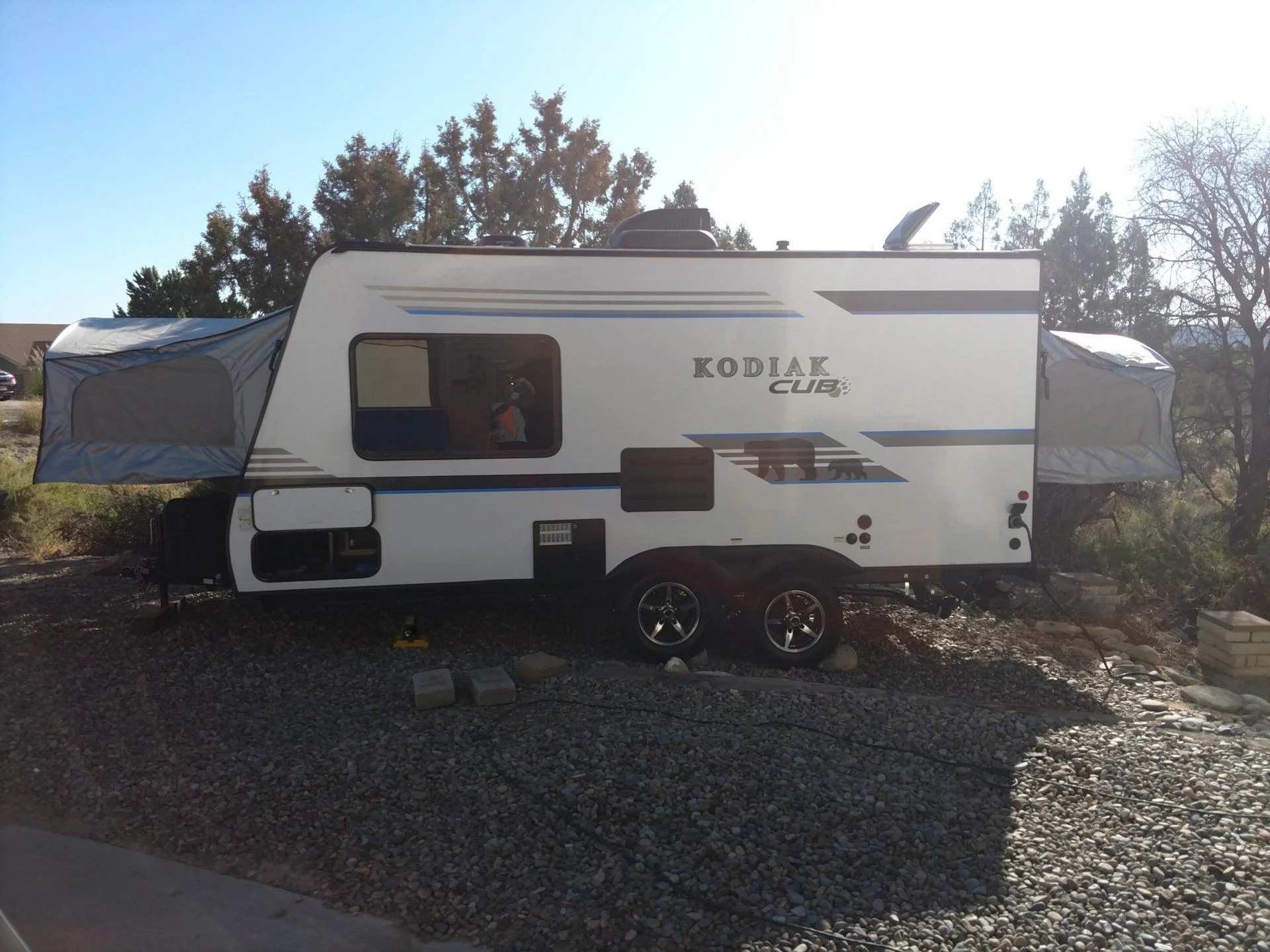

Traded in the fifth wheel on the hybrid travel trailer, lost about 6500lbs in 2 hours. I honestly can't believe how much extra stuff I was pulling around. Threw away or donated probably 600 lbs in random stuff we had shoved in there over the years. All the old tent camping stuff for example. Stoked to have a smaller and lighter trailer that I can:
A: Pull behind the LC and get to Ouray/Silverton/Moab within a couple hours, then go wheeling
B: Be able to boon-dock more easily
C: Not have the space to fill with old and uneeded and extra stuff
D: Be able to park, especially with the cruiser
E: Not have to deal with a 15 year old diesel, I could go on...
Before:
After: Felt cute, might delete later
Now if I can just get the yellow jackets nest out of the air conditioner cover before we go camping tomorrow. Yeeesh
I have a 80w solar panel that just plugs into the trailer. Any recommendations on 3500-4000 watt gas generators?

Nice trailer. I have a Jayco x19h that is very similar in size/weight. As far as the generator I would recommend the Honda 2200i. The only thing it can't run without modification is the air conditioner. You can buy a easy-start controller for your AC unit that controls how it draws amps when it starts up. It usually spikes to 20-40amps when starting but then settles at 17amps. The controller will keep it from going over 17, so the 2000W generator can handle it too (18.5A max).

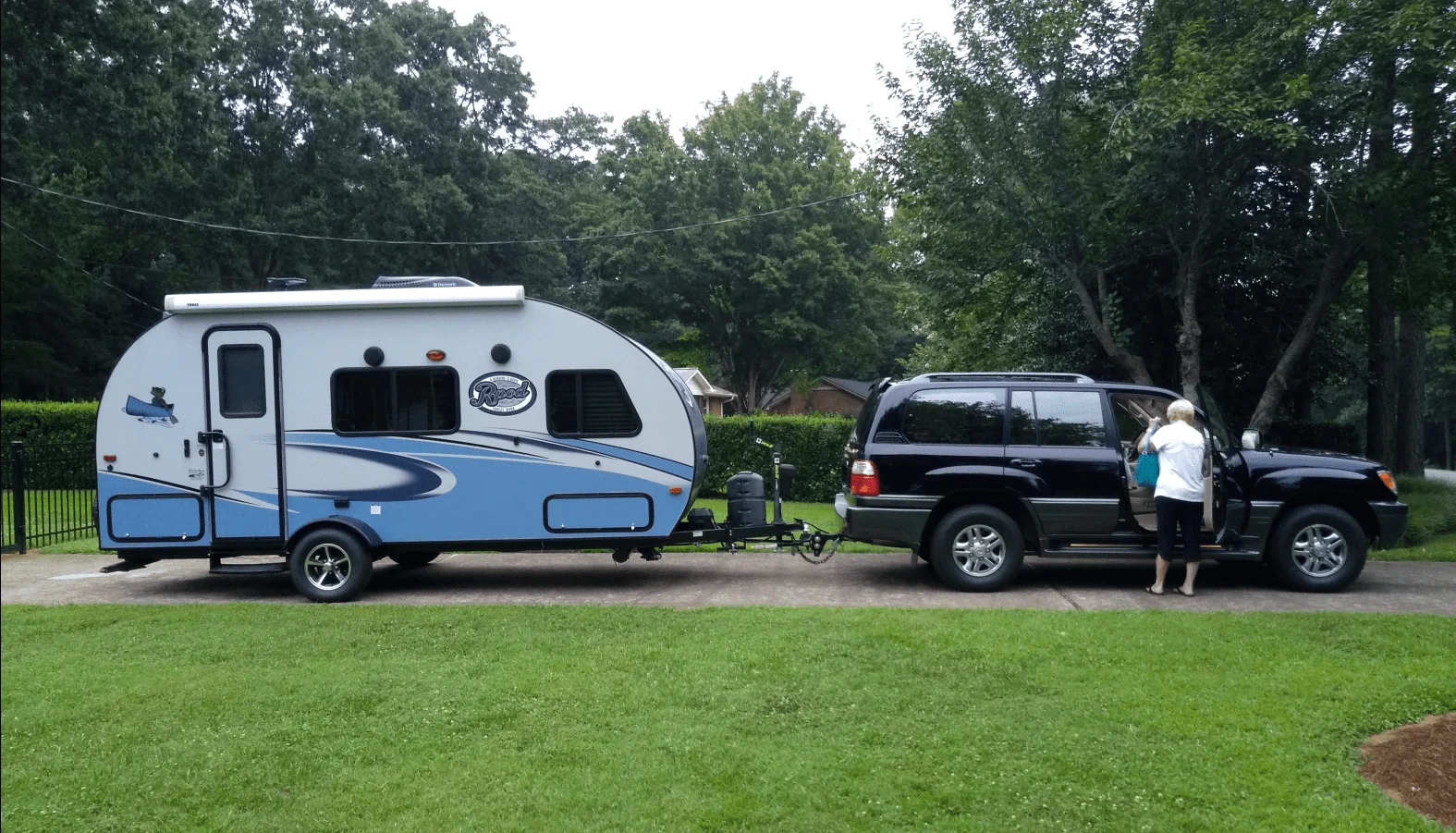

Pulled our Rpod 180 with our 2002 LX470 from central NC to Cherokee, NC.
6% grade for 5 miles on I-40 - curvy but 3 lanes.
I was not the slowest - did pass some 18 wheeler's.
4-speed Transmission.
Tekonsha P3 Brake Controller mounted in ash tray, Draw-Tite 7509S Hitch, Equalizer 0600 hitch (weight distribution, and sway).
Had to use 2-cd gear up and back down mountain.
Also faced a 9% grade on Hwy US 19.
Surprised that I got 12mpg - but I keep my speed at 60mph on flat roads.
Before I made this trip, I was really concerned, but after doing it I feel pretty good about my LX470.

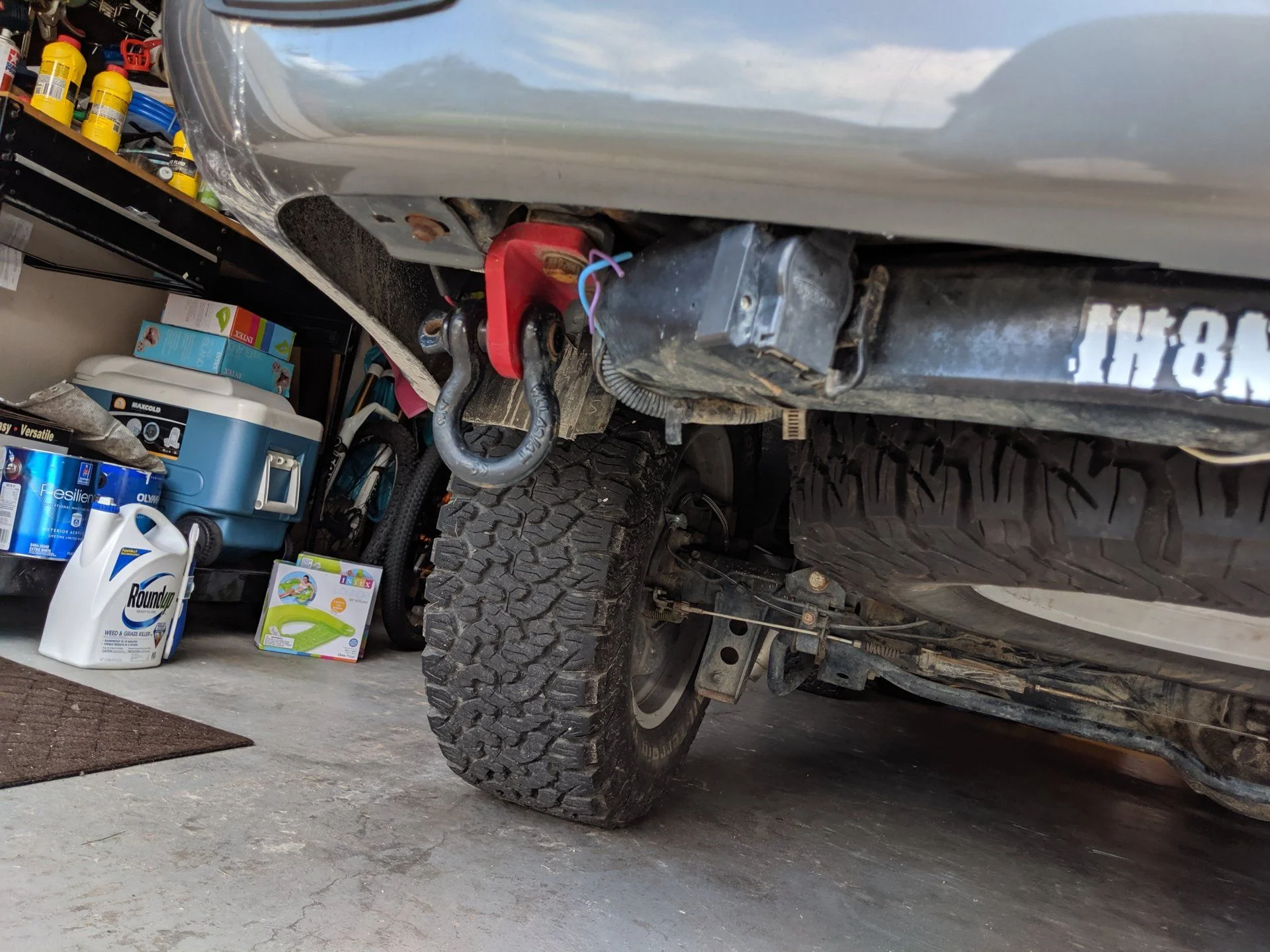

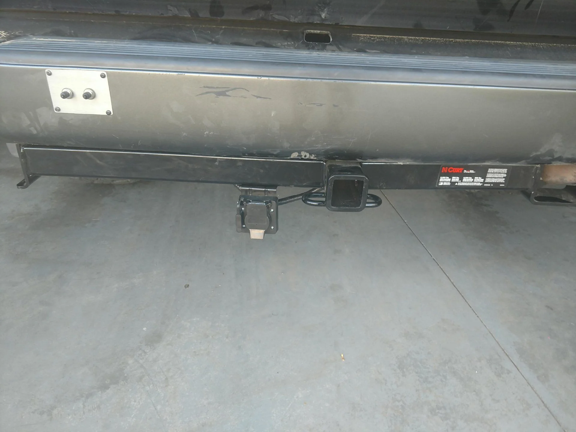

Hitch is installed but I need to find a better spot for the plugs. Was thinking since my rear bumper cover already has a couple of holes/deep scratches in it, just putting the plugs through the bumper. Has anyone done this, any other ideas on placement?
