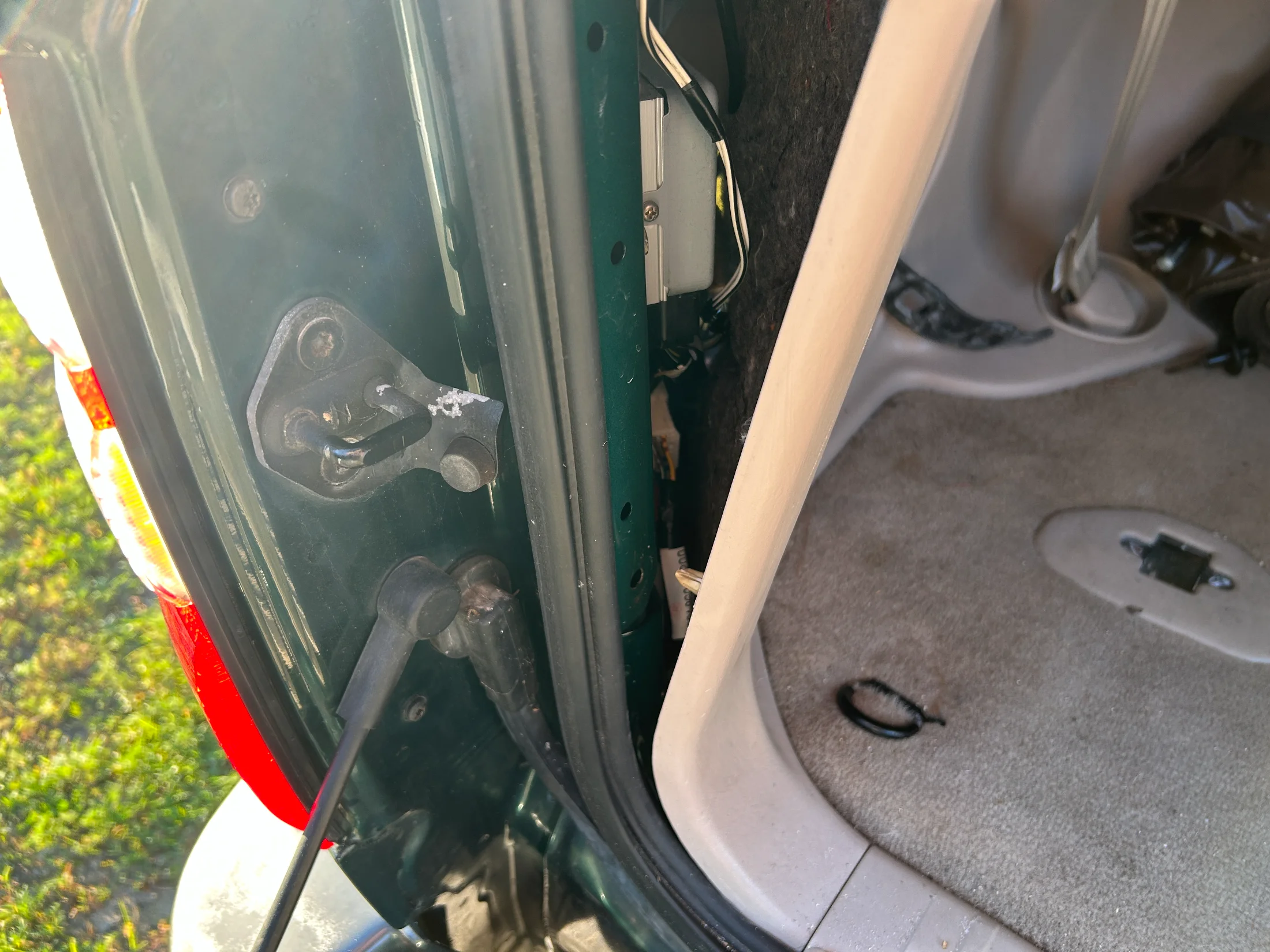

Then I took off the plastic cover inside the car on the rear drivers side to try to find this mysterious black box, but didn't see it. Does that not apply to models after 1999?

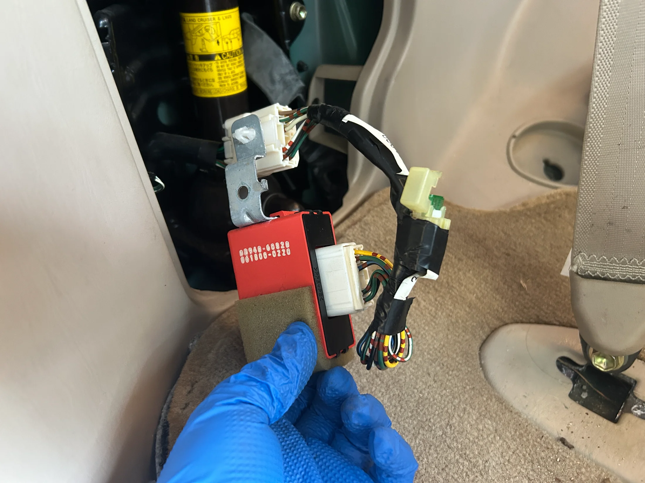

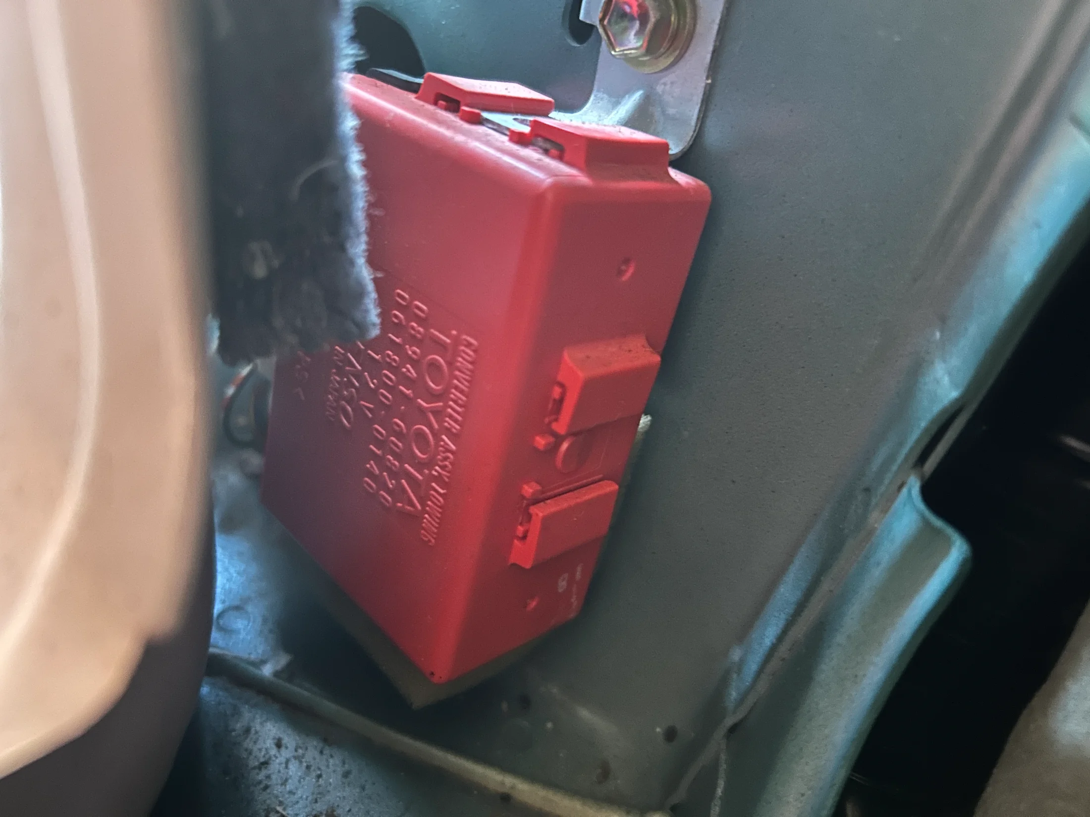

Ok, so a bit more progress. It looks like the 2000-2002 models have a different module, a red plastic box with a bunch of markings, also in that rear drivers side (photo attached):
Converter Assy, Towing
Toyota
08941-60820
061800-0140
These don't appear to be available anywhere except used on eBay which is too much of a crapshoot for me, so it's gonna have to be swapped to something else entirely. Can I just get something like is linked here in this thread or do you guys have specific recommendations that will work for the 2000-2002 models?

Ok so I dug a bit deeper and pulled off that red box. Turns out there's a 30a inline fuse that was popped in my case. I replaced it and all the pins in the 4 pin connector have power, so lights, turn signals, etc are working. I guess my little red trailer light converter box is fine.
You have to remove a few trim pieces to get to the 10mm bolt holding the bracket in, but it's not hard. Took me only about 20 minutes total to be able to see the fuse. Pic below. You can see the bright green fuse under that yellow-ish plastic cover.
