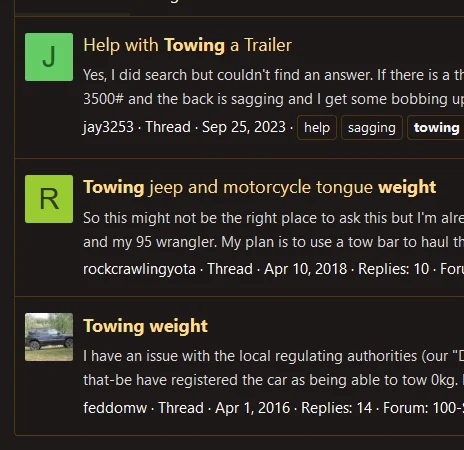

You can search for "trailer weight", limited to titles and the 100 section, few good threads to read.
Could also search for other similar things - "towing", "trailer". There's good threads with pics of people's campers.
