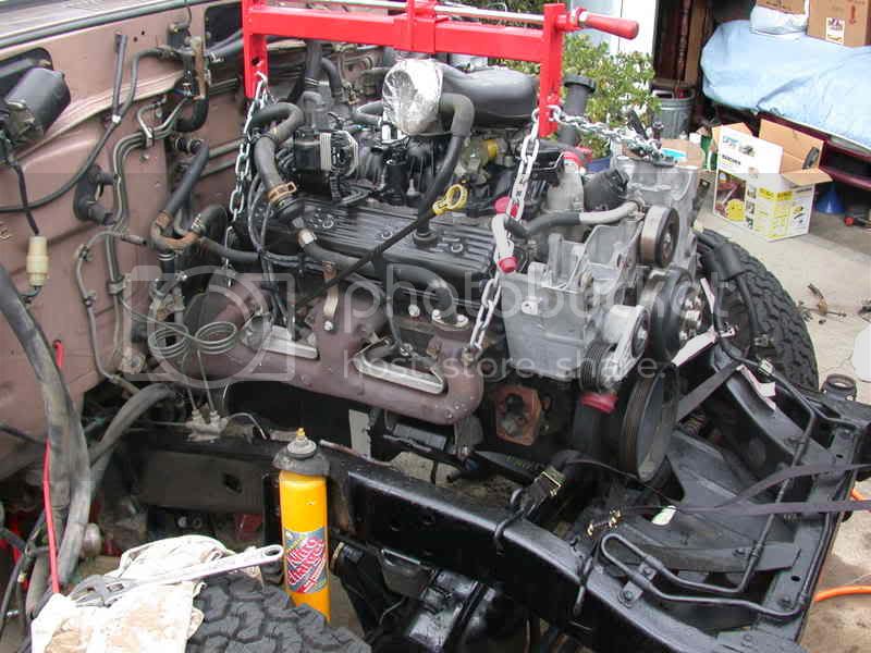

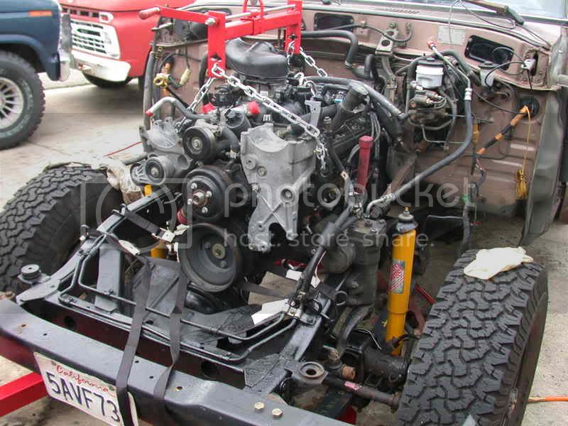

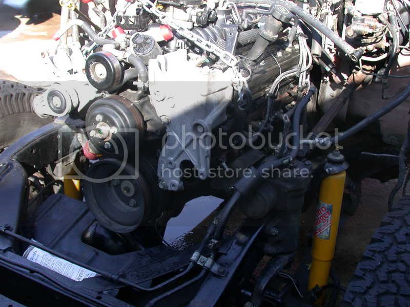

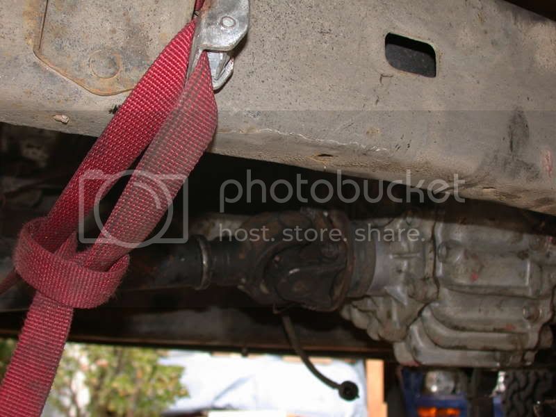

So today I bolted up the adapter to the bellhousing/motor (minus clutch/flywheel), and set it up to start fabbing motor mounts (building my own)...
Motor is offset towards the drivers side by about 3/4". I would have pics of the mounts tacked in, but I F-ed up making a set and had to restart from scratch- leaving no time to finish tacking/fitting before it was time to come to work (hopefully the cherry picker holds everything tight over night and nobody screws with it).

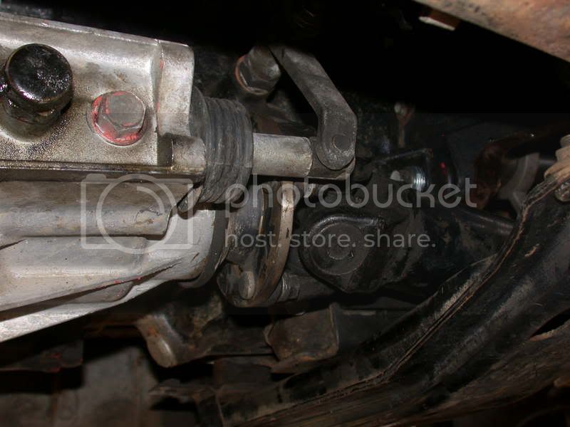

I know that the front pinion/d-shaft angle looks kinda steep, but it seems like I should get the rear set up as straight as possible, and I can shim the front axle if there's any issues- see pics.
Good thing is that I can get a fresh look at it tomorrow AM before I weld anything up...:beer: :beer: :beer:

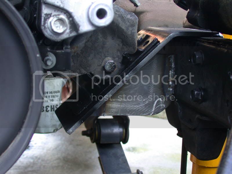

OK, so today I got the mounts tacked in and I'll pull the whole thing back out to finish weld sometime this week depending on when I find a clutch and flywheel.
Had to make two sets of mounts cause I F#@ED up the first ones.... I like these, simple and strong (no jokes about my upside-down welding skills, or my nunchuk skills).

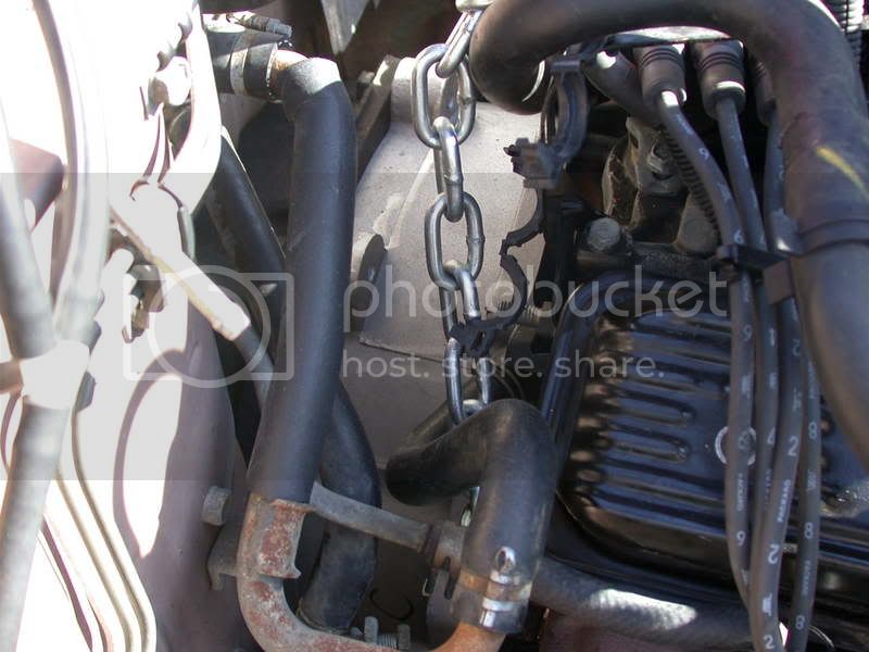

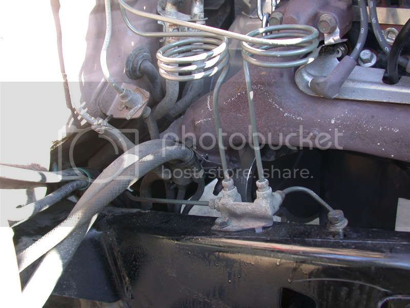

I thought I was going to be cool with the stock manifolds, but I'll be going with ramshorns from an early model- stock ones were very close, and I'm sure with some work they'd fit, but the ramshorns will end uup being less work in the long run... you can see the pass side is good, but the d-side barely hits the steering gear box (no pics) with the way I've got the mounts setup...:doh:

is that some type of air pipe in the passenger side exhaust manifold, or is it EGR? IF so how you plan to deal with that, and use the rams-horn type exhusts? I'm going to take the same route this summer and I've starting to acquire some of the parts. I bought a 350 Vortec too, which I've not received yet.
It's part of the EGR (both sides actually), you can re-route it to the collector, just past the exit or in the down tube section... just plug the old style air injection on the ram's horn and you're set. AFAIK, it's one of the only manifolds that will work with the swap AND please the smog refs...

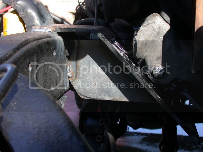

got the motor mounts finish welded and painted today. Also got the clutch/flywheel assembly in as well. I'm missing one of the springs that hold the bearing to the clutch fork from my Marks kit, so I'll have to order another one before I know if my clutch setup works or not, should be OK though...

anyways, here's a pic of the motor mounts, enjoy:D
