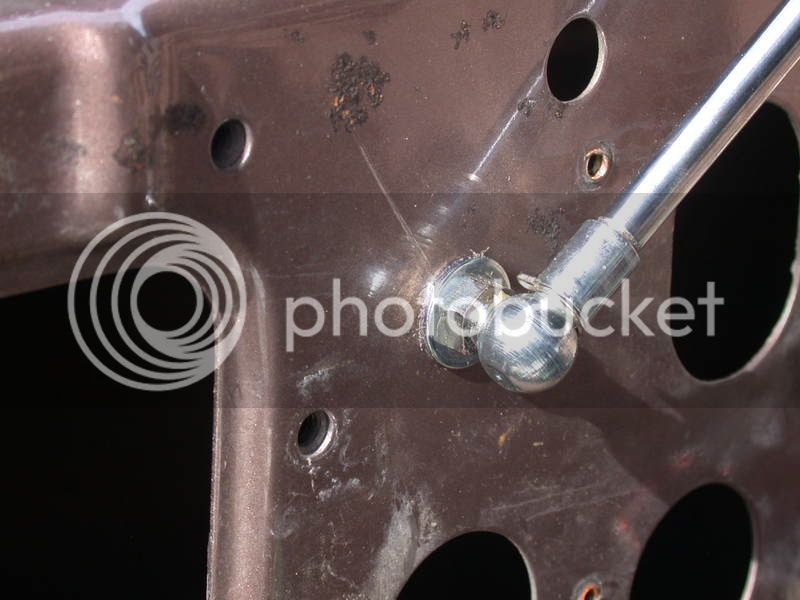

I got my ram's horns bolted all the way on, got my toyota water temp sending unit mounted, started the install on the gas-shock hood opening mod (see FAQ), figured out a few other small things as well.

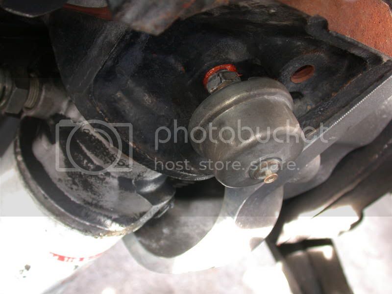

COOL TIP!- on the vortec motors, you don't need the bushings and adapters that Marks sends to use the toyota sending units (oil pressure and water temp). the toyota water sender fits in the chevy passenger side where the factory chevy one is (it's metric now.) a little RTV and it was good to go. also, a bushing can be used to fit the toyota oil pressure sender into the plugged hole just above the oil filter. I'll get pics this week if I remember. the vortec keeps it's original sending units for functionality, and the toyota gauges work too!

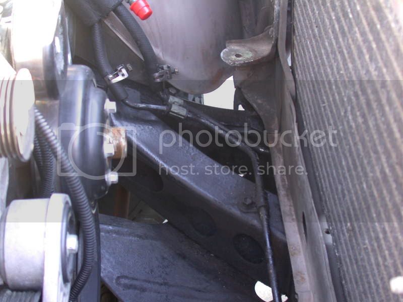

I forget who, but someone wanted a pic of clearance between the front of the motor and the radiator- pic below is obvioulsy without fan and radiator, but you get the idea- should be about an inch left or so after all is bolted up:) there's about 11" or so right now...

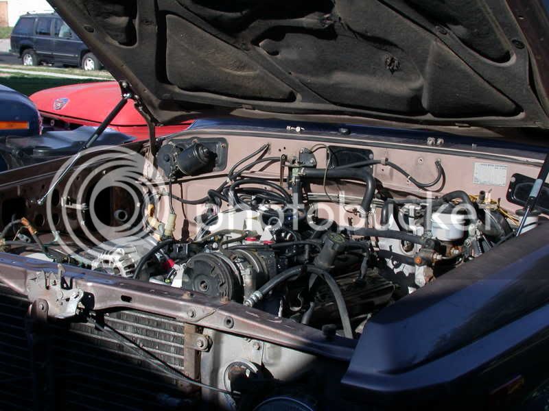

I see you installed the struts for the hood..how did all work out..how far forward did drill the holes?
Does it touch the front wiper arm at all ? :confused::confused:

I mounted the hood shocks about an inch forward of the small threaded hole and about an inch and 1/2 down from the larger one where you mounted yours. clears the wiper and works a charm...

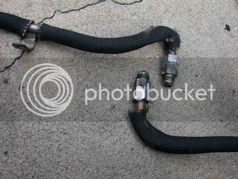

looks very nice. My compliments. I am a little intrested in how you wired that inline fuel pump you posted a pic of a page or so back. How was the fuel system set up before you converted? Pump in the tank?

I have a 60, so fuel pump was on the block... I just cut the hard line on the frame, took out some of the rubber line, then inserted the pump and filter with high pressure rubber line (filter before pump)- I'll put another filter near the new motor as well. wiring just comes from the new harness.:)

toyota oil pressure switch mounted above oil filter using a 1/4" to 1/8" bushing.
hood shock mounting location so that hood clears wiper arm.

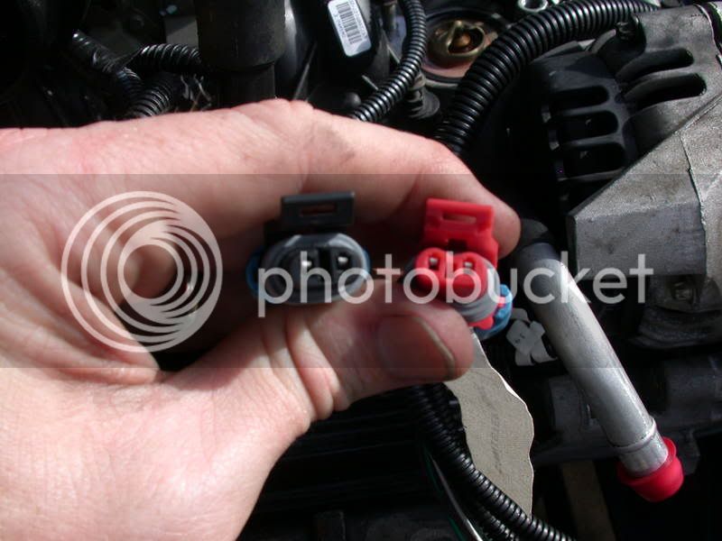

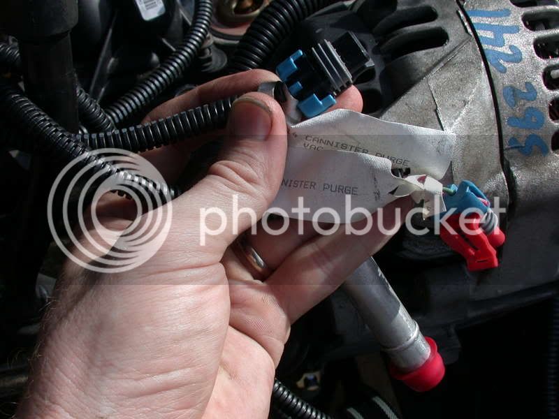

and a little question with having two purge connections? any ideas which one goes to purge switch on manifold versus purge switch on the canister? the harness has two different styles, but the pigtails on the canister and manifold purge are the same...:confused: :confused:

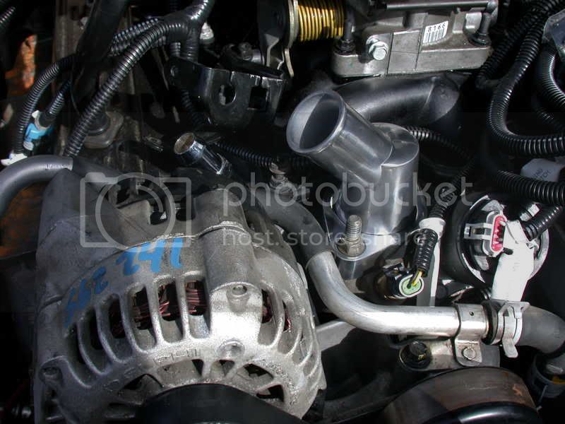

I was able to get some pipe fittings and weld up the stock EGR/AIR tubes that came with the vortec. I have some 3/8" female to 1/4" male NPT fittings that will allow the stock tubes to fit in the ram's horn manifolds and still look close to factory.
other pic is of my new swiveling water neck for the T-stat.
