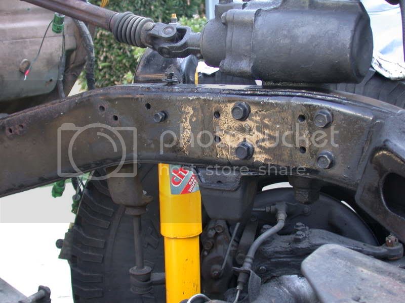

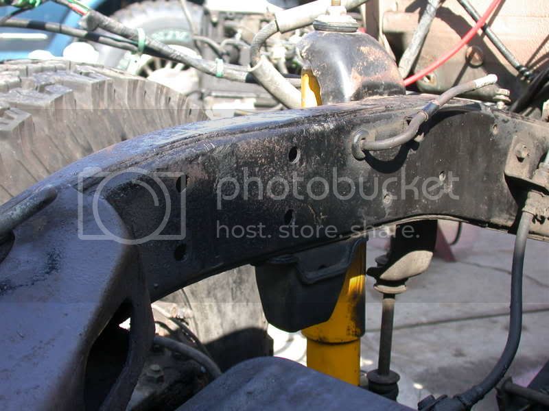

No pics today as I really didn't get much done...still waiting for parts:(
Got a cheap pressure washer at OSH today and used that to clean the bay, then rattle-canned the frame rails to keep any rust down.

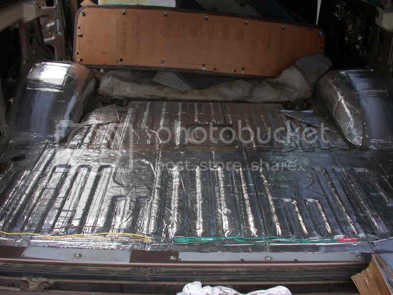

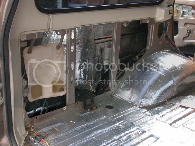

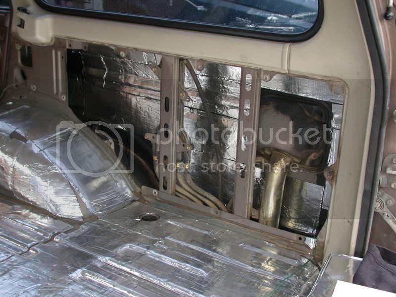

I did get some of the damplifier installed today though. I did the bed, rear quarters, rear doors, and wheel wells. I also put 3/16" Ensolite in the rear quarters and doors on top of the Damplifier, as well as new foil-backed padding under my nasty old carpet.
I can tell right away that this is going to be one of those mods that is SOOOOOOO worth the effort/cash, no more "ping" on the rear quarters- rather, there is now a cool "thud."
pics below, enjoy.
Very nice! I guess this made up my mind whether or not to put the damplifier on the 'inside' of the rear quarters or apply in on the back side of the panel itself. Any idea on how many sq. ft used so far?
Dylan
I ordered 100' and still have a LOT left, probably used about 16 sheets +/-, I guess that's about 30-35 square feet used so far.
skip putting it on the panels, it works best on the metal (source of "problem"), also the secondary material (Ensolite here) really helps with getting the "thud" sound.
Cool, that makes more sence. So the ensolite is more of a padding that goes over the damplifier and under the carpet?
So 30-35 sq. ft has done the rear doors, rear floor, rear quarters and wheel wells? If so that is perfect beacuse I have only purchased 40 ft so far.
