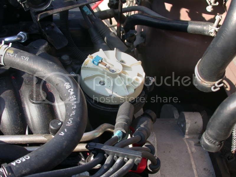

I'm gonna see if I can get a new(junkyard new, that is) dizzy assembly for cheaper than buying a new cap, rotor, and ignition module as I broke mine (dizzy's still OK) taking the freaking motor out so many times...

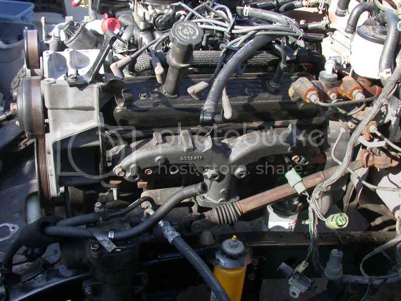

as promised, pics. in no particular order- rams horn manifolds, and busted rotor, etc...

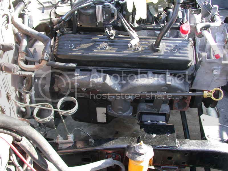

Looks really good man. Back to your motormounts, why the offset to the driver's side 3/4"? In looking at your picture, it actually looks a bit more. where did you get the motormounts to attach to the steel? Are they just standard ones anyone sells? Let us know how that Howell kit works out as well. In reading I like it better than the Painless.
yeah, it does look like more, but it's only 3/4" (steering makes it look tighter i think)- I made the motor mounts from some plate steel, a vice, a torch, and a BFH. welded the tops to the frame, then welded the gussets in, drilled and mounted the GM mounts (any generic GM cradle-mount will do) to the plates...
plates are 1/4" and gussets are 1/8" WAAAAYYY overkill, but they work.
Motor is offset for clearance and driveline-alignment issues.

philos1, can you post a picture showing the side of the engine where we can see the distnace between the front of the einge and the radiator?
are you running new OEM "ramshorn" manifolds is so what part number?
Or did you get some from NAPA or somewhere for an old vette or truck?

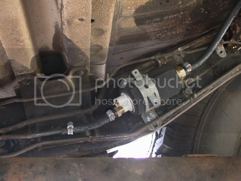

So I got some more work in today...
put in my junkyard "new" distributor.
started laying out the harness for a rough fit (I'll get all plugged in, then re-route for a clean look when it fires/runs).
mocked up the K&N intake kit- might be too tight, so I'll wait for the hood install to be certain on this one.
Elbert- I'll snap some pics of radiator clearance when it's installed with the fenders, etc over the next few days. Manifolds were $50 each from AA1 auto.com or something- Chinese, but they're good castings and look pretty nice. plus they're brand new.
pics are of the start of wiring and of my fuel pump placement- notice the use of the stock coil mount for the fuel pump:D :D :D dirt-can recycling at it's best.

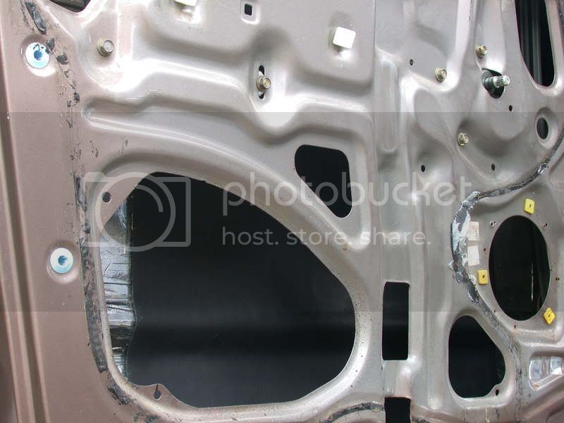

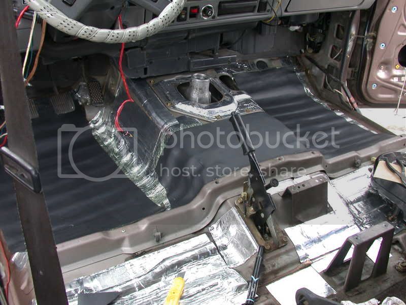

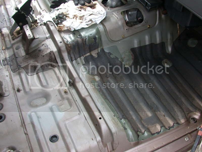

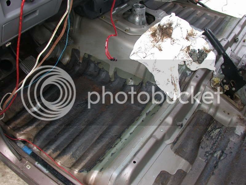

Not much going with the wiring and plumbing right now. BUT, I did finish the Damplifier install up front. I did up to the end of the carpeting and under the front seating area. I did not do under the rear seat as I had originally planned- if the noise is still bothersome, I'll go back and do it.
I put ensolite over the damplifier in the main section of the doors, as well as where your feet go on the floors/ over the tranny tunnel. I additionally put foil-backed carpet padding over the ensolite on the floor.
everything should be nice and quiet now, and as soon as the rest of my parts are in, I'll have the vortec swap done and driving.
Oh, I also got a tuffy console that I'll put in later...
bottom two pics are of the floor after I cleaned all the s*** off it- old coins and pesos from past trips to baja, some potato chips, fries, lots nad lots of CRAP!
pics below, enjoy!
