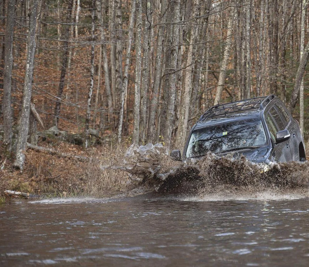

I probably just got lucky, but I've driven in water coming over the hood conditions twice now with no snorkel and didn't do any damage. I didn't plan on driving through these crossings and had no idea how deep they were going to be. Having momentum and a bow wake matters. I keep in hearing the real purpose is to get clean air in dusty conditions.
^ This is why I did it. Sometimes you misjudge. Sometimes you judge correctly but still get surprised (i.e. by a hole).
A bow wake will help keep the water low in the engine bay, particularly since our vehicles rely heavily on electronics which don't like getting wet. The diesel cruisers are better for this but even still water will quickly short out circuits. Also, don't spend a lot of time hanging around in the water as once water is hood deep there are a lot of places for it to start seeping into the cabin.
