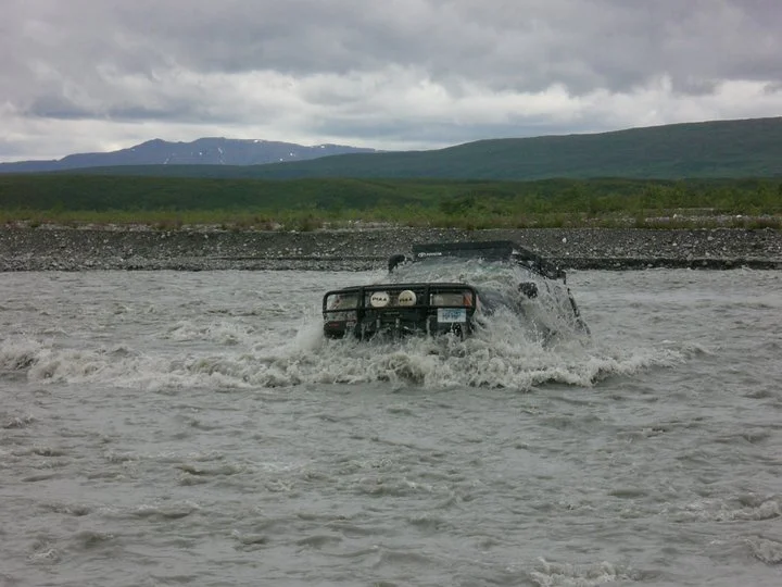

This picture (which I have posted a few times in different discussions) illustrates the only shortcoming that I see of this approach. This does not happen often, but the '80 series and the 100 and 200 too all suffer from a tendency to roll water across the hood and up the windshield when the hood is dipped unexpectedly with even moderate forward motion.
I want to try and build a home brewed version of this type snorkel which leaves a little bit of space between the roof line and the intake, as well as the ability to rotate the intake backwards while on the trail to address this issue.

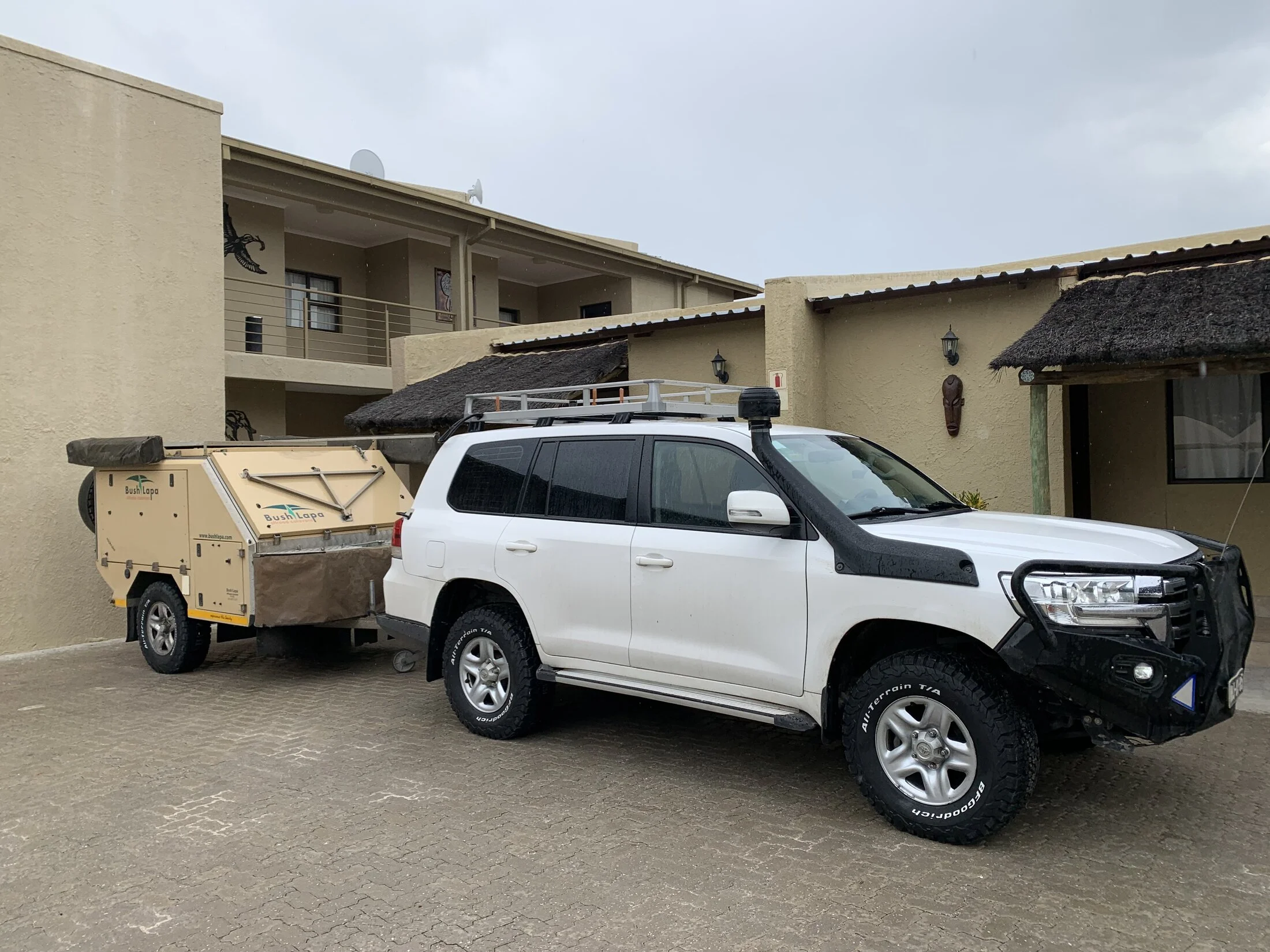

This may be a dumb question/comment, but does anyone make a fender grate/screen, snorkel? In other words, instead of having the intake go all the way to the roof line, just have it go to the top of the fender and end there in a grate. I think this option would work for 99% of drivers. The deepest river crossing, I have ever done was water hitting the top of my wheel well. I know others do much more, but once you exceed the hood line, you are likely F'd anyway.
Having said that, this one looks very unobtrusive compared to most I've seen
Which one is this?
Looks like this one, Monsterservice Snorkel .
Best looking option in my opinion. My concern would be airflow restrictions with its slim design. Considering Safari (ARB) has a specific snorkel for the 5.7 gas motor 200 that is larger in size than their other model i'd be hesitant going with such low profile style.
