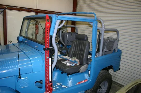

My HJ one is on the way, I can't weld either and Powder coating does cost $$$ however here is a pic of my 78 TA, I drop the cars value about $3k adding this however I am a bad driver so it is worth the $500 you will spend just take ya time and look around..

Just because we're discussing it.... This is the MetalTech Jackson Cage that I talked about earlier. To make the jump seats fit the original holes, I cut some holes in the base plate for the "feet" of the jumpseats.
Here they are installed in the truck...
I wouldn't wheel with people in the jumpseats with just a Jackson cage, but we didn't build this to be a hardcore rig anyhow... I also put frame ties in under the A and B hoops, so I really wasn't concerned with cutting holes in the base plates for the feet, but I wouldn't mind either way.
Dan
