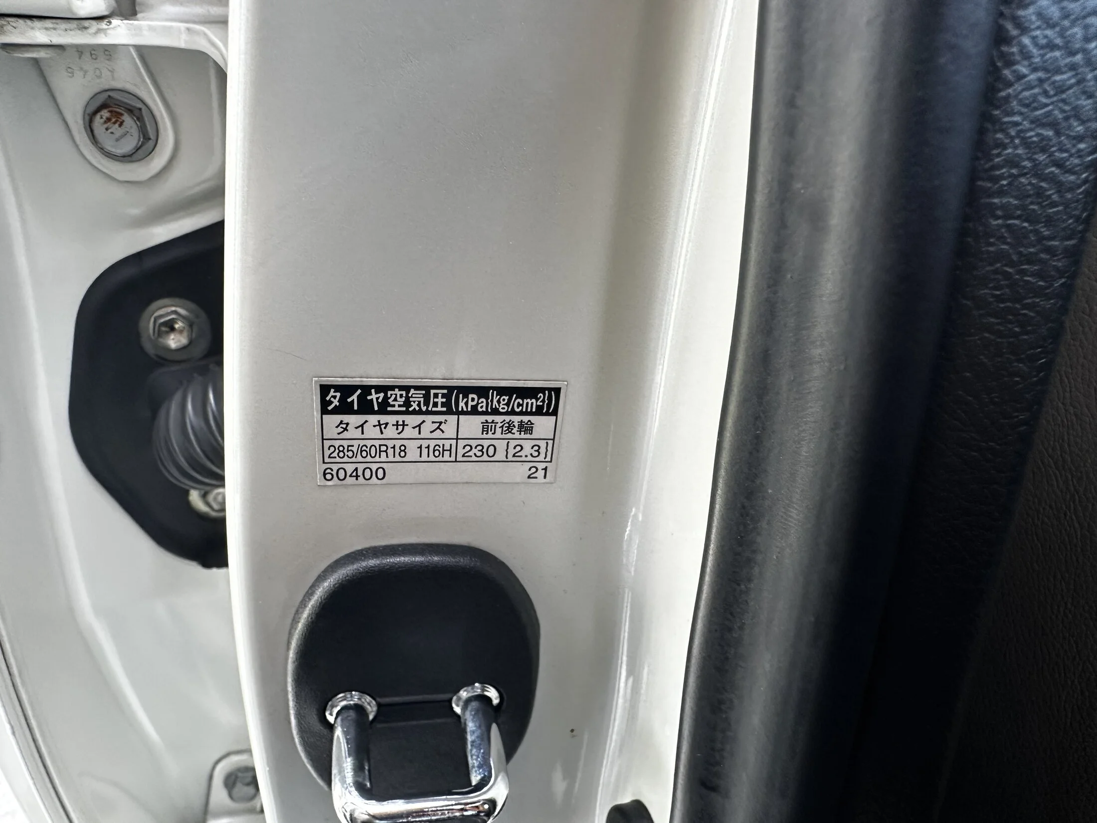

According to the tyre pressure label it is 33psi for front rear. That being said is the RCTIP still remain 54psi Front/ 56psi Rear? Thank you.
Thanks for the additional info.
In view of that, the RCTIP is 55psi Front and Rear.
HTH

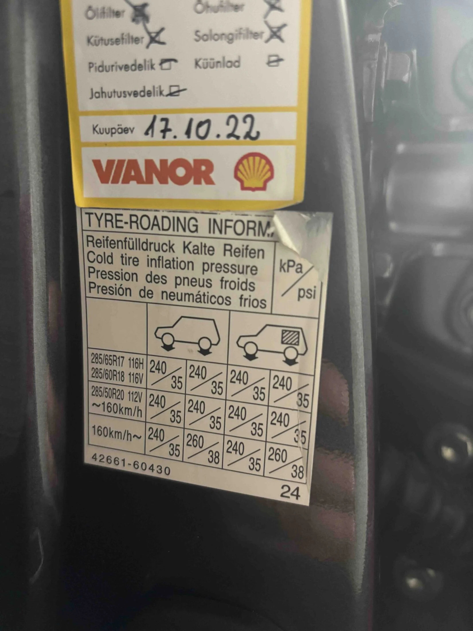

I need to see a picture of the TIP (Tire Information Placard) found on your driver's side door frame which shows the OEM tire specs with the recommended cold inflation pressures.
Then I can give you the RCTIP for those ISO-Metric 285/65R17 SL 116H tires on your LC200.

There you go! My car is completely stock, no modifications.
Got it!
The RCTIP for those ISO-Metric 285/65R17 SL 116H tires on your LC200 is 35psi F/R.
HTH
It’s almost like Toyota put the RCTIP right in his door jam.
Also, that TIP really throws a monkey wrench into the narrative of this thread. Lots of cool stuff to glean from it.
#1: Over 100mph (160km/h) use has a recommended tire inflation above the max ISO inflation pressure of 36PSI. (this doesn't really matter, but just pointing it out)
#2: Which of these lines do you decide to use for your RCTIP. The 112 SL @ 35PSI rating (2392lb) is far different than the 116 SL @ 35PSI rating (2668lb).
#3 Lets say you were looking for RCTIP for a P-Metric P285/70R17. For the new tire using the 116 lines would net a RCTIP of 31PSI, but if you use the 112 line it would be a RCTIP of 26 PSI.
I would argue both would be too low, and I think this card proves Toyota agrees.
From the TIP, Toyota obviously cares more about the inflation level of the tire than the load carrying ability of whatever the suggested PSI are. To prove that point further, we can look at just the tires on the TIP card. If we take the 116 rated tire as the baseline, then the Toyo pamphlet would say you can't even run the 112 rated tire on the same vehicle because the max load carrying ability is below the rated load of an 116 tire at 35PSI. If you flip it around and make the 112 the baseline, then the RCTIP for a 116 rated tire would be 30 PSI, which is clearly not how Toyota decided to rate it. They obviously feel that this platform of vehicle requires at least 35PSI, pretty much no matter what tire you run.
Since "this platform of vehicle" is the European Diesel version of the LC200, I agree.
