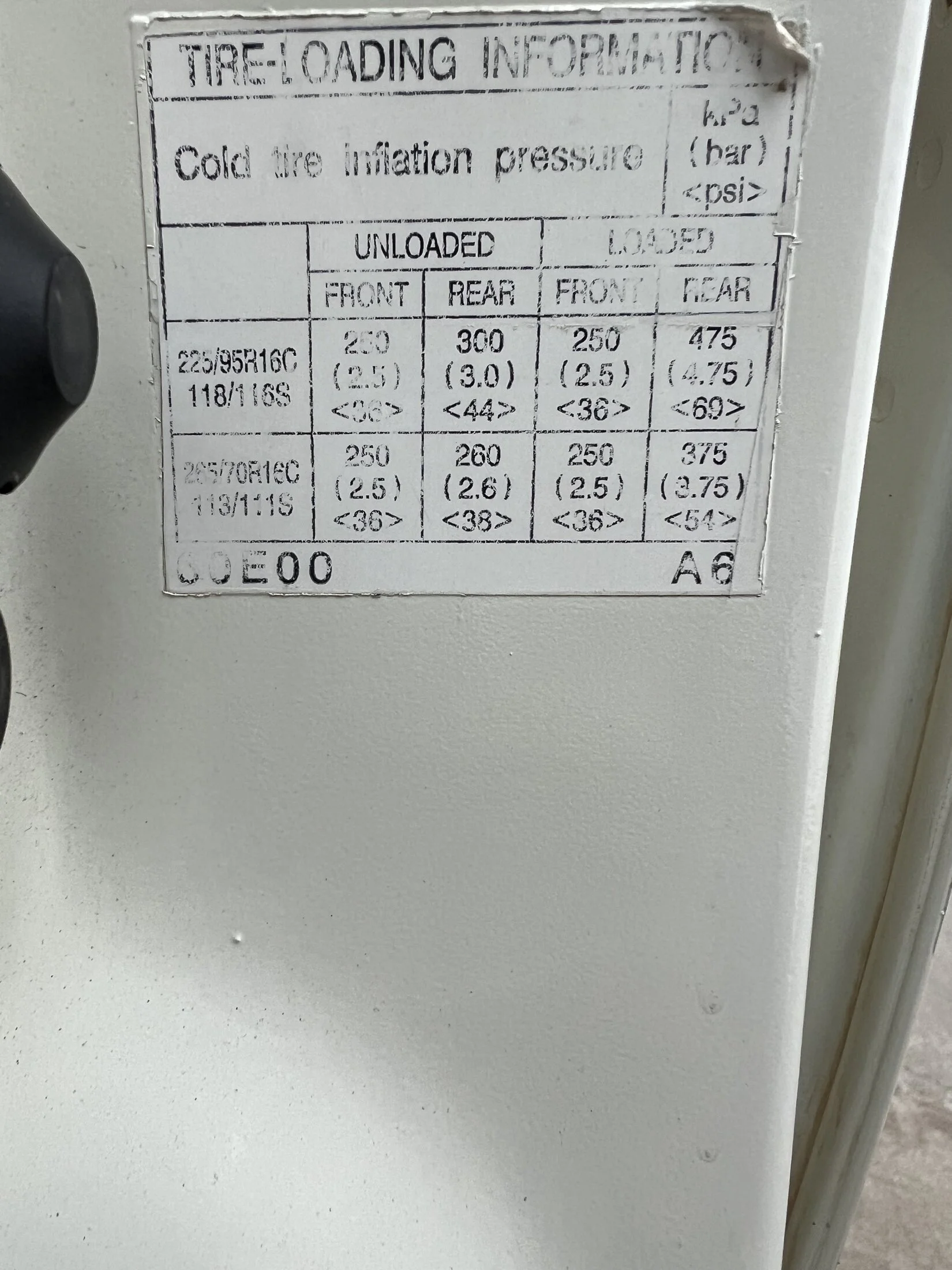

Hello @gaijin, is the RCTIP for LT285/70R17 “E” load range 126/123S BFG KO3’s 42 psi like the KO2’s before them or has it changed? These tires are on a VDJ79, mounted on dynamic wheels. Thanks in advance!
Can you post a pic of the TIP (Tire Information Placard) on your VDJ79 which shows stock tire size and pressure?
TIA
Yessir. Please find attached. If it’s difficult to read the faded print, OEM tire was a 225/95R16C 118/116S. CTIPR Front 36psi, Rear 44psi. My spec was the poverty pack spec from the GCC.
I have to admit I'm a little out of my depth with this one, but...
Let's start with some basics:
All LT285/70R17 tires will have the same RCTIP - makes no difference what Load Range they are, or which tire model, or even which tire manufacturer. So, an LT285/70R17 KO3 is going to have the same RCTIP as an LT285/70R17 KO2.
Based on the GVWR of your VDJ79, which is just a little less than the GVWR of an LC200 (3345 Kg), I feel safe in recommending the same RCTIP for your VDJ79 as for the LC200 - 40psi F/R. This should handle all loads up to the GVWR of your vehicle.
HTH

Thank you sir. That’s good info. I figured they would be the same, but you’re the guru.
