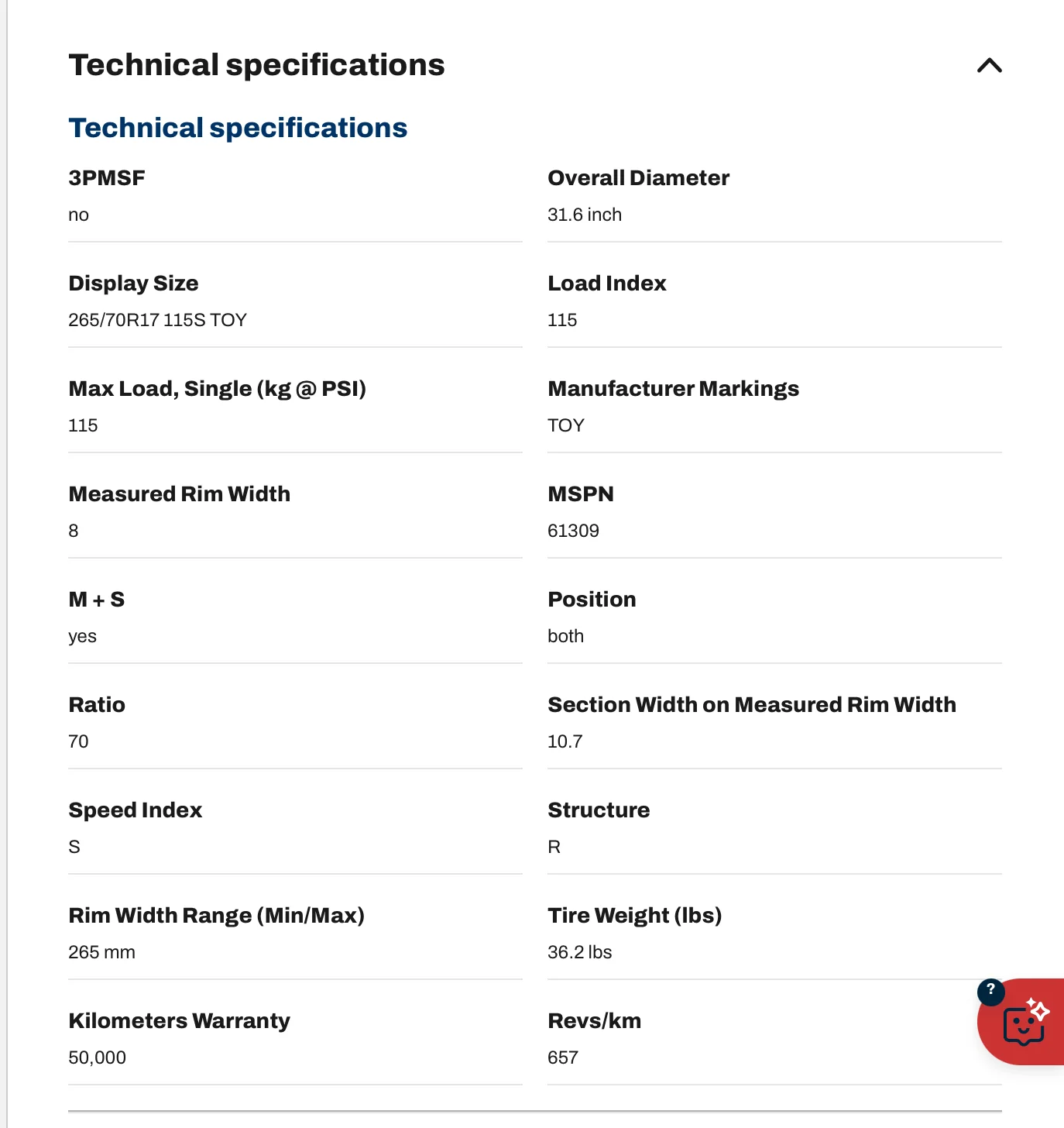

I ran the calculator that @gaijin posted but wasn’t sure if my original OEM tire’s tire type. This is on my 2025 Tacoma, not my LC. The factory tires were BFG Trail-Terrain A/Ts. I don’t believe these are LT tires so I picked “Metric” as the tire type. Any thing else didn’t let me select OEM pressure below 35 and the door sticker says 30 psi.
Here is the data for the OEM tire(Load index of 115):
Here is my calc results for my new E rated K03s.

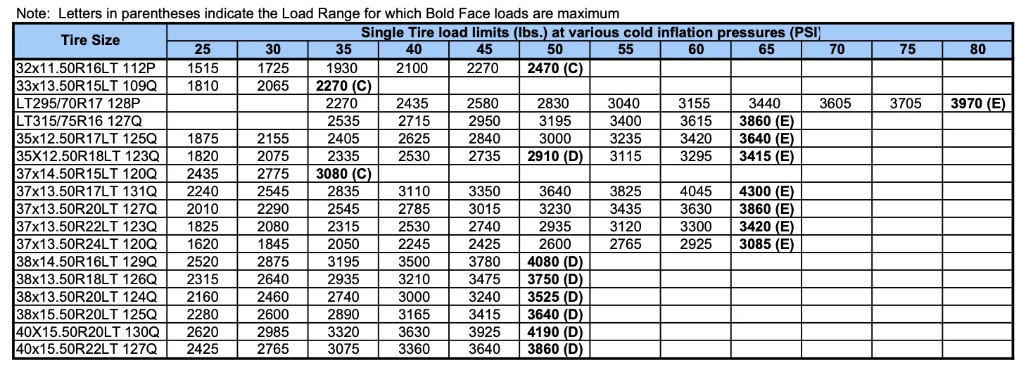

If you take a look at the pressure tables for the floatation sizes, they do indeed list 25 psi and 30 psi and their corresponding rated load. Floatation sized tires can be LT tires too. In fact, some of the Toyo/Nitto tires sold as LT-Metric come with the sticker on the tread that has the equivalent floatation size.
Added:
Added:
My original statement, and your question regarding that statement, as well as my answer to your question... were all addressing LT-Metric tires - not LT Flotation tires which have their own (and different) Load Inflation table.
Any tire labeled as the one in your post should be considered a LT Flotation tire and use the LT Flotation Load Inflation table.

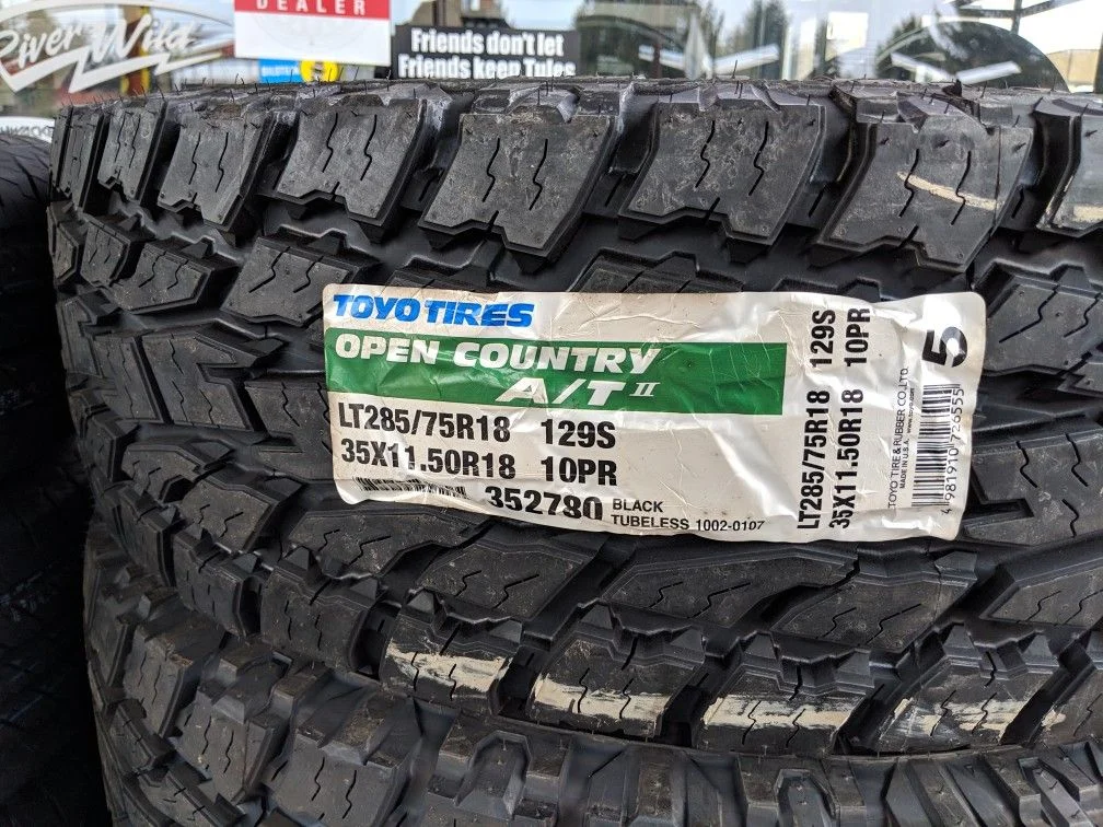

@gaijin Okay, fine. New question, what is the minimum pressure for an LT-Flotation tire such as a 35x11.5R18?
According to the TRA Load/Inflation tables, the minimum allowable pressure for continued use on improved roads is 25psi with a Load Limit of 1765 pounds.
Note that this is not an RCTIP for a LC200 - at 25psi on an LC200 these tires would be dangerously underinflated for use at speed. The RCTIP (minimum allowable pressure for use at speed) for an LC200 would be 37psi.
