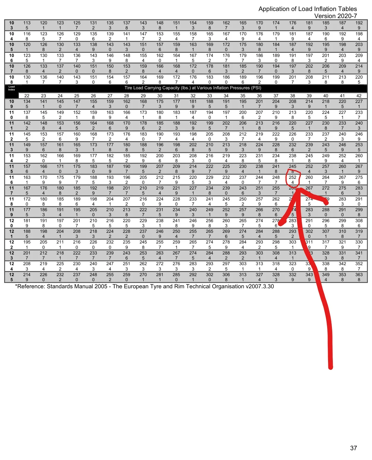

@gaijin looking at these tires. Michelin Defender LTX M/S 2 285/65R18 116T XL BSW. The Toyo tables do not have this size listed, do yours? Thanks in advance!
The Toyo tables (actually an extract published by Toyo of the TRA (Tire and Rim Association) tables) have the info in the "Reinforced Load Inflation Table" on page 37. Follow the 116 Load Index over until you get to the first inflation pressure >2512 lbs - you will find 38psi as the RCTIP.
HTH
Hmmm, my copy (Toyo) has this on pg. 36 preceding 37. Reinforced Load Inflation Table WARNING! Only use for ISO Metric (ETRTO) sizes. DO NOT use this table for P-Metric sizes. I thought I had the latest but guess not.
Thanks for the assistance!
Your tires are not P-Metric, they are ISO-Metric.
FYI, here is a link to the latest extant tables published by Toyo: Guidelines for the Application of Load and Inflation Tables
HTH
Yeah, I stepped in it didn't I?
Not really, now that you know, you can pass on the knowledge.
For the visual learners in the group, here's what Page 37 looks like (highlighted RCTIP):
HTH
