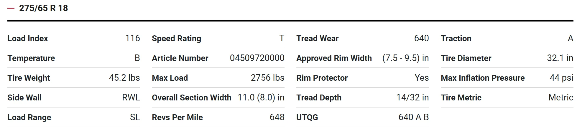

275/65/18 SL General Grabber ATX
Not enough info.
Do you mean this tire?
If so, what vehicle are you putting it on?

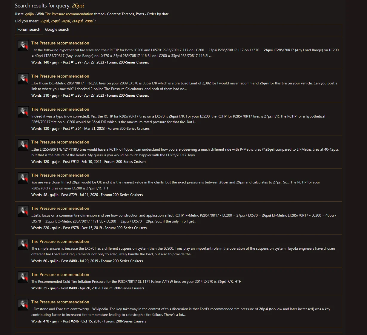

Here’s just a quick snapshot’s of times you’ve recommended a RCTIP lower than the TIP for P285/70R17 I assume you are just avoiding the heart of the conversation at this point, although I’m not sure why.
Not sure how I didn’t answer your question.. but whatevs.
Not sure how you consider, "So my recommendation would never be lower than the 35PSI that is stated on his TIP" as an answer. From your "answer," one can infer that 45psi would be OK. Is that what you meant?
And not a single one of those RCTIP recommendations is for a European version diesel - just as I stated.

19, LC 200 usdm, 5.7 l
Got it!
The RCTIP (Recommended Cold* Tire Inflation Pressure) for those ISO-Metric 275/65R18 116 SL tires on your LC200 is 33psi F/R.
