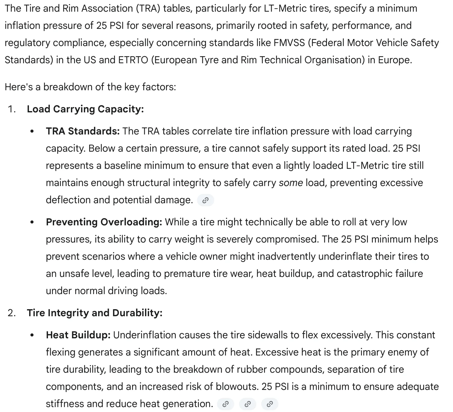

Let's try this:
🔍 Why 35 PSI Is the Minimum in TRA Tables​
  • Structural Integrity: Below 35 psi, LT-Metric tires may not maintain sufficient sidewall stiffness, risking excessive flexing, heat buildup, and potential failure.
  • Load-Carrying Capacity: 35 psi is the lowest pressure at which LT tires can safely carry the minimum rated load for their size. Dropping below this compromises the load index and violates FMVSS No. 110 compliance.
  • Industry Consensus: TRA, ETRTO, and JATMA harmonize standards to ensure global consistency. 35 psi is the agreed-upon baseline for LT-Metric tires across these organizations.
💥 Was a Destructive Test Performed?​
Yes—though not publicly detailed in the tables, destructive testing is a cornerstone of tire validation. Here's how it typically works:
  • Step 1: Load vs. Pressure Testing Tires are inflated to various pressures and subjected to increasing loads until deformation or failure occurs. This helps define the safe operating envelope.
  • Step 2: High-Speed and Endurance Tests Tires are run at high speeds under load to simulate real-world stress. Failures at low pressures (e.g., below 35 psi) often involve sidewall collapse or tread separation.
  • Step 3: Regulatory Compliance FMVSS No. 109 and No. 110 require tires to pass endurance and high-speed tests at specified pressures. These tests indirectly validate the lower pressure limit.
While the TRA Load Inflation Tables don’t cite specific destructive test data, the 35 psi floor is a product of these rigorous evaluations. It’s not just a conservative guess—it’s a line drawn from empirical testing and safety margins.

No, that doesn't work out. I've used AI enough to know that I can tailor the prompts to get the answers I want. I even checked the FMVSS sources for minimum pressure test and there's nothing relevant there. No need to continue on....

As we should all be aware, AI output is only as good as its input. That is why it is important to evaluate the output carefully before assigning any degree of confidence to the content.
In the case of your AI output, it is not difficult to see that the content is based on a flawed input based on the very first sentence:
"The Tire and Rim Association (TRA) tables, particularly for LT-Metric tires, specify a minimum inflation pressure of 25 PSI for several reasons..."
That is an untrue statement. The TRA tables for LT-Metric tires specify a minimum pressure of 35 PSI.
So I agree with your concession, "No need to carry on..."

Let's try this:
