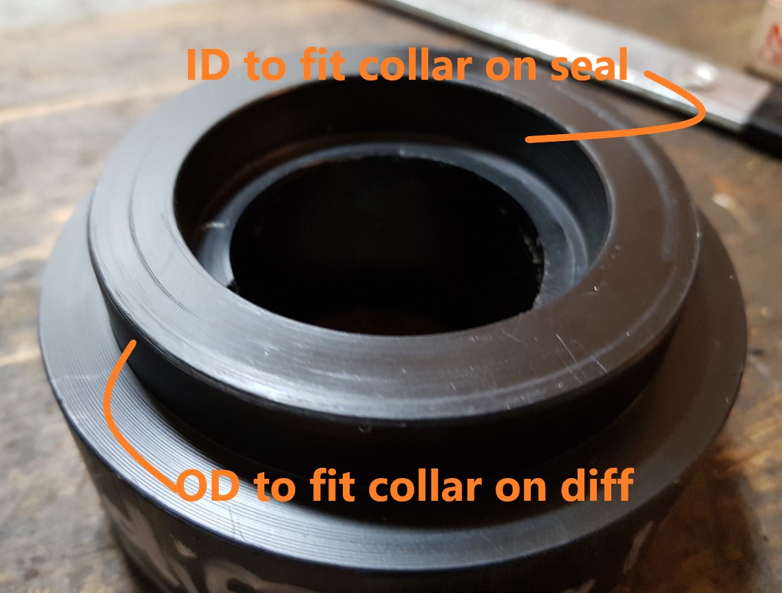

FYI, I used a simple turned piece of plastic to install the seals:

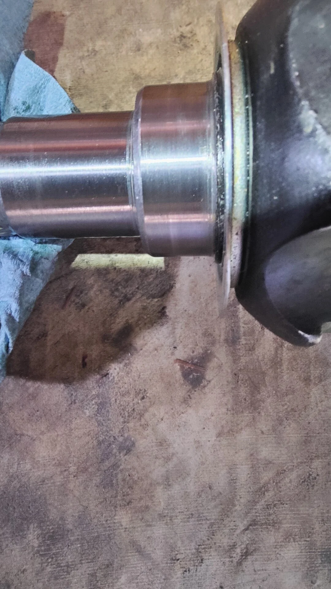

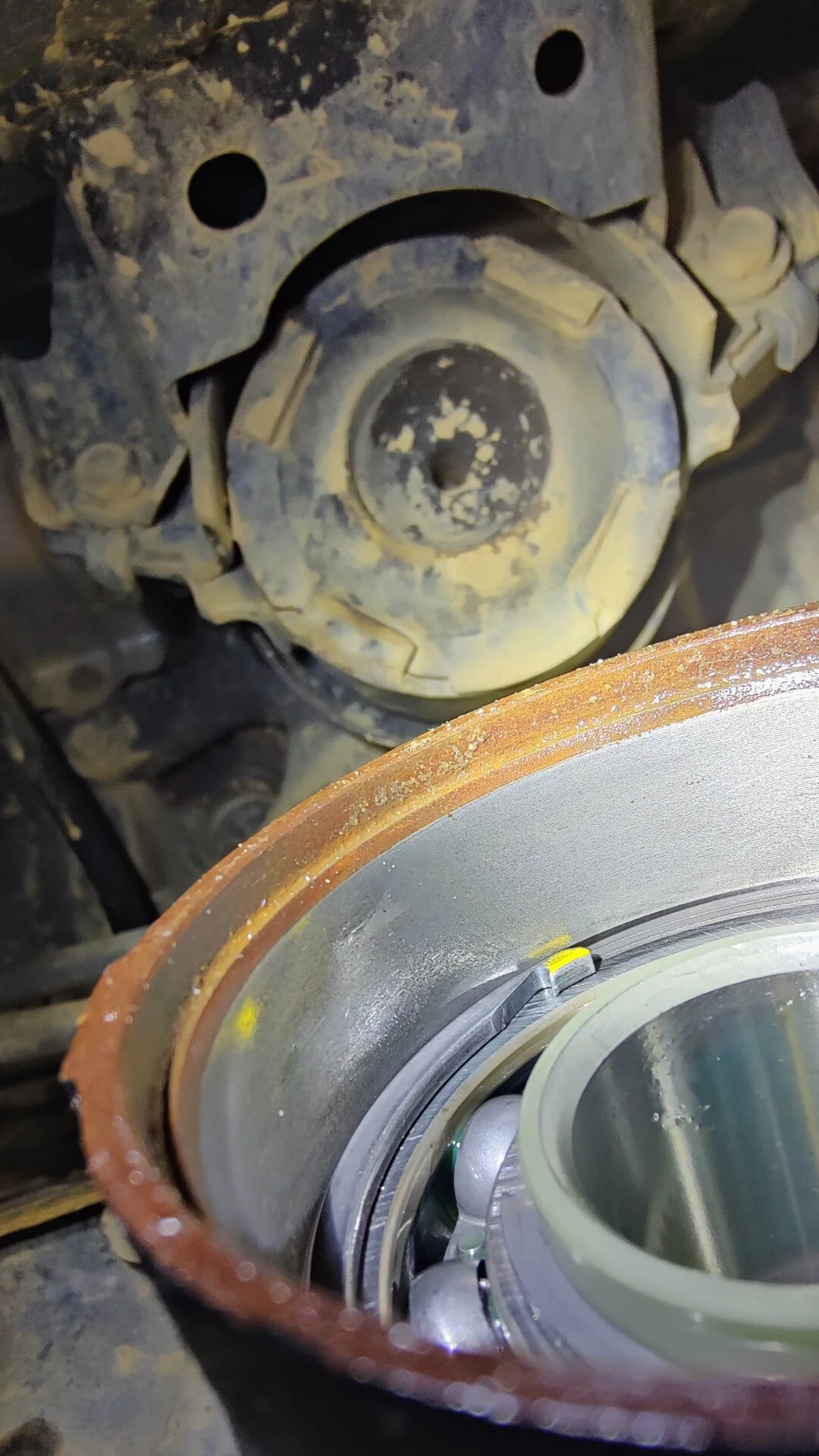

Here's two pictures of the axle. Surface looks good to me. When I initially pulled the axle, the seal looked like it was leaking from the bottom. However it's unclear if that was just due to gravity (I wiped the bottom prior to taking the picture). Pulled the seal and the inner spring was in tact. I will take more pictures when the fluid has drained

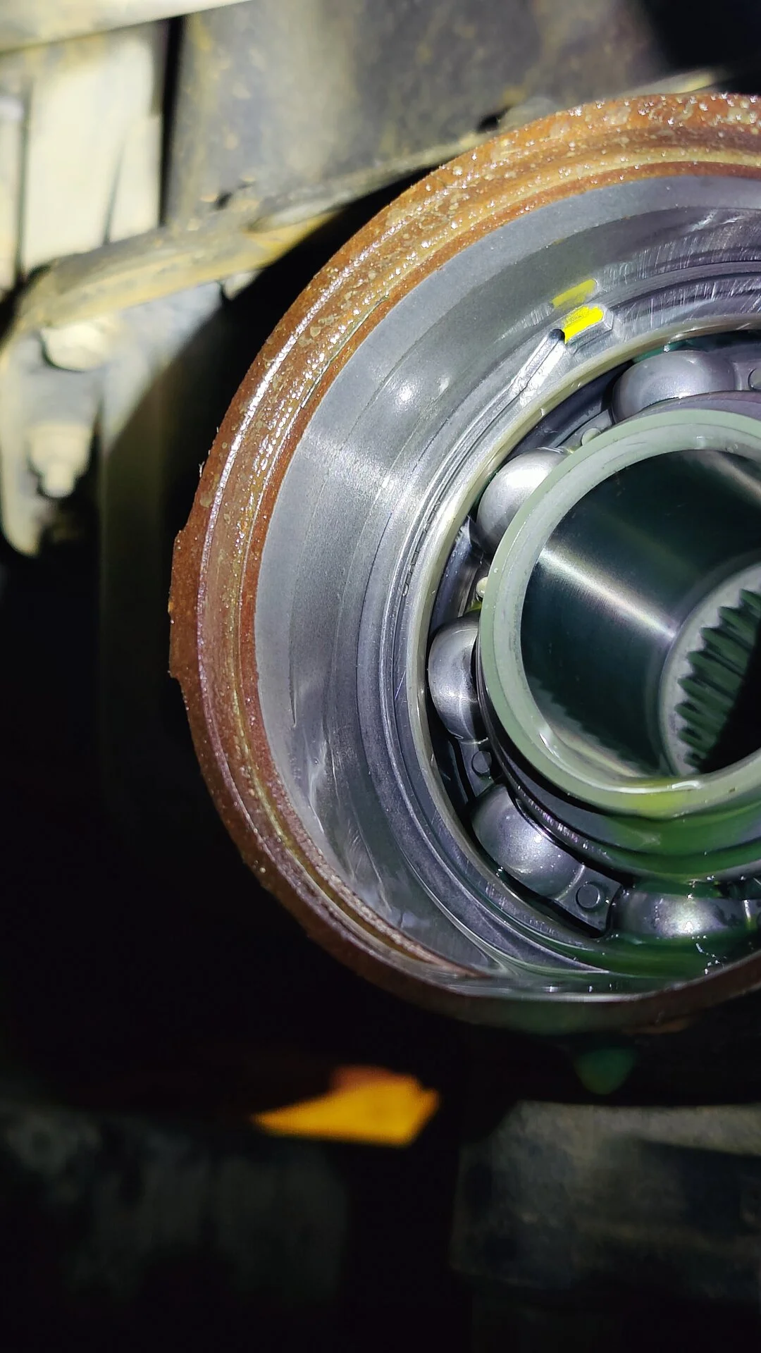

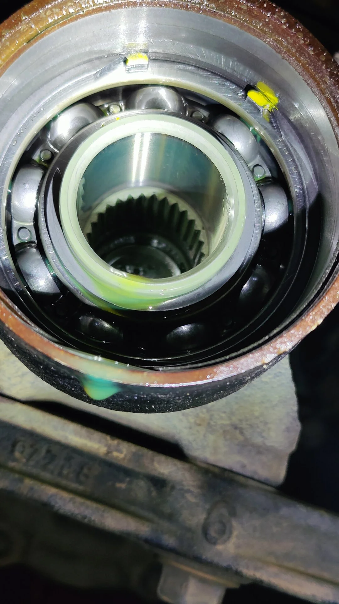

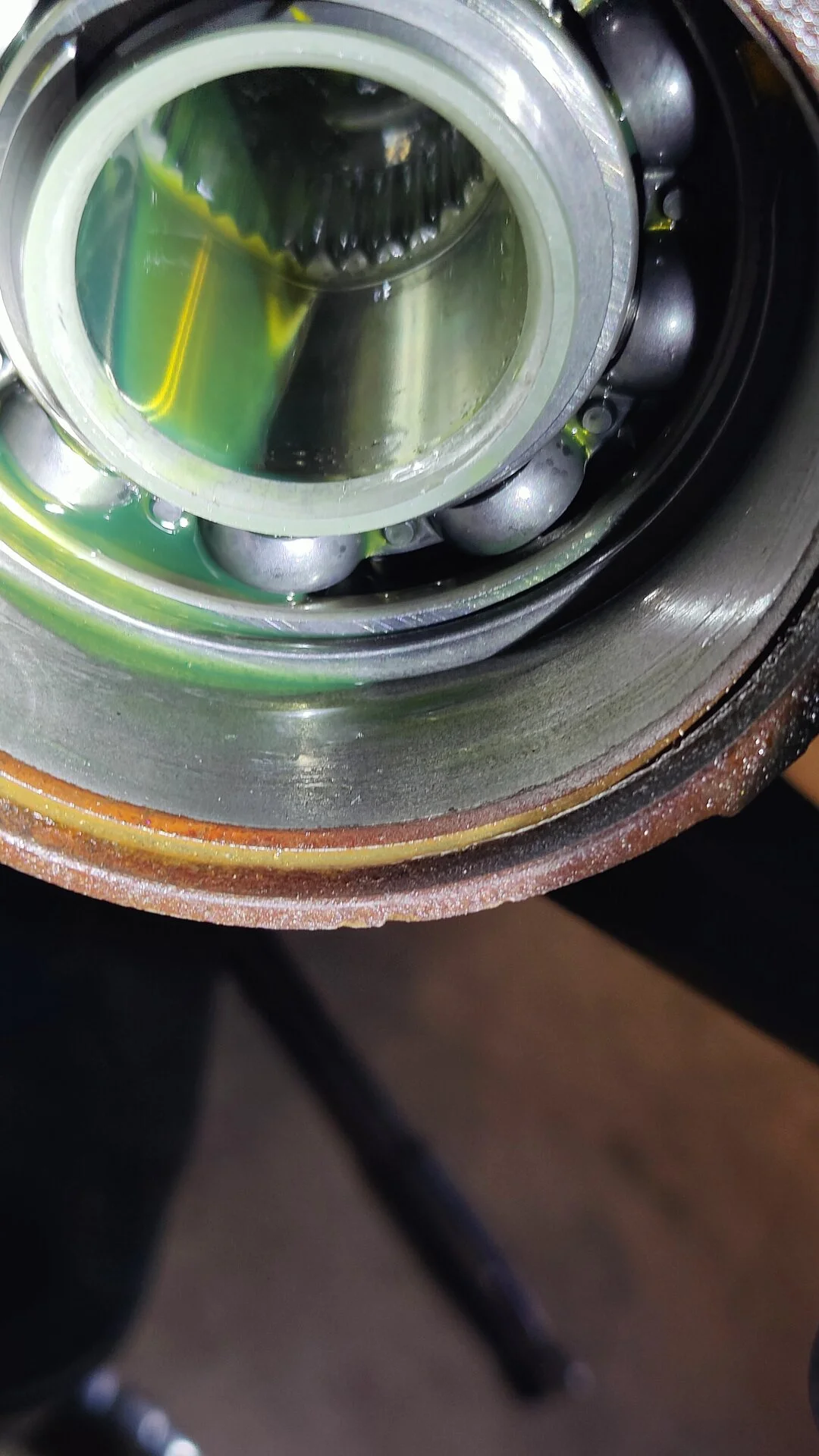

Added pictures of diff tube. Ran finger across surface. No noticeable irregularities in the surface.
Any thoughts?
That bore looks pretty good. Is there any raised edge (step) at the bore to corroded outside?

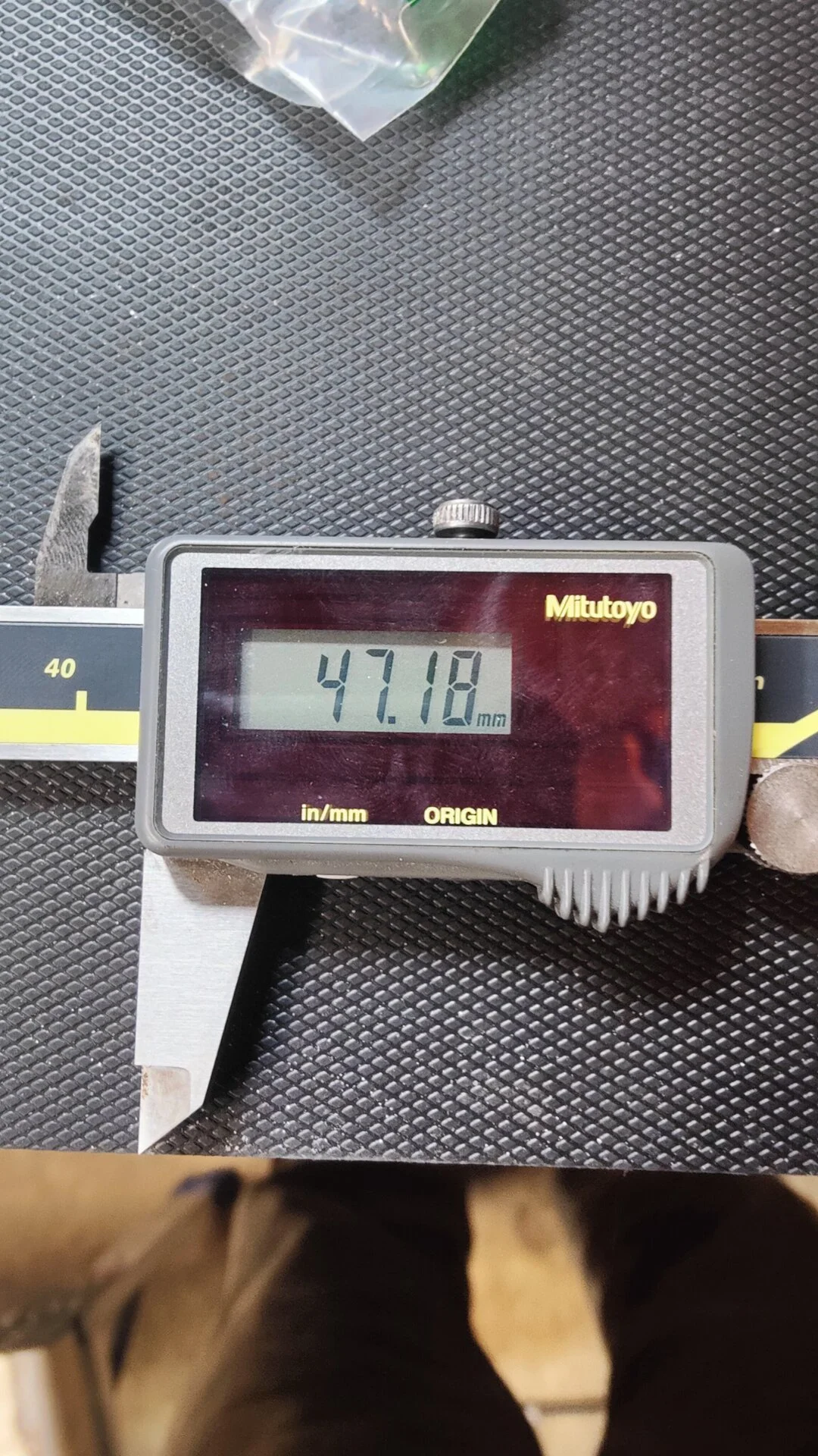

The axle looks pretty good. According to SKF, that seal spec is for a 1.850" (47mm) axle. Are you able to accurately measure the OD of the shaft where the seal sits?
Didn't feel any kind of edge at the bore. Checked multiple times.
I've got a pair of calipers that I'll use to measure the shaft in the morning.

Thanks for the input. I bought these directly from toyota. They look exactly like a new OEM axle should, including the toyota sticker. As noted above, I checked the diameter of the axle and it appears to be within spec (I don't know the tolerance so I can't confirm).
