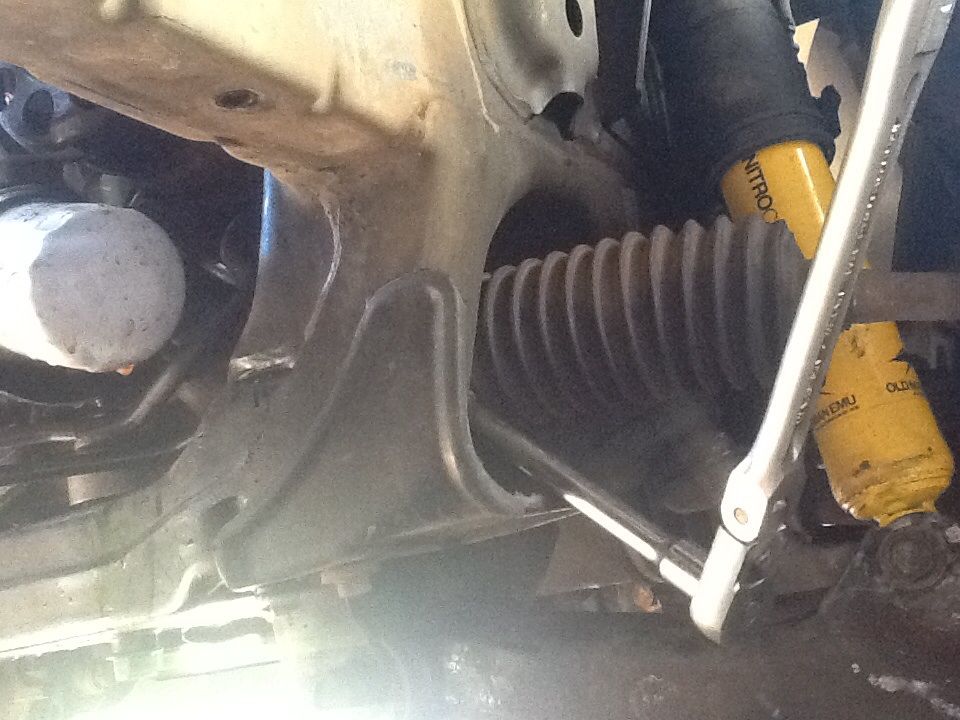

Hey guys, new here. Got 2000 lx... Just did my timing belt. Was super easy considering what most people say, I replaced everything I could. Seals, tensioner, idlers, pump etc... Followed this thread for advice. Was very helpful... Seemed the OP had tough time with the two bolts near the oil filter... Here is the easy way to get at the lower one. I have lots of longer extensions for bell housing bolts and they proved there worth again... Turn wheel driver and insert extension through lower control arm and it's super easy... Practically finds the bolt by itself...
