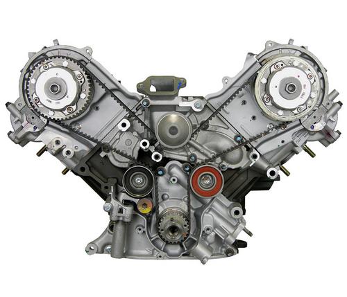

I just finished up the 90k on my '06 and wanted to chime in on the VVTi version of the engine. As scottm said earlier, there are no critical differences to the job on a VVTi engine. There are two points I found to be a bit different:
First, you can't change the cam seals on the VVTi engine during this service. Unlike the standard version, the '06+ camshafts have the VVTi actuators mounted in front of the cams and can't be removed without removal of the cams themselves. From what I've read, trying to dismantle the actuator from the outside will destroy it. You can see the actuators here in this shot of the VVTi engine. They have timing marks just like the normal ones: they just look different and can't be removed.
http://images.oreillyauto.com/parts/img/large/ptq/atk853a-1.jpg
Second, the VVTi cam / crank alignment was a little different than what I've read for the standard engine. It sounded like aligning the standard engine crank to TDC would also align the cam marks. Aligning the cam marks on the VVTi engine left the crank at about 10° before TDC. I would guess this is to give the VVTi more room to play with. I also read (after the job of course) that once you have the engine aligned, you're supposed to mark the crank and belts, then rotate the crank forward (clockwise) to about 50° past TDC (there's a small nub on the engine designating is point). This supposedly puts the cams in a neutral position allowing easier mounting of the belt. The cams at TDC have a good deal of spring tension from the valve train on them, making fine adjustments a pain. I'll try the 50° past TDC on my next run.
Otherwise it all went just like Scottm and Spressomon's post show. My thanks to both of you for these excellent instructions. :clap:

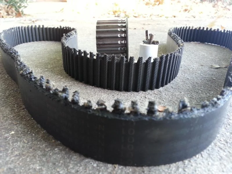

guy to take this job on. Bearings went out in my fan bracket and while removing the parts noticed a problem with my TB. I found what looked like roller bearings wedged in the crank pulley. i am replacing everything with new parts , but where did these come from?
Wow - my first reaction to seeing your timing belt damage is "Carnage!" However, its funny all the discussions about evaluating any fraying or superficial hairline cracks when yours appears to have been doing its job even after being severely compromised. I did mine in October and at 128k, my timing belt looked pristine. I will be posting some pictures and comments in this thread soon. This thread and the FSM made the job straightforward.
I agree with the Wow, what the heck? Could they have come from the fan bracket bearings? I'd sure like to know. Is this the first timing belt change? What mileage?
I didn't change my fan bracket bearings, explained my reasoning in my post earlier, but it is a gamble for sure.
