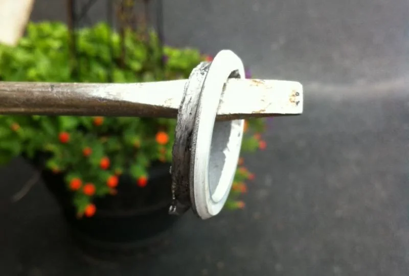

Ok -- broken piece is out
Posting here just to give you an idea... Some heat and patience eventually got this out.
Below is a broken piece from the housing.

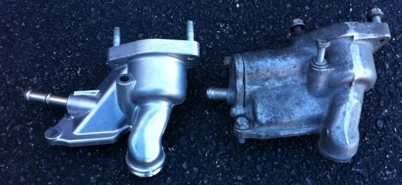

A redesign or a wrong part
Decided to take off from work today to get my truck done once for all.
I picked up the part this morning and was surprised of a design difference. Makes me wonder if it was a wrong part that was in my truck or a redesign. I think the latter.
Additional note:
When you order new casting, please be sure to order middle bolt for it. The smaller casting requires smaller bolt.
FYI -- The casting fits perfectly. No leak and all. I ran the truck for 30 minutes and everything looks good so far.

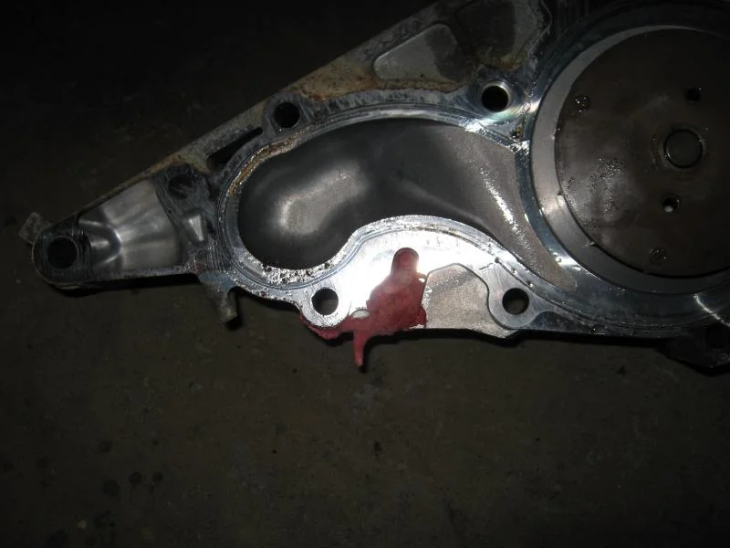

Kind of a bummer the Permatex that squeezed out around the surfaces looks exactly like Toyota red coolant, I may have to clean that off some day.

Also if you're considering not changing the water pump.............this one was nine years old w/ 105k bleeding from the weep hole for the seal.
