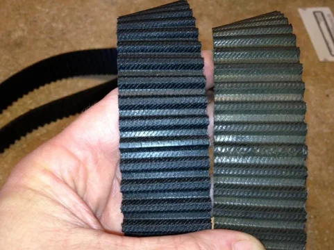

Edit new/old belts:

I changed my timing belt at 186k after 15 years.
It was the original belt.
It had lots of cracks in the rubber and the teeth were getting worn.
But it did not break, or cause any kind of problems.
I'll try to post some pictures of the old belt later.
The old belt looks pretty bad, but it never broke and the truck always ran fine.
