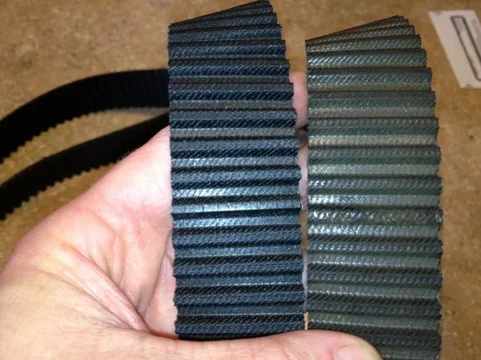

I am a service advisor for Toyota I have said before in threads I have never seen a V8 timing belt break. I sell 3 or 4 a week and always check the condition of the belts I change. Some look new some look worn out and starting to crack. Don't have any clue as to why. As some have stated waterpumps go first, have that checked and do both if it's weeping. I would not worry about going 150k before doing it but as I tell my customers you gotta do it eventually might as well do it now while I have my monthly special. $369.00 plus tax and shop fees

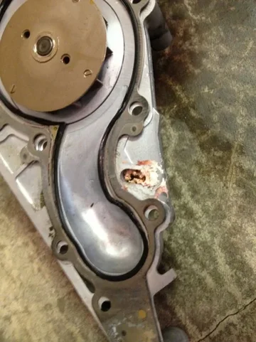

Call me crazy, but I'll change the belt when the water pump weeps. And hope I don't weep.

If you spun it enough you could eventually see the logo. The condition of the outside of the belt isn't really an indication, it's the inside. And to really tell you need the belt off where you can flex it backward and look for cracks. But by then you would only be $60 away from a new belt.

But as others have said, the water pump lasts a long time but will likely go before the belt. It does have a weep hole. The purpose of the hole is to allow a small amount of water that made it past the primary seal and into the bearing area to get out without allowing the bearing to become saturated and fail. The problem is that the coolant can crystallize in the hole and block drainage and you'd never know because its behind the covers.
Interesting. Every other car I owned leaked enough coolant out of the weep hole that I had coolant loss or could certainly see the steam in the winter. If the LC isn't going to indicate, then I might have to rethink my strategy :-/
