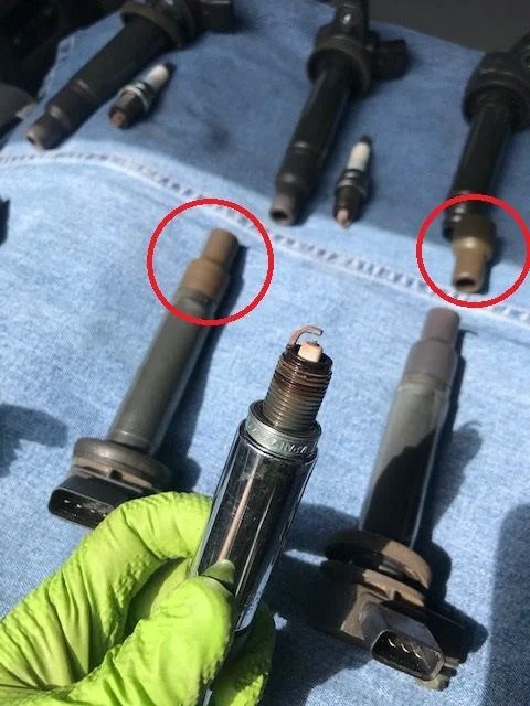

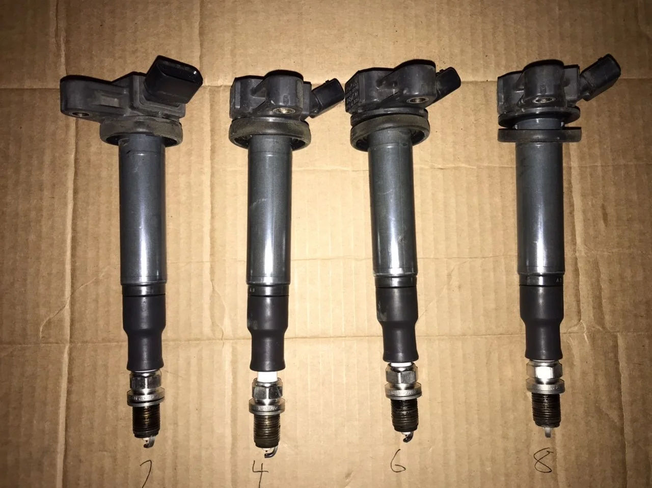

Thanks all. Finally came out after some wrestling and a bit of penetrating oil. Replaced the two brown boots in the pic and put em back together.

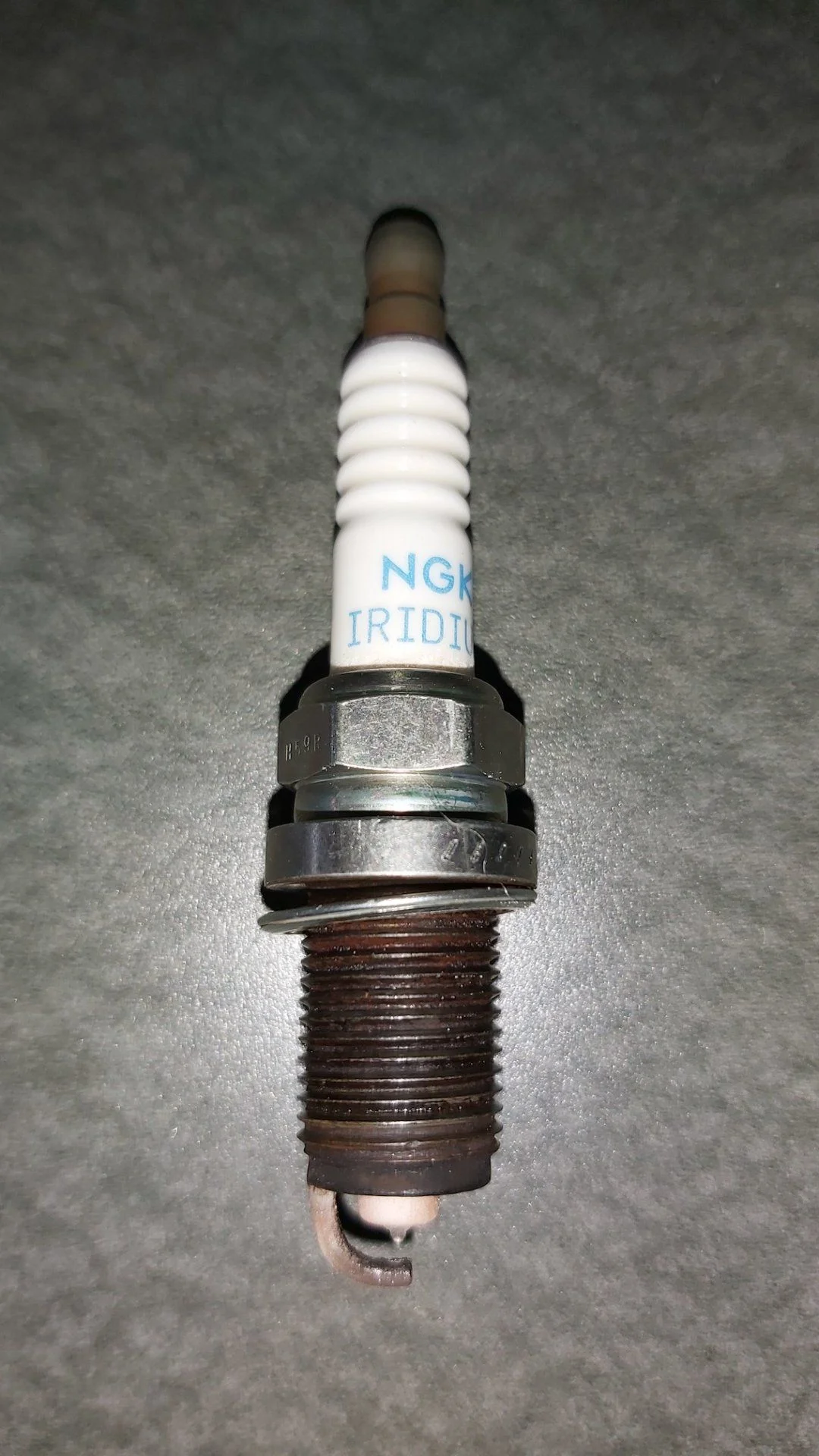

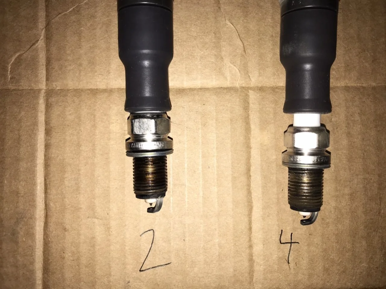

Spark plugs were the original ones manufactured in Japan. The appearance of the spark plug suggests normal condition I guess??

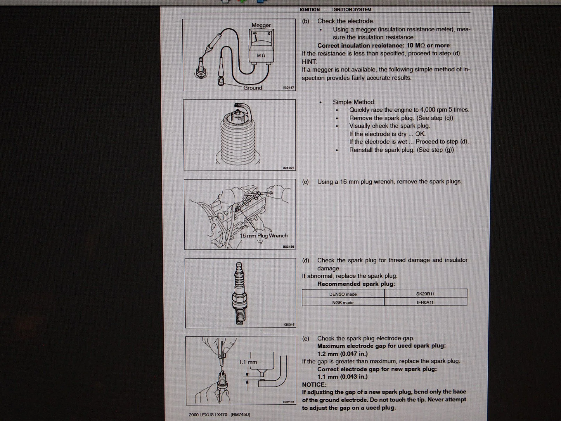

Looks like a good burning plug/cylinder. Gap is key. But even if under 1.2mm gap limite. I prefer not reusing. Unless crush washer not fully collapsed or replaced.

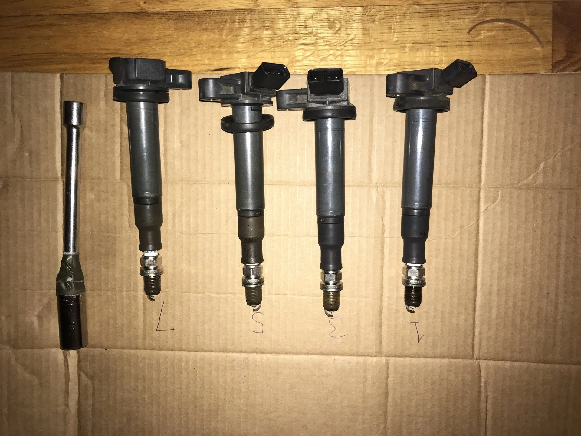

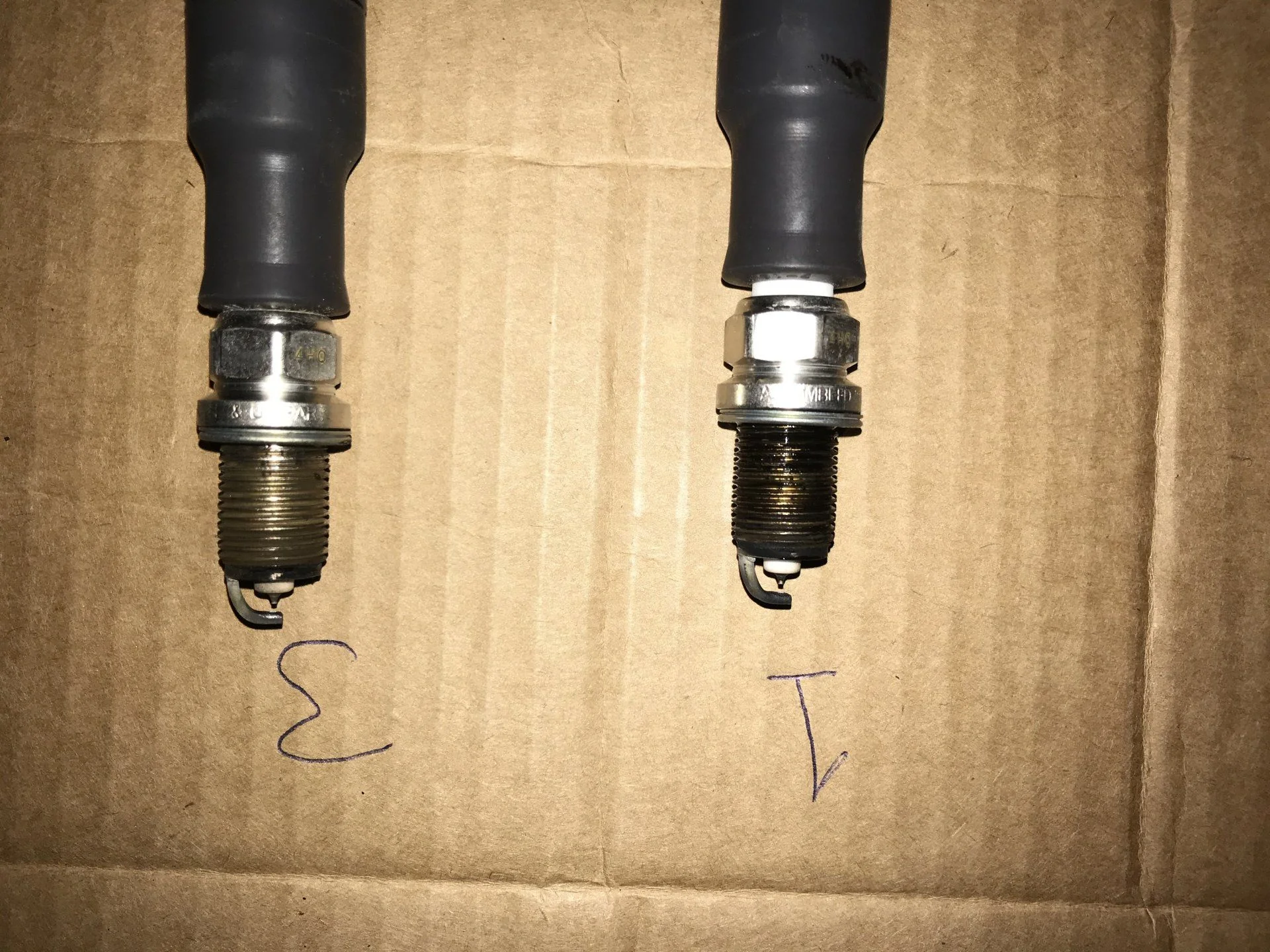

'04 with 147k miles. According to Toyota records, PO had dealer replace plugs ~30k miles ago. I checked them a few weeks and they seemed pretty tight, but I noticed some of the coil boots looked TIRED, so ordered a Denso boot set and new TT plugs and one spare Denso coil for the glovebox.

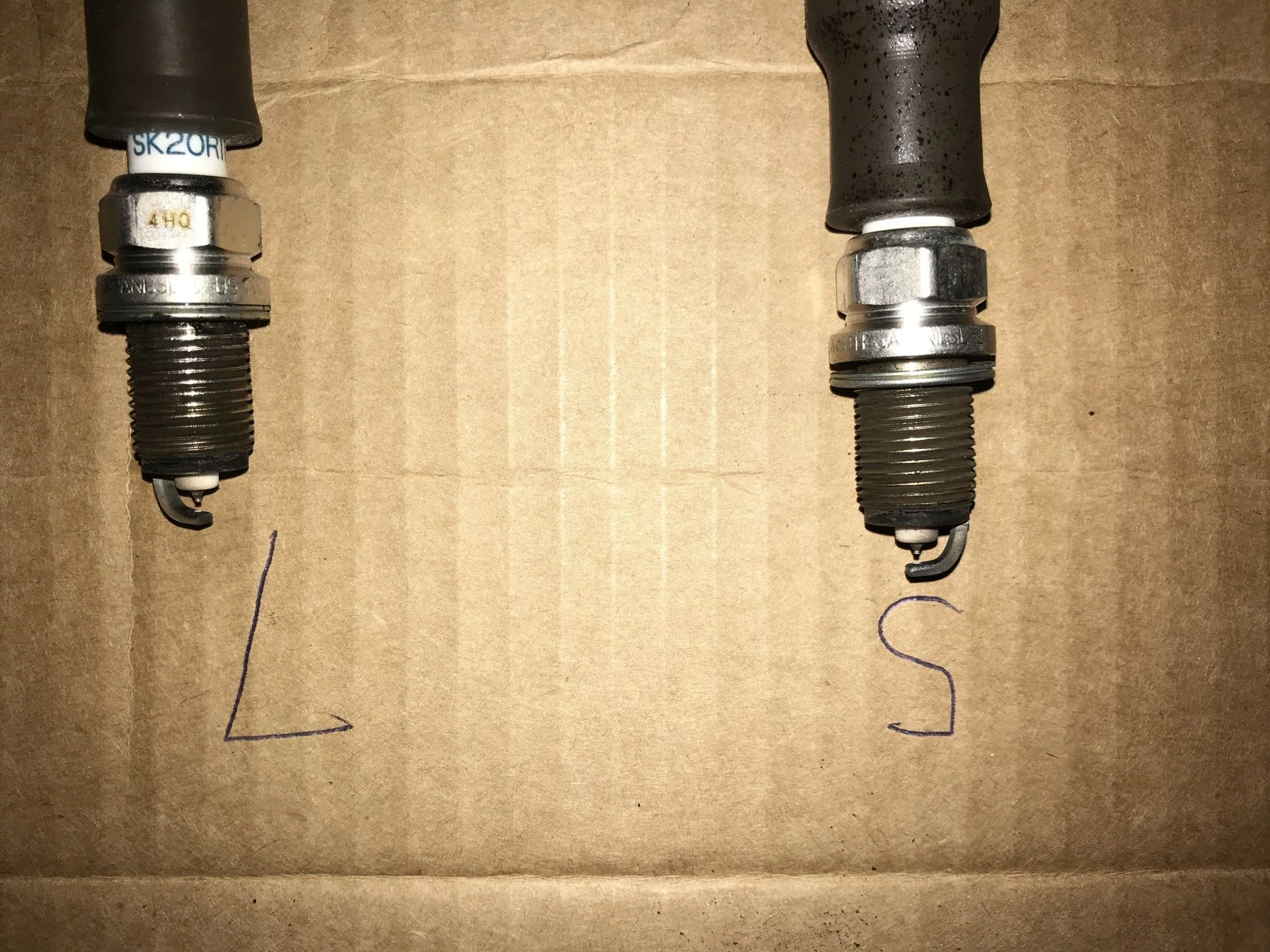

Checked the gap of all plugs before install, and all were just a _hair_ too tight to get my 1mm feeler gauge into, so I opened them all up just a bit.
Installed them tonight. Realized that with the wobble head extension I had on my plug socket I wasn't going to be able to torque them properly, so just turned them all finger tight and then probably halfway between 1/4 and 1/2 turn (per Denso instructions).
Put new coil boots on (going to post in "When to replace ignition coils" thread too), but could NOT get the new springs to go in, and couldn't find anything on line about getting this style of spring to seat, so put the old spring back in (thankfully pretty easy). Used a very small amount of dielectric grease on the inside edges of both boots per the Denso instructions (the kit came with some).
Only did plugs 1-7 tonight--will do the even numbers later this week. #1 had some oily looking threads and was probably a bit loose. All plugs looked pretty good otherwise, but the #5 and #7 boots were clearly getting old, and #7 tore while trying to twist it off. Must be a bit warmer at the back of the engine, causing the boots to age more quickly.
Check and adjust gap on new plugs, always. I was finding 1 in 4 need gap adjusted. But lately they've been spot on. But always check ;)
same here...found 1 of 8 replacement DENSO SK20R11 plugs was clearly under 1 mm gap. Others were a consistent 1.1 mm. Also found most of my installed plugs were no longer snug. Will check more often based on this thread- thanks!

Well, did the passenger side tonight. Some of the plugs were none too tight, and have oily deposits on the threads, so even relatively recently (30 miles) dealer-installed plugs are worth checking/replacing.
I used my torque wrench tonight, set to 16 ft/lb, which seems like a nice middle-of-the-road setting based on what I've read in here. That was about 1/2 turn on each plug past finger tight. So I might go back and check one or two of the more accessible plugs on the DS and then turn the rest a bit further depending on what I find on the ones I check.
