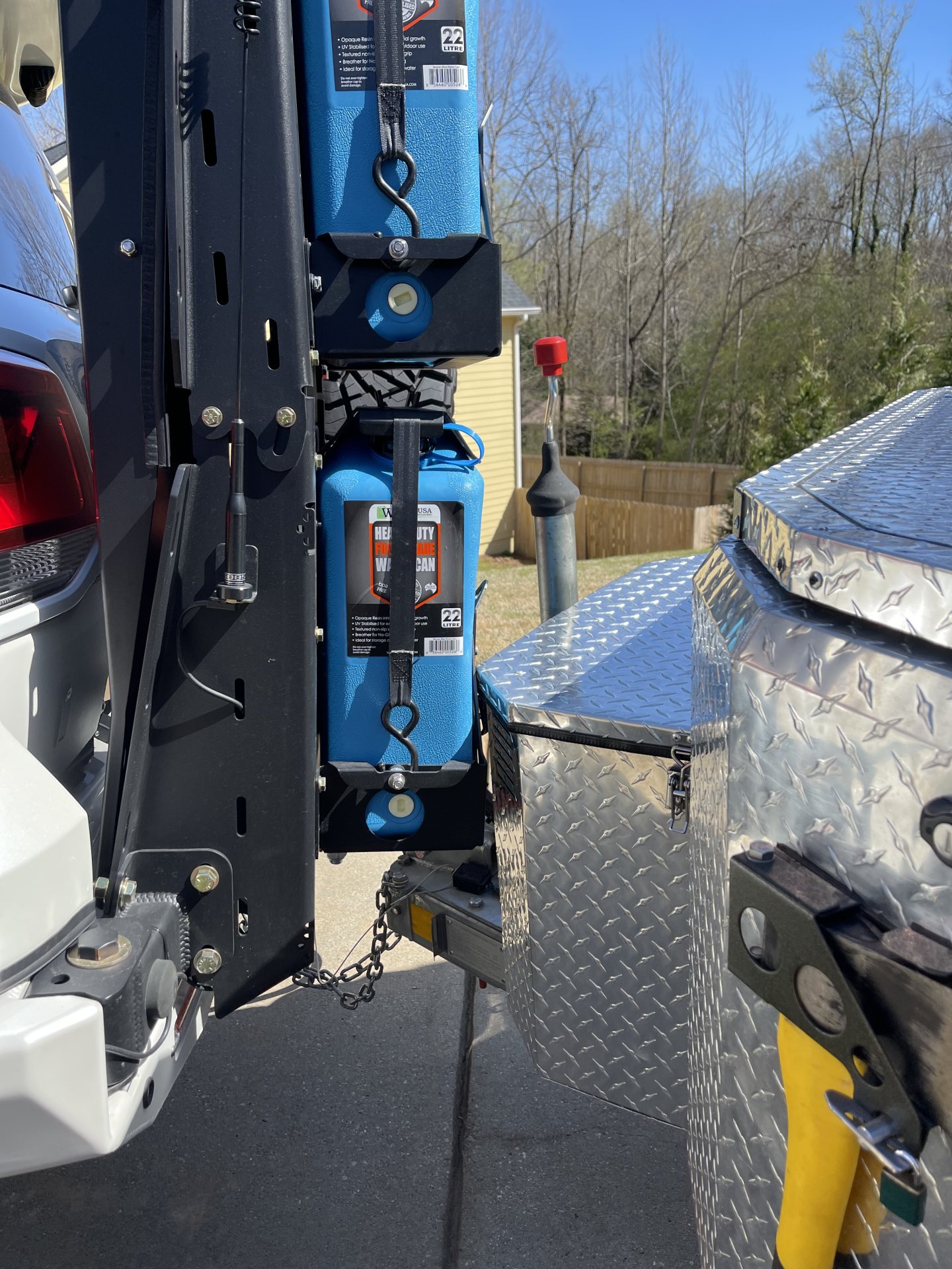

So, I am about ready to hook up Double axle 7x12 cargo trailer…. Overall trailer weight estimated at 3000 lbs … and sure enough, the spare tire interferes with the trailer jack and it looks like I would have to be very careful with anything close to jackknifing when backing up and what not.
No WDH…..
Anybody use a hitch extender to gain clearance?
Thinking a 14 inch extender.
Will call Slee Monday, but looking forward info now….

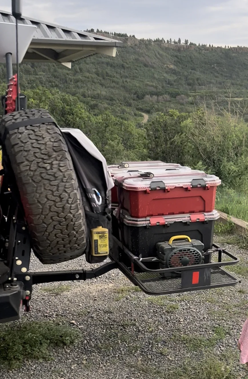

I use an 18” extender for my hitch basket. It gives me enough clearance to open swingouts, but it jacks up with my tongue weight (cantilevering effect).

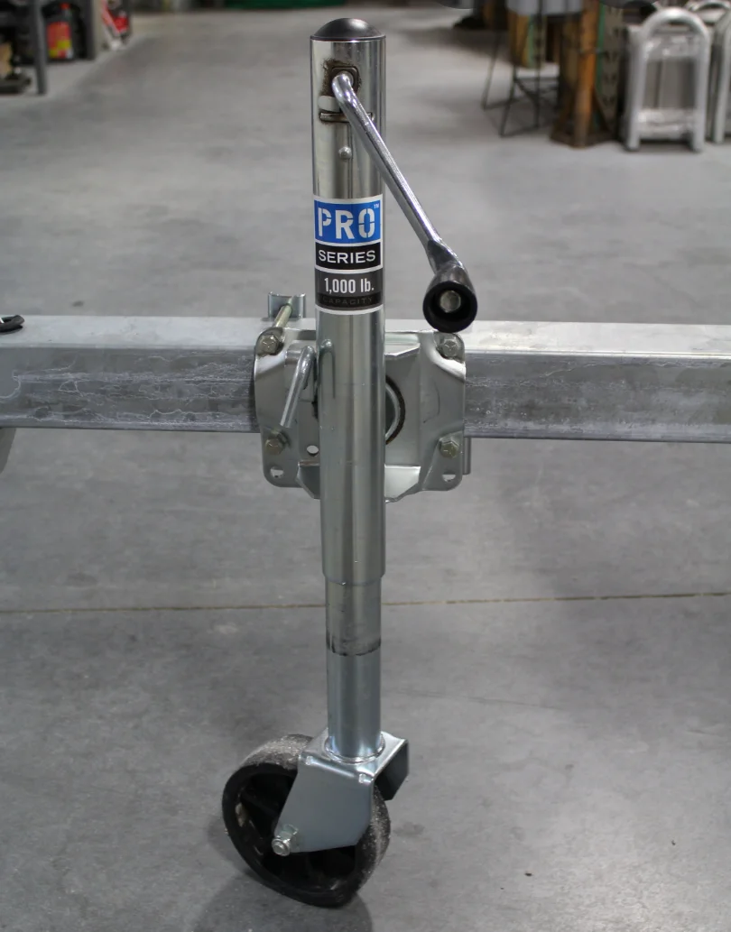

2) Change the tongue jack on the trailer. There's folding types that mount to the frame rails and will pivot up. Avoiding clearance issues.

Thanks for all the replies. This is not as simple as I thought it might be.
Also, I neglected to mention that I have an extra tank in back. 35 gallons or so.
I will call Slee and see if they have comment.
I also visit with Maxey….. might be be better to extend/reinforce the trailer tongue…. See if they can also make room for a propane tank.

@TeCKis300 This is what I did with my small camper. The power jack that came on it from the factory was just in the way with my dissent rear bumper tire swingout, so I installed a manual crank jack that folds for travel.

Tractor supply sells a Jack that is removable. Twist a level and pull it out of the base, toss it in the trailer. Picture when I get outside.
